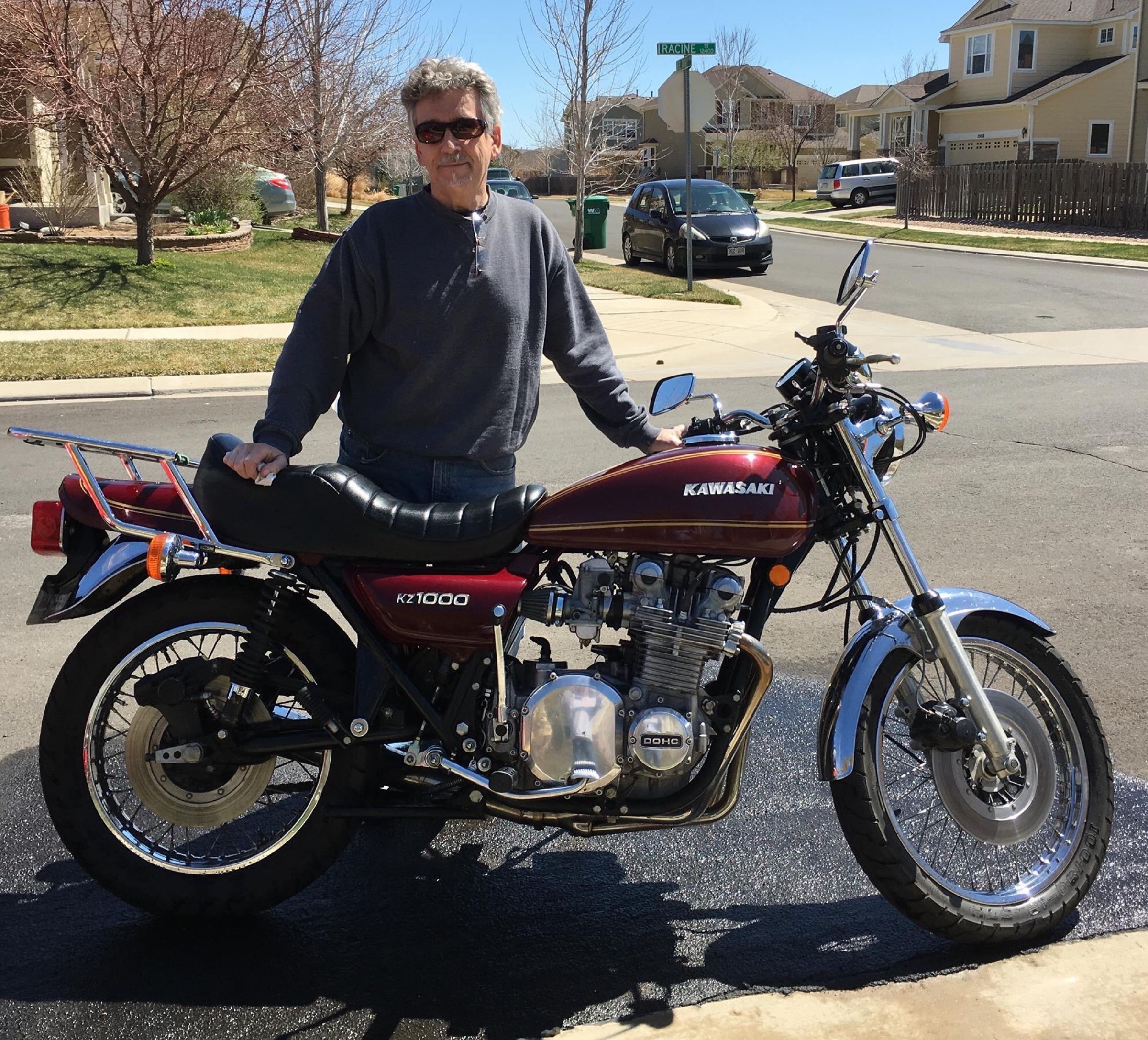

Keep in mind that when setting the cams and chain up.... per the manual, you are pulling the "slack" chain away from the crankshaft sprocket and towards the head. So the exhaust cam sprocket is rotating a little further towards the intake cam sprocket.
My head is milled about .012" and with a +42,000 mile cam chain and old sprockets, the exhaust cam "carrot" is about where yours is now.
However, with my slightly lower drive chain sprocket ratio, the 10.25:1 1075cc kit, Denco headers, stock but correctly jetted 26mm carbs... well, trust me, ... the bike still hauls ass like it should, blowing all my buddy's modern bikes in the weeds.... much to their total disgust! LOL

Beautiful kz!
