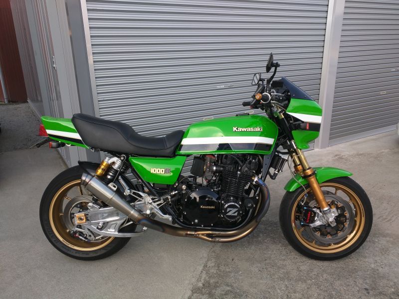

This might give you guys a hint what im looking for. I like The aggresive look with The wide rear wheel.

I fixed your picture. Next time click the insert tab

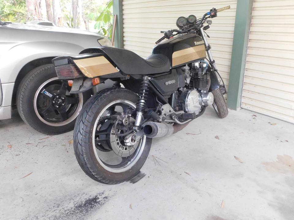

You can use shocks that fit the GS1100E, they have a clevis on the bottom instead of the eye. Here is one fitted to my KZ900.

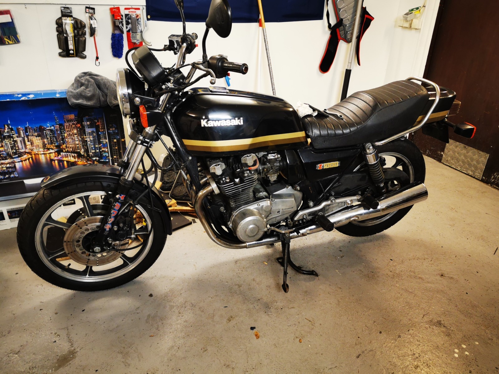

This is my bike. What you say about paint laser blue or almondwhite?

that looks like a clean original bike. any suspension can be made to fit. Depends on how much chopping you want to do. The gs1000r was a race bike and probably not what your are talking about.

Hi Escobar, I am just popping back up here, have been neglecting my bike for a long time but just getting into it now. I have a GPZ1100zx swingarm, with wheels from the same model. So up to a 140 rear tyre which looks great but I prefer the 130 .
if you want the really fat rear you will want to convert the front to match,.
You don't see many black ones, I say go black again, maybe do something different with stripes.
