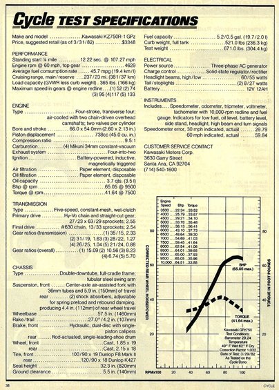

Horsepower isn't a simple thing on these bikes. What worked on the old Chevy's doesn't necessarily work on these, because on those old cars they had ports like plumbing elbows, compression designed for knock-o-special gas, and cams favoring low end torque.
to extract real power from your bike, lumpier cams, plus the 810 kit with compression increase is your best power-adder, but expect to move to the premium pump. Also modifying the backer plate behind the magnetic pickup coil to get a few more degrees of timing is helpful. I remember a period build, when the magazines took a stock KZ550, put on the pipe, pods, and jetting, and promptly lost 2 hp on the dyno, but helped the 1/4 mile ET because of weight reduction. When they put in the Champion Moriwaki cams and 610cc pistons, they got a massive increase - 63 hp on the dyno fron 44hp.
Here's a copy of the original dyno-test on this bike, kind of shows you the powerband -
