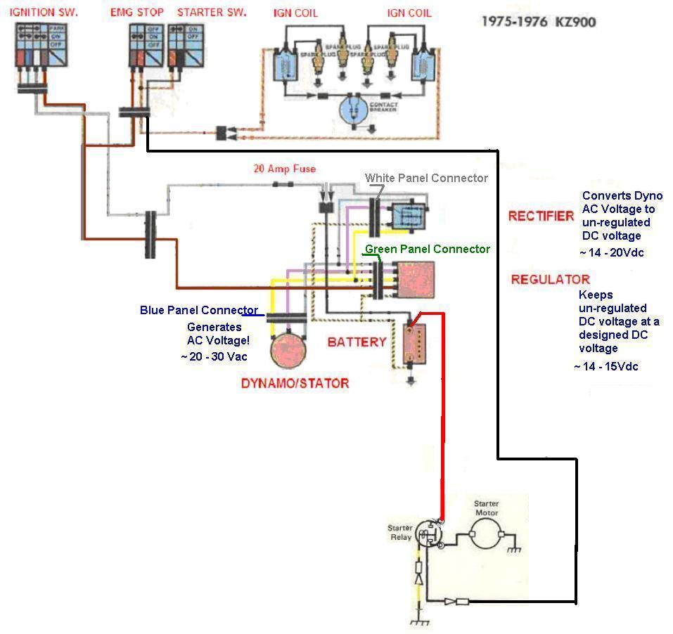

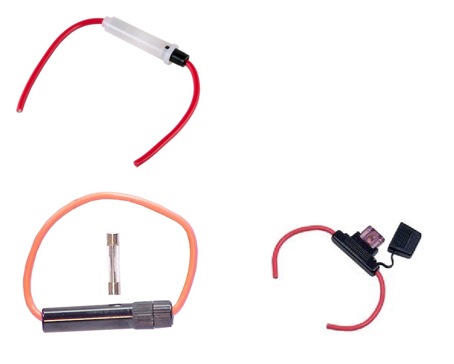

Not one fuse.... :blink: :huh: :dry:
I can't believe anyone re-wiring a harness would not include a main fuse somewhere... :S
Possibly it has tape over it or some other wrapping, look for an in-line fuse it has to be there somewhere... Pending when this harness was fabbed, in-line glass fuse holder....
And yes, possibly the PO was just a total numbnuts and didn't include one....
Follow this bar bones wiring off the battery for the main fuse, possibly yours resides somewhere in line as well...
