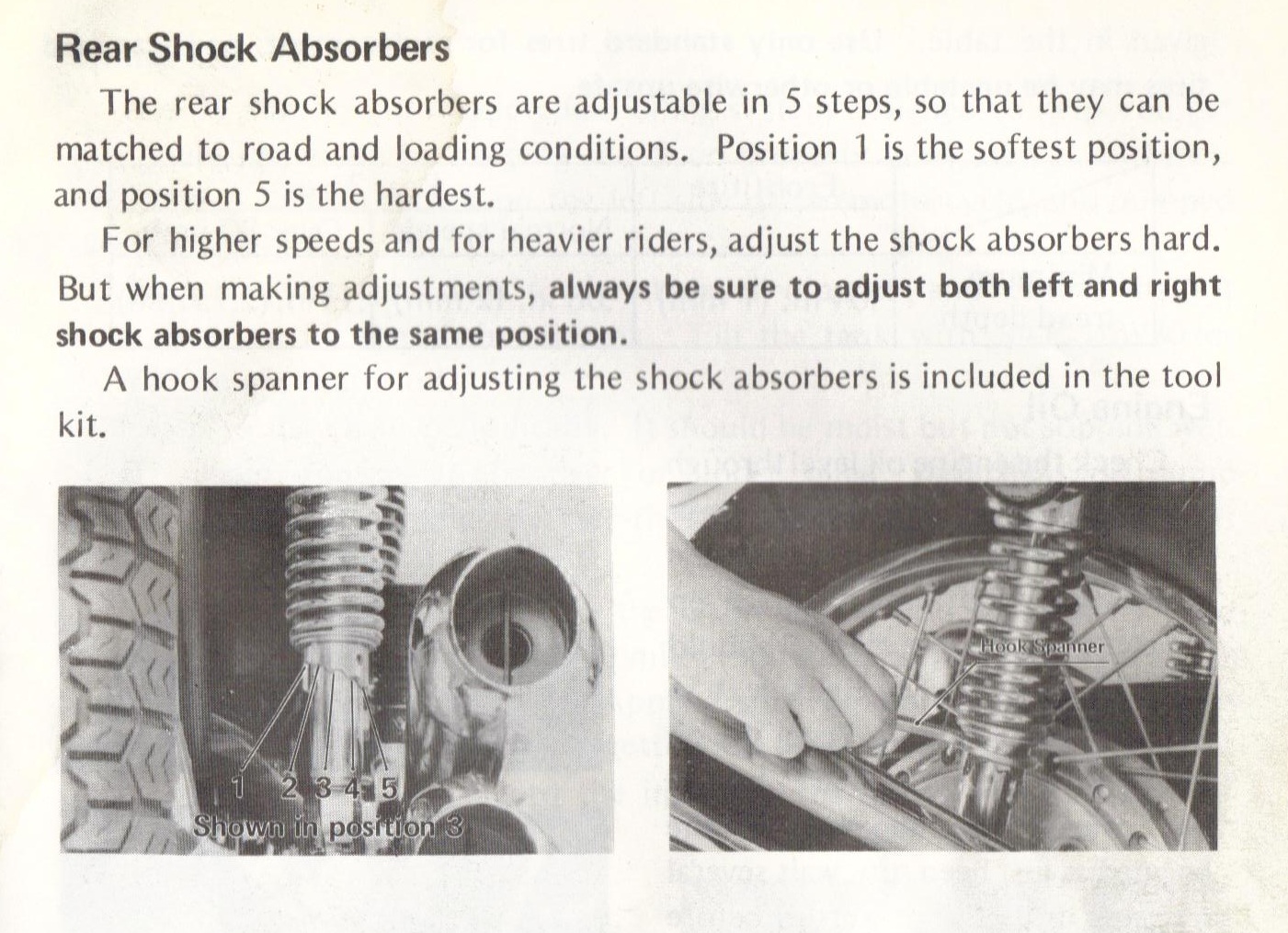

anyone know how to adjust the 5 way shock adjusters? mine seem like they just want to spin freely in circles, i put the springs on softest now i want to fool around with the shocks. i was advertised in my research that these are supposed to be adjustable shocks. already feeling better about my springs being softer but i want the shocks adjusted.

26 Mar 2012 12:09 - 26 Mar 2012 12:10Rotating the spring by grasping and turning it by hand doesn't accomplish anything, other than exposing a different view of the spring.donthaveakawman wrote: anyone know how to adjust the 5 way shock adjusters? mine seem like they just want to spin freely in circles, i put the springs on softest now i want to fool around with the shocks. i was advertised in my research that these are supposed to be adjustable shocks. already feeling better about my springs being softer but i want the shocks adjusted....
There's a special tool for adjusting the shock spring preload.
