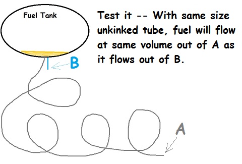

The web article says: "When the float valve opens, air can go back into the fuel line from the carb's bowl chamber, as fuel trickles into the carb float bowl chamber. . . The stock fuel line routing allows these small bubbles to rise to the fuel tap and bubble up into tank, keeping the fuel line relatively clear of large bubbles,When the float valve opens, air can go back into the fuel line from the carb's bowl chamber, as fuel trickles into the carb float bowl chamber."
Here's why I think that's incorrect:
The motorcycle carbs I'm familiar with all have float bowl vents whereby air escapes from the float bowl (and without forcing its way through the float valve against incoming fuel and ultimately into the fuel line).
With a properly functioning bowl vent, there are no "bubbles" created by air backing up into the fuel line. And no such bubbles in the fuel line blocking fuel flow into the carb.
So long as the fuel line isn't kinked, long loops of fuel line are perfectly all right, provided the loops remain below the tank.
To provide sufficient room to accommodate in-line filters, longer looping lines are often necessary and commonly fitted without causing any problems.
Ample fuel flow here:
