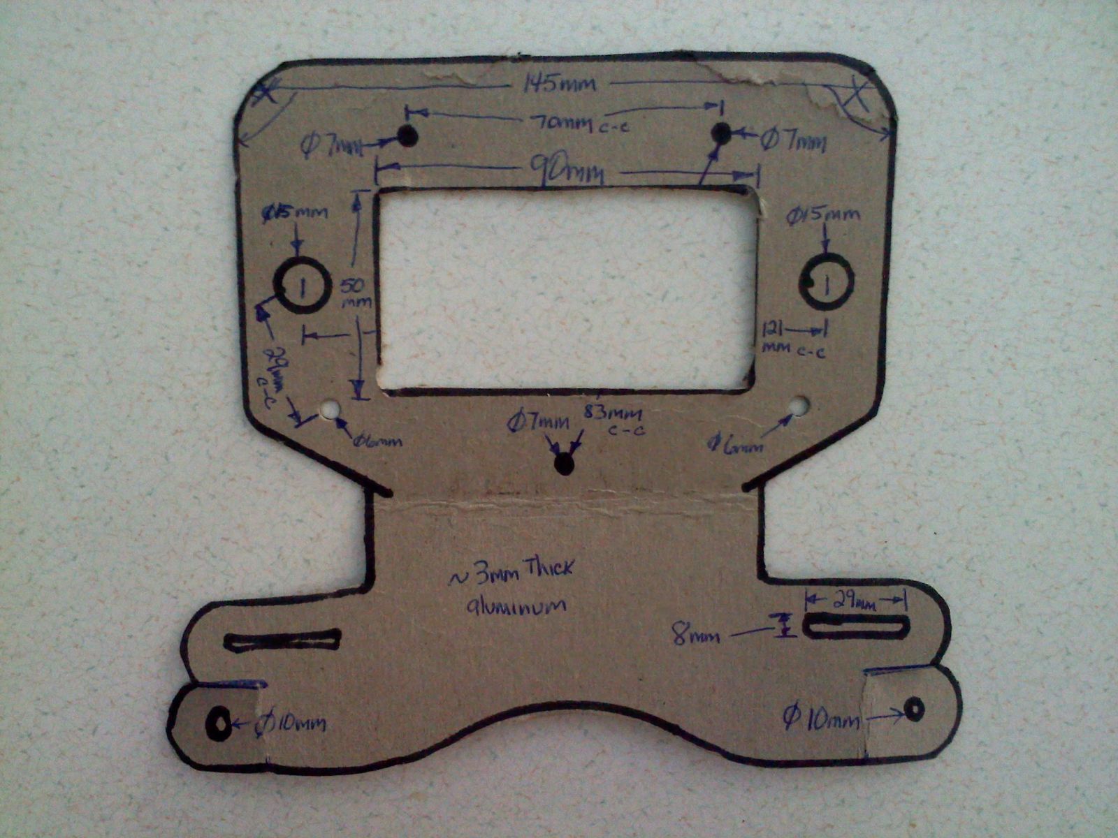

Hello All,
I'm looking to make a custom tail light bracket / license plate / turn signal bracket. I have a template made and would love to have somebody cut it out on a machine. Isn't there somewhere I can send it? It seems like there would be a web site in this day and age where one could have just about anything made. From what I've seen a plasma or water-jet cutter could do this in 5 minutes. It needs to be make out of aluminum plate around 1/8" thick. Actually could be any material/thickness strong enough to hold a plate and a set of turn signals.
I can cut this myself but it would look a lot better if it were done professionally. I'd have to use all hand tools....no drill press or band saw, etc...
Any ideas?

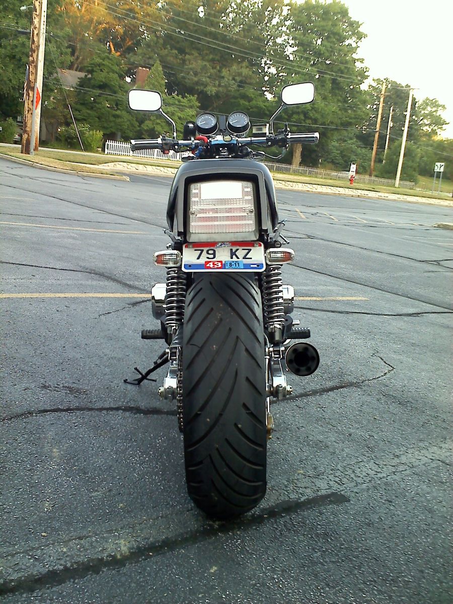

This is what I had - 2 pieces - the plate bracket broke after 950 miles. I thought a new one piece unit would be great.
(view from underneath):
And how it looked before it broke:
Any ideas?

Nice design, You'll need to make it out of thicker materiel or double it up or tempered aluminum STREET SIGNS are tougher than hell. For water jet or EDM you'll need a CAD drawing and a one off will be expensive. Drill your holes and use a fine sabre saw blade. Then progresively finer files and sandpaper. Scotchbrite or polish. YOU CAN DO IT!

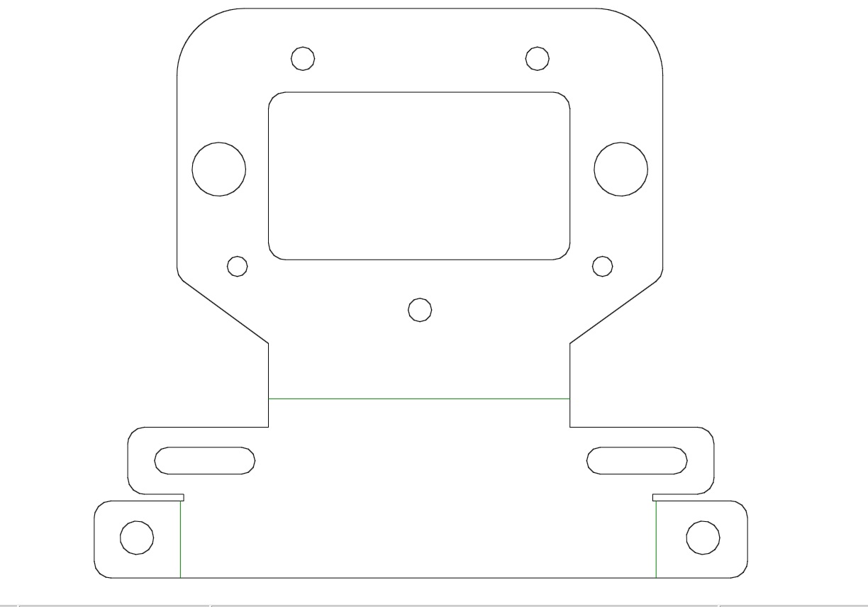

In the mean time, I just found www.emachineshop.com You download free software, design your part, and get a price. I'll try to get the part drawn up this weekend and see how terribly expensive it will be.

The fender eliminator kits I've bought before, for the MKII and the KZ A's, are all made from 3mm thick aluminum. Will that be strong enough? Material selection has been difficult....not sure what I need. Stainless can be much thinner but cost more, steel is cheaper but will need painted or powdercoated...suggestions on how to calculate the material requirements?

21 Aug 2011 08:51Nice job on the CAD drawings
I know a couple of people that use their service. It's a volume based deal for pricing. More = cheaper. Might be worth your while to see what 5 would cost and ebay the other 4 or put them in the for sale section here...... just a thought..
