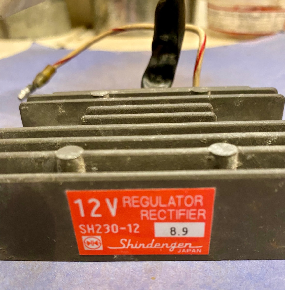

Motorcyclist breakfast in small town Ontario recently, though we all were in cars.
The Kawasaki's PO brought me a combined RR by Shindengen as pictured, an SH230 12. Not sure what the 8.9 is all about. The PO is a Kawasaki guy so I expect it came from a Kawasaki, but neither of us know. ?????
It's diodes tested good with a test lamp, and I think I can wire it in with some connector rework. It's almost certainly one of the shunt type RRs.
I tried to get my mind around the shunt and series RR pros and cons.
I'll share what I "think", but certainly can't claim to "know".
Something like the '77 KZ1000 uses the shunt which throws all excess power to ground, but with lights etc all on, there's not much excess. Most of this excess power is dissipated by the Zener in the RR, hence all its finning. But current in the stator is maxed out. Power is heat and P = I^2R. R is always low for the stator windings, and there's not much excess I, but that is an exponential.
A modern adventure bike, might just be street ridden, or be used with dual extra big high wattage lights, GPS, heated grips and jacket, etc. So their alternators have a lot of excess capacity when not loaded up with adventure gear. So it's best not to just dump this large excess to ground because it's a lot of power. Hence the series RR makes good sense. But I guess there's still a Zener in the series RR as it's still heavily finned. With series regulation, that controlling resistance lets the voltage in the stator windings go up similar to what it does when you test their AC voltage without load. So Power, P, is also P = IE. So if we let the voltage E go up so does the power. But E is not a exponential, so power doesn't climb quickly with E. One more thing though is that higher E might be more likely to cross through insulators and leak to ground, so that's a disadvantage.
But these are just the musings of someone who's last electrical instruction was 10th Grade electronics, where I sat back and let my partner do all the work.
I'll wire in the Shunt Shindengen to get the old Zed running, and look to a future Series Shindengen if she's a keeper.
Thanks guys.............

- Posts: 7987
- Thanks: 3367
Re: Trying to Rescue a Late 1970s (1977??) Kawasaki KZ1000
05 Mar 2023 13:03
Your explanation of series vs shunt R/R's seems good to me. I run a series type SH775 on my bike, because it helps protect the stator, and in the end, it's not much more money, if any, than a shunt R/R. I find them on eBay, test them on my bike, and then resell them for beer money. Many times I can find them for $40 shipped, which is a no-brainer to me.
The following user(s) said Thank You: wdhewson

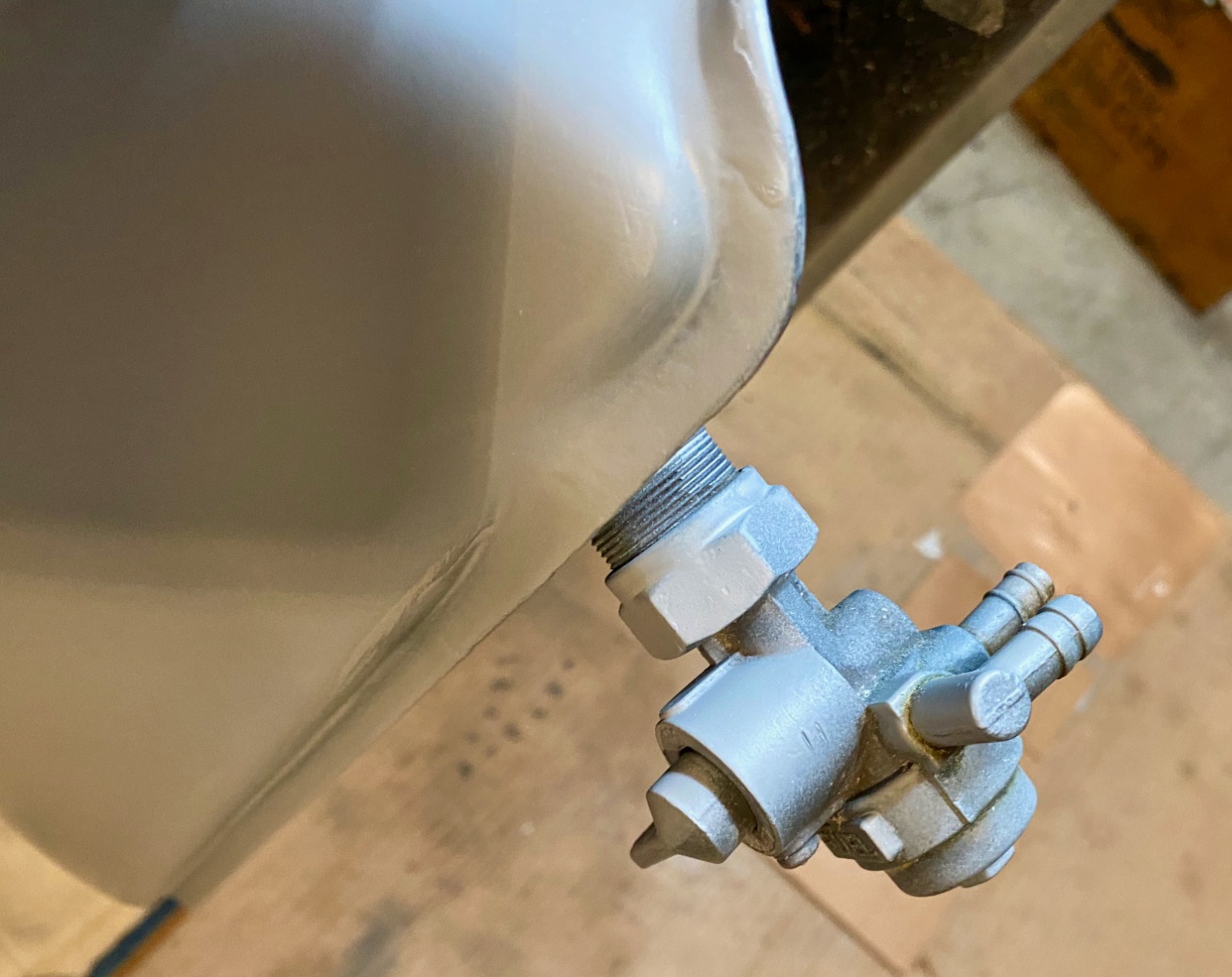

The bike's tank was in progress for painting when I got the bike. I think it was well prepared with sanding and no fillers seem to been have used. The primer is a Rust-Check product and seems to be applied evenly, but with a few dust flecks. I sprayed some Rust-Check on a few test coupons to test compatibility with future final paint coats. It appears that the underside of the tank was not prepared, and I might scrub that up a bit and hit it with the same primer.
The petcock was not removed for priming, just as well I suppose to keep the threads clean.
The tank's interior looks pretty good, and not much rust came out when when removing the petcock. Penny for scale.
I'll likely do my usual trick of filling the tank with pebbles and hot soapy water and shaking things around until thoroughly fatigued. Repeat that three or four times. Interestingly the sodium sulfonate detergents in dishwashing liquid are pretty good rust preventatives. But I'll also cloud the interior with some WD-40.
I'll next get into that petcock to see if it can be salvaged.

Here's the petcock disassembled and cleaned up.
Fortunately the filter screen is is good shape, unlike the lever O-ring which has a few bites out of it.
It seems there should be a filter atop the main brass inlet tube.
The two steel pins, that transfer lever rotation to nylon valve insert rotation, have wallowed the nylon holes out a bit, but it's functional.
I suppose a new replica petcock is a better path forward than a rebuild kit ??

Why waste money for a new petcock. Your petcock parts are re-useable, you only need a new o-ring and crush washer.
Pro tip: Put a small round neodym magnet into the depression of the sediment cup to catch rust particles, makes your life easier.

I ended up using the repop fuel petcock that I bought as a backup. The little sort of square depression in the handle part in your picture had corroded through on my stock petcock plus I didn't want to cut the handle off the original petcock to clear the RS 34 carbs.
I think the repop petcock seeps when off so now I wish the original still was useable. I also didn't have the filter sleeve for it. It would be nice to have a good original one to rebuild but I'll likely end up with a Pingel petcock.
