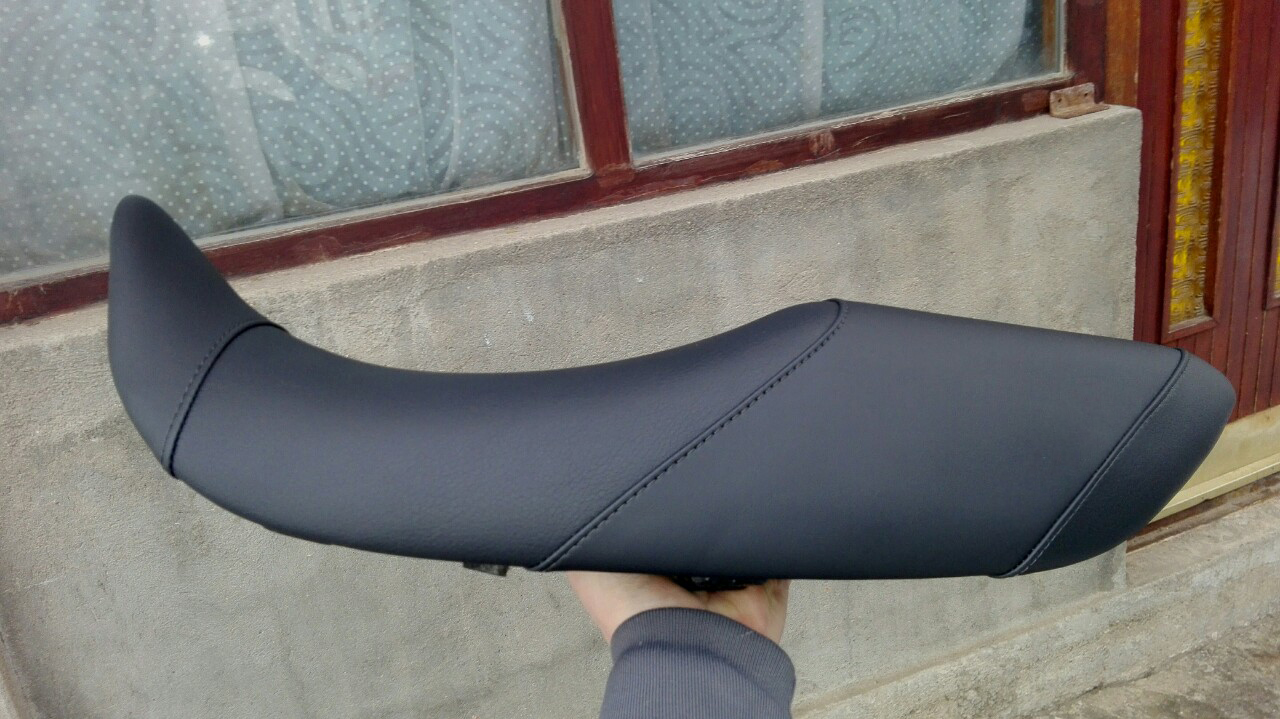

Re: 1984 Kawasaki GPZ750 A2 Restomod
24 Dec 2019 05:17 - 24 Dec 2019 05:38
Something had to be done with that front triple yoke, including the Honda logo on it, so i decided to cover it with a carbon cover and a custom made GPZ Decal.
