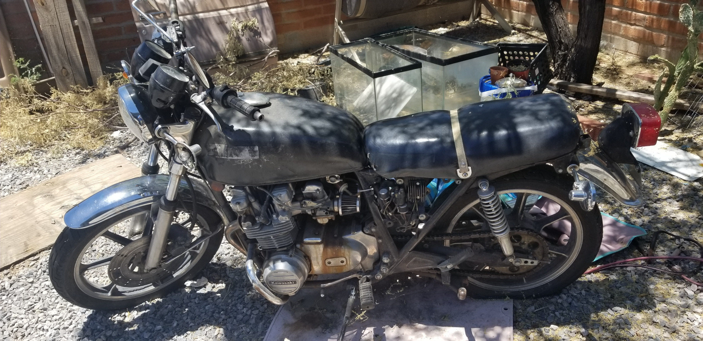

First Picture, before I bought it.

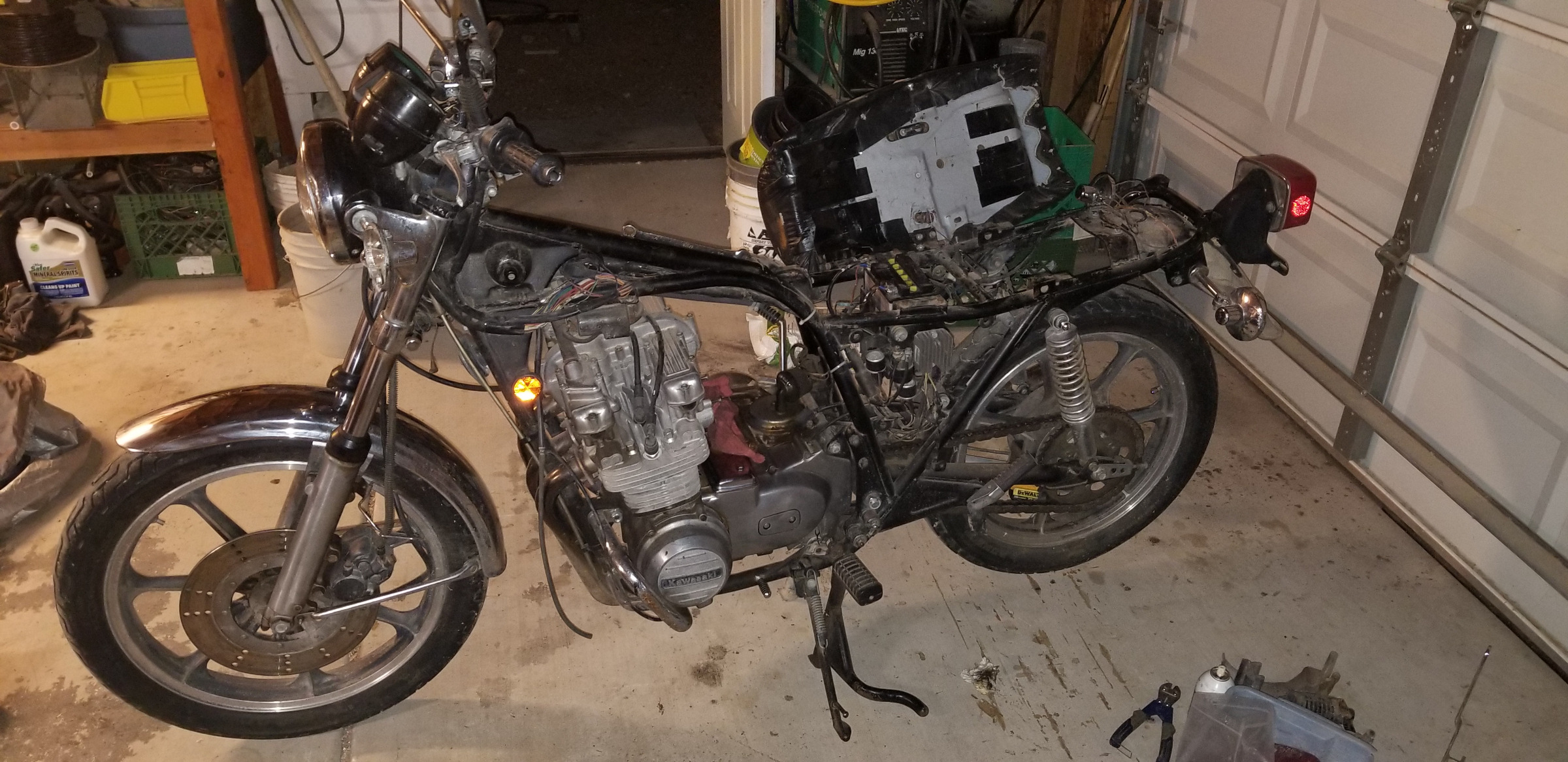

Sitting in the garage now, getting worked over.

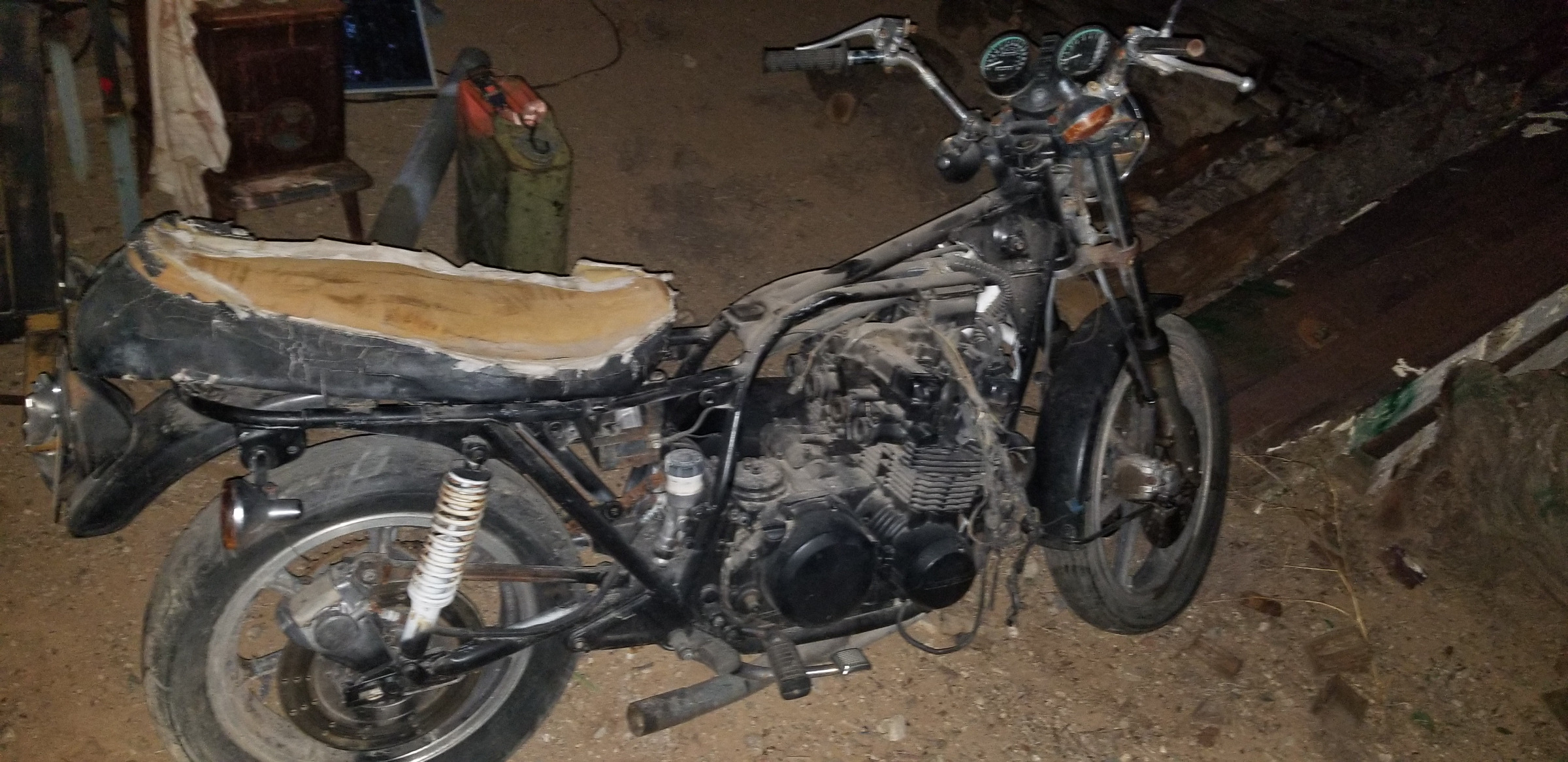

Parts bike sitting outside.
