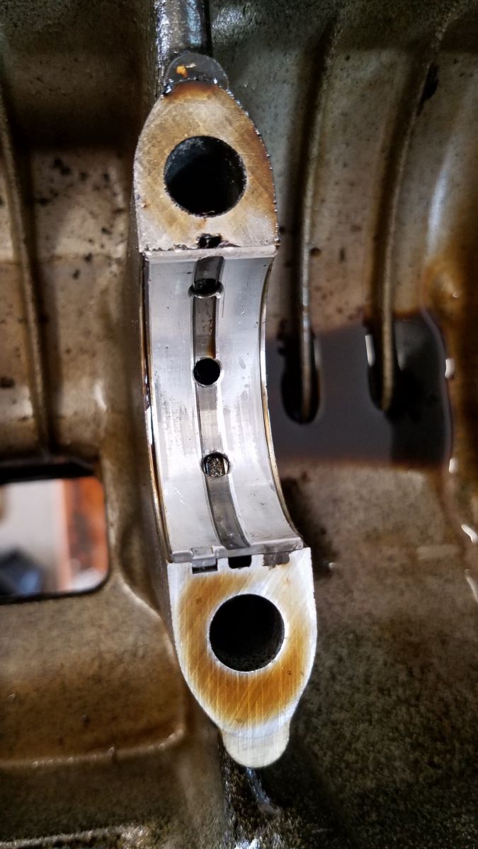

Since I do not want to ship the case halves anywhere (afraid of damage), I have been searching for a vapor blast company near Reno, NV. The only thing I have been able to find is a soda blasting company. Maybe some engine rebuild shops would have a hot tank they can use to clean these up.

Good to see you back into it. Just a note for reassembly: it's a lot easier to follow the manual and put the crank and transmission into the inverted upper case and put the lower on top. This way you can line up the pins on the transmission bushings when the upper case is on the bench and the mating surfaces aren't covered in sealant. This means assembling the halves and then sliding the secondary shaft through the primary chain. It is possible the other way around, but it's really fiddly and quite frustrating - ask me how I know this
With your setup I would suggest assembling the halves on a bench and then putting the crankcase on the stand as a unit.
Edit: If you're going to paint the cases I would say soda blasting would be fine. It will get everything clean and you can rinse out the residue.

All of the debris in the engine turned out not to be metallic. I checked everywhere with a magnet, so it must be carbon deposits. I found similar debris when I drained the oil prior to taking the motor apart. Now I am left with an availability issue on the lower rod bearings. I need p/n 13034-051 Black bearings, and I could only find four of them, but need eight total. I got the last four Partzilla had. I found one (only one) on Ebay, but I really don't trust Ebay for precision parts. If anyone has any other sources they know of, please offer them up. Partzilla and Z1 Enterprises no longer have any.

Any aluminium floating around in the cases won't be picked up by a magnet. If all the bearing/mating faces are OK then that's not really a problem though. In that case, any aluminium is probably due to people like me working on the engine and knocking shit into it like an idiot
Edit: did you try CMS for the bearings? Shipping to the US shouldn't be too horrendous.

Yes I did. CMS is out of stock as well.
I guess I should have been more clear on the debris - nothing on the magnet, and upon further inspection nothing metallic. I am aware that aluminum is non-magnetic.

I looked at CMS and they seem to have the bearings in stock but show a different part number. For the E1 (1980) the parts list shows the coloured bearings and the black one (and the newer versions) are available:
www.cmsnl.com/kawasaki-kz750e1-1980-usa-...90.html#.XtwcFW5uLic
The E2 just lists the black ones:
www.cmsnl.com/kawasaki-kz750e2-1981-usa-...32.html#.XtwcgW5uLic
Also, you'll need 10 in total, not 8.
Had a look at partzilla as well and they seem to have 92028-1101 in stock (and they're a lot cheaper than the newer version 92139-1072).
