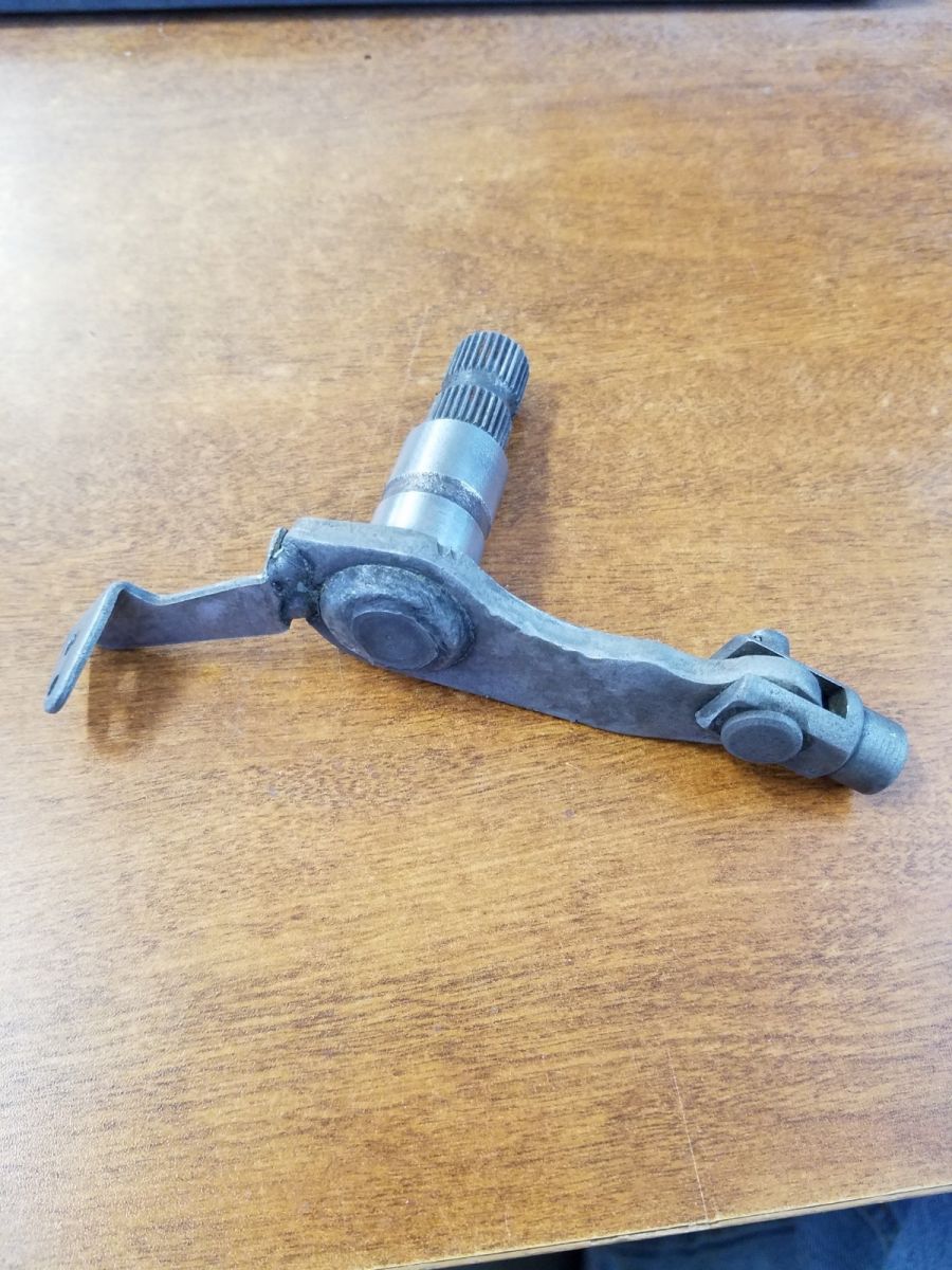

I soaked the brake pivot shaft in Evapo-Rust for two days. This part was solid rust on every surface. I've been using it for a lot of parts on the project, and I highly recommend it.

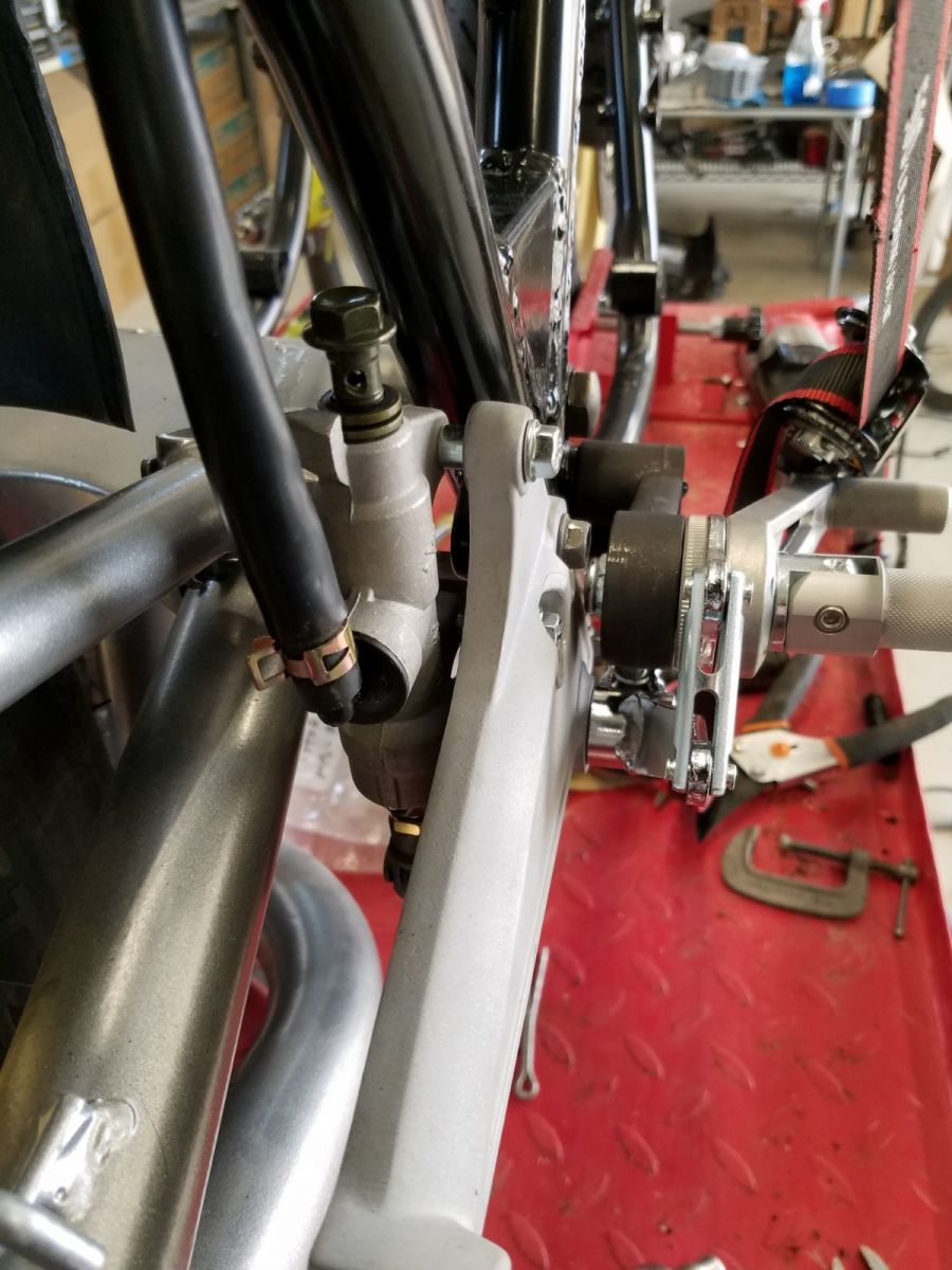

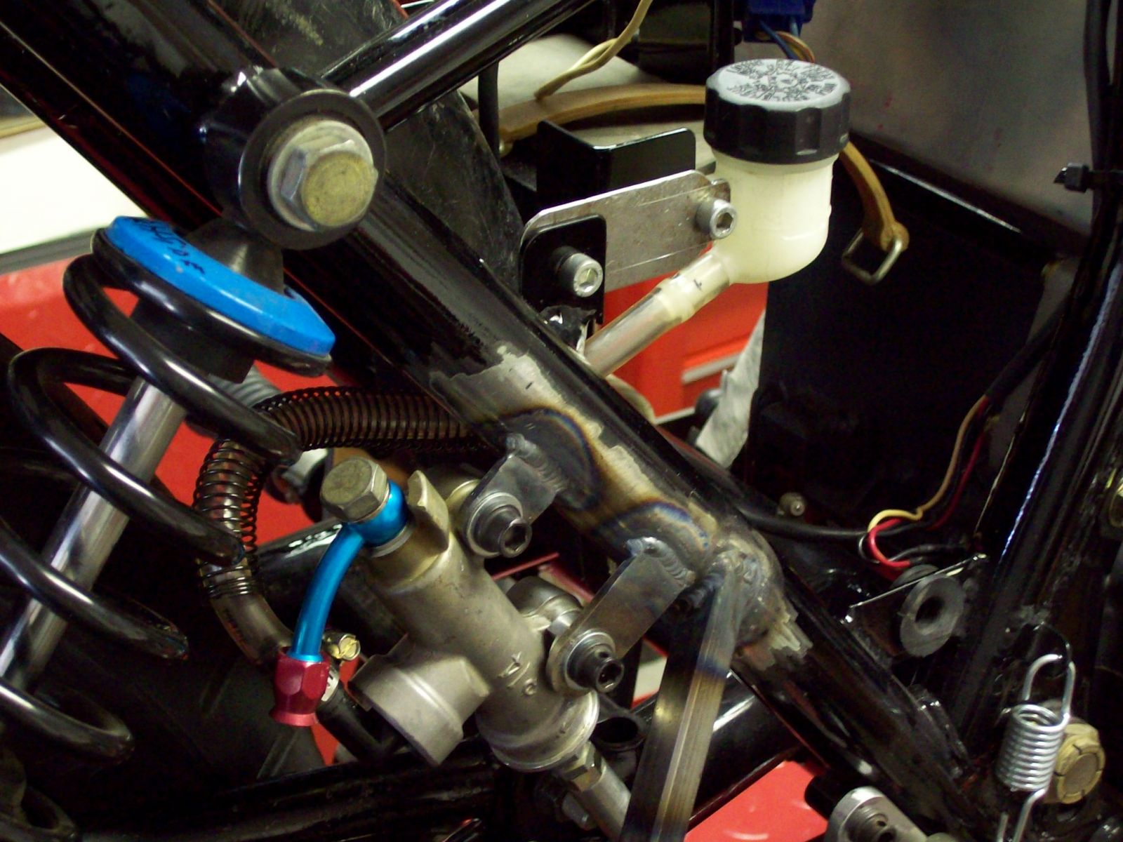

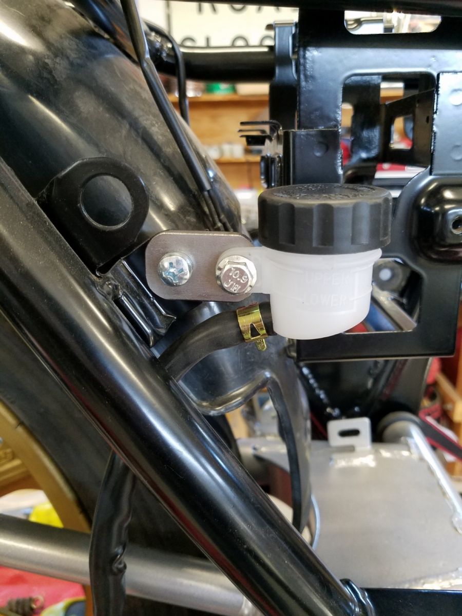

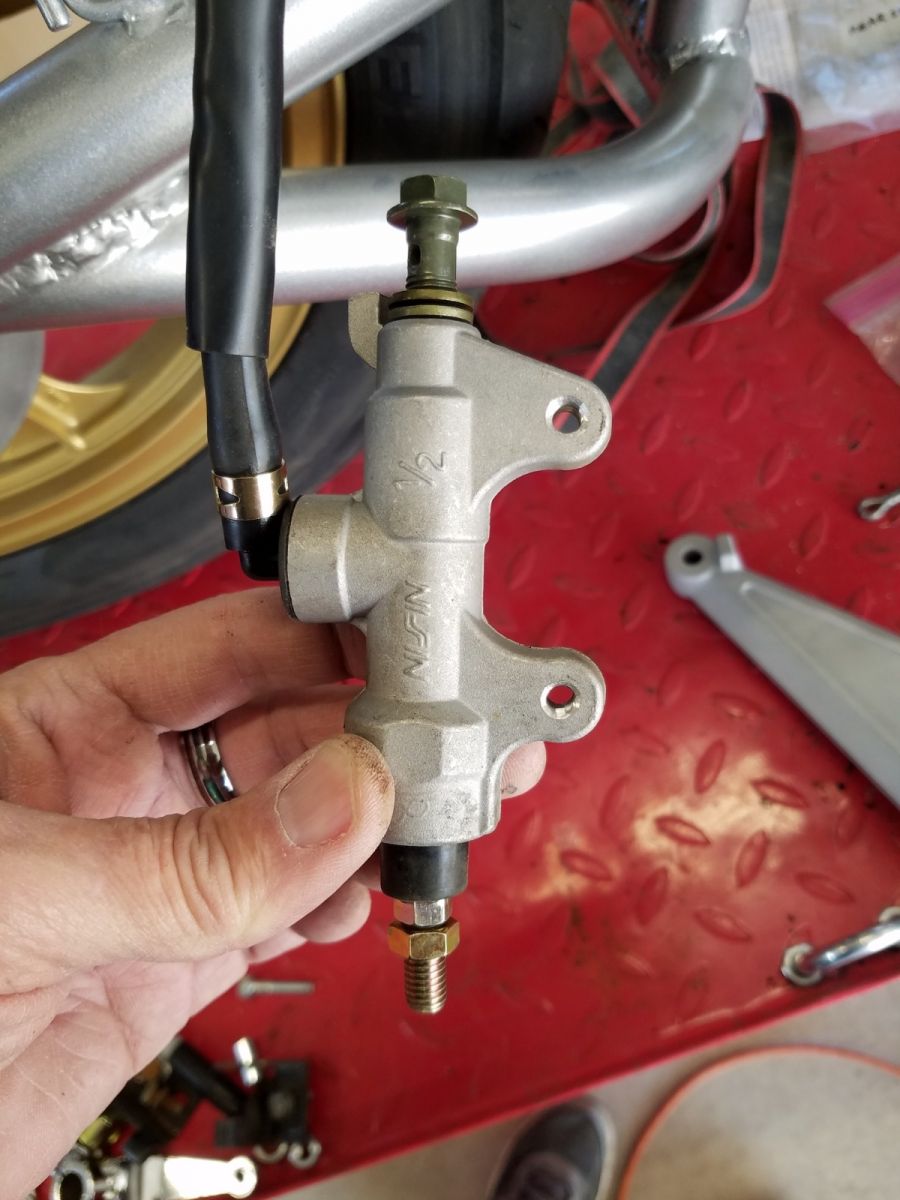

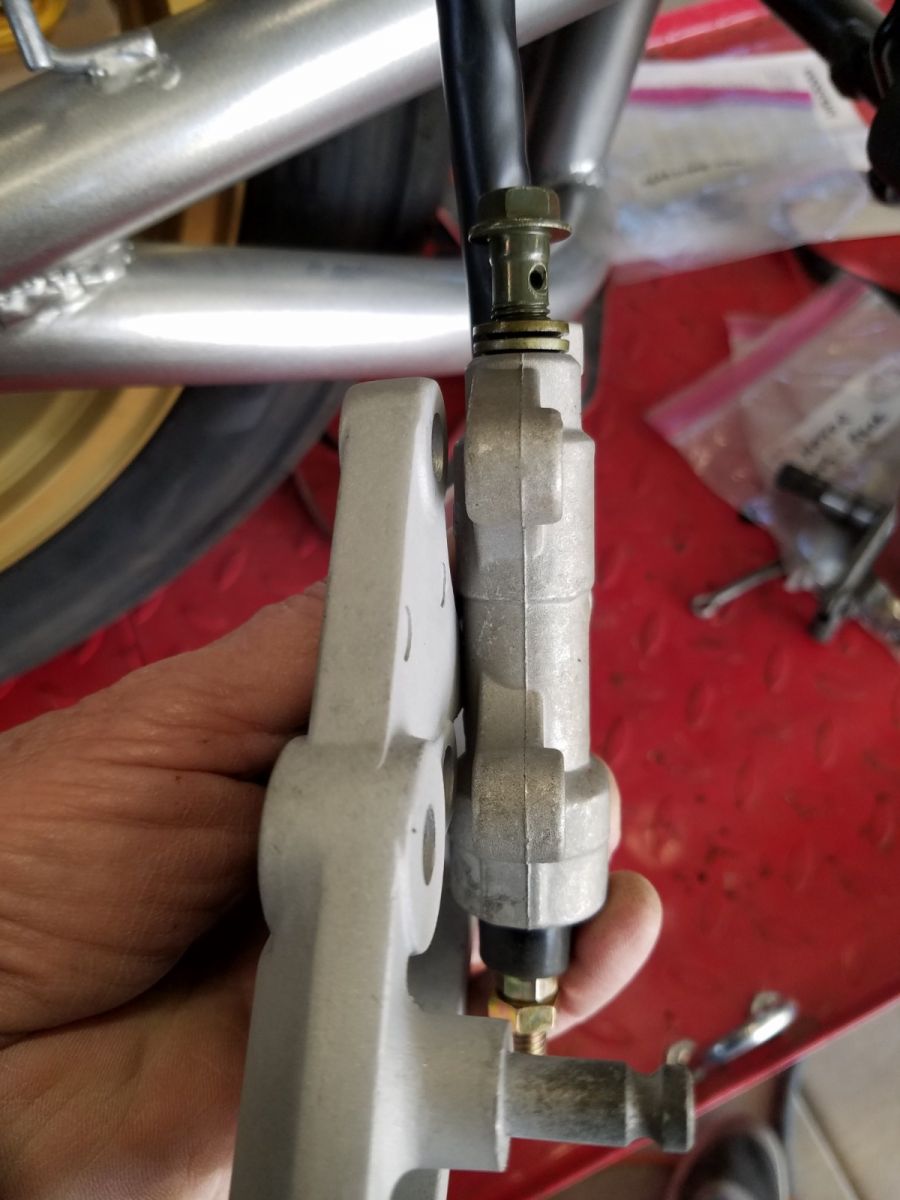

When I purchased the rear MC for a ZX-06 I neglected to pay attention to the orientation of the hose and mounting tab. The outlet was hitting the frame tab. A simple flat bracket solved the issue.
Retired gearhead
'81 KZ-750 E2
'81 KZ-750 E2
- Dr. Gamma
- Posts: 1232
- Thanks: 706
Re: Saving a '81 KZ750-E
18 Feb 2020 15:46
Ran into same problem when I tried to mount the reservoir for my rear master too!!!
Same fix as you!!!!
Same fix as you!!!!

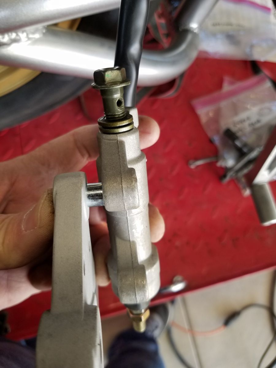

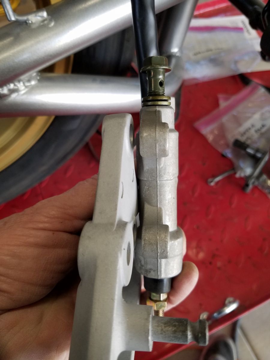

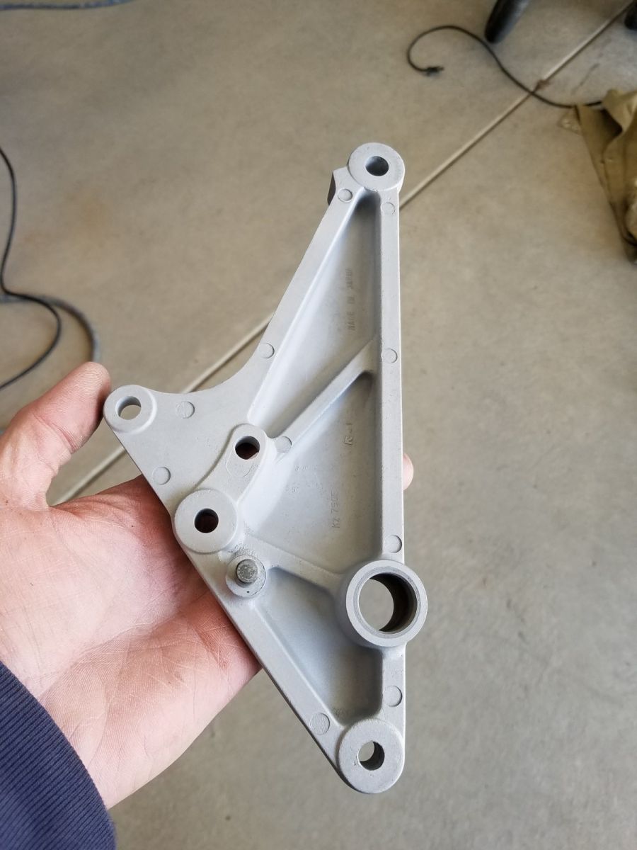

I snagged a OG bracket off Ebay to replace my broken one.
The ZX-06 rear M/C has the same bolt spacing for the stock mounting bracket, but it's not a direct bolt up. The ZX-06 uses 6 mm bolts, but the KZ bracket has holes for 8 mm bolts. My solution was to drill out the bracket to fit steel spacers - 3/8 od x 1/4 id x 3/4 long. This puts the centerline of the M/C almost perfect with the spacing of the brake pivot shaft linkage. I will use another spacer over these to keep the M/C rigid.

21 Feb 2020 14:58

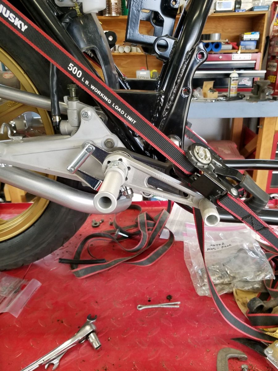

- Thanks: 312
21 Feb 2020 15:59 - 21 Feb 2020 16:35

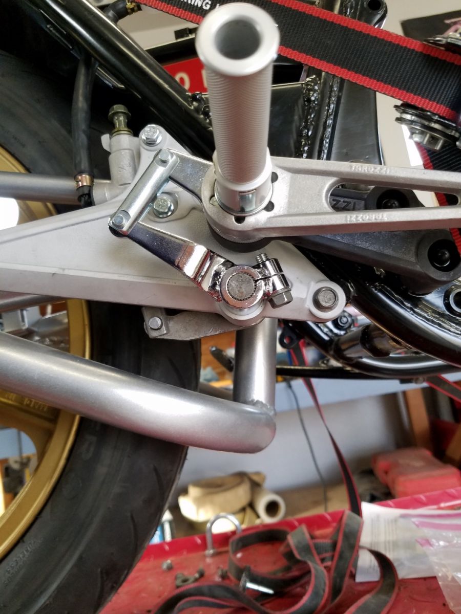

Parts used:
'06 ZX-06 rear master cylinder
(2) spacers, 3/8" od x 1/4" id x 3/4" long
(2) spacers, 3/4" od x 3/8" id x 5/16" long
Tarozzi rearsets & brake linkage
New brake line, stock length with 0 degrees rotation between banjo fittings (stock line has 90 degree rotation)
Modifications:
Drill out two mounting holes for M/C using 3/8" drill
Trim reservoir line 4-1/2"
Trim reservoir line cover 2-3/8"
Modifications:

21 Feb 2020 16:03 - 21 Feb 2020 16:08

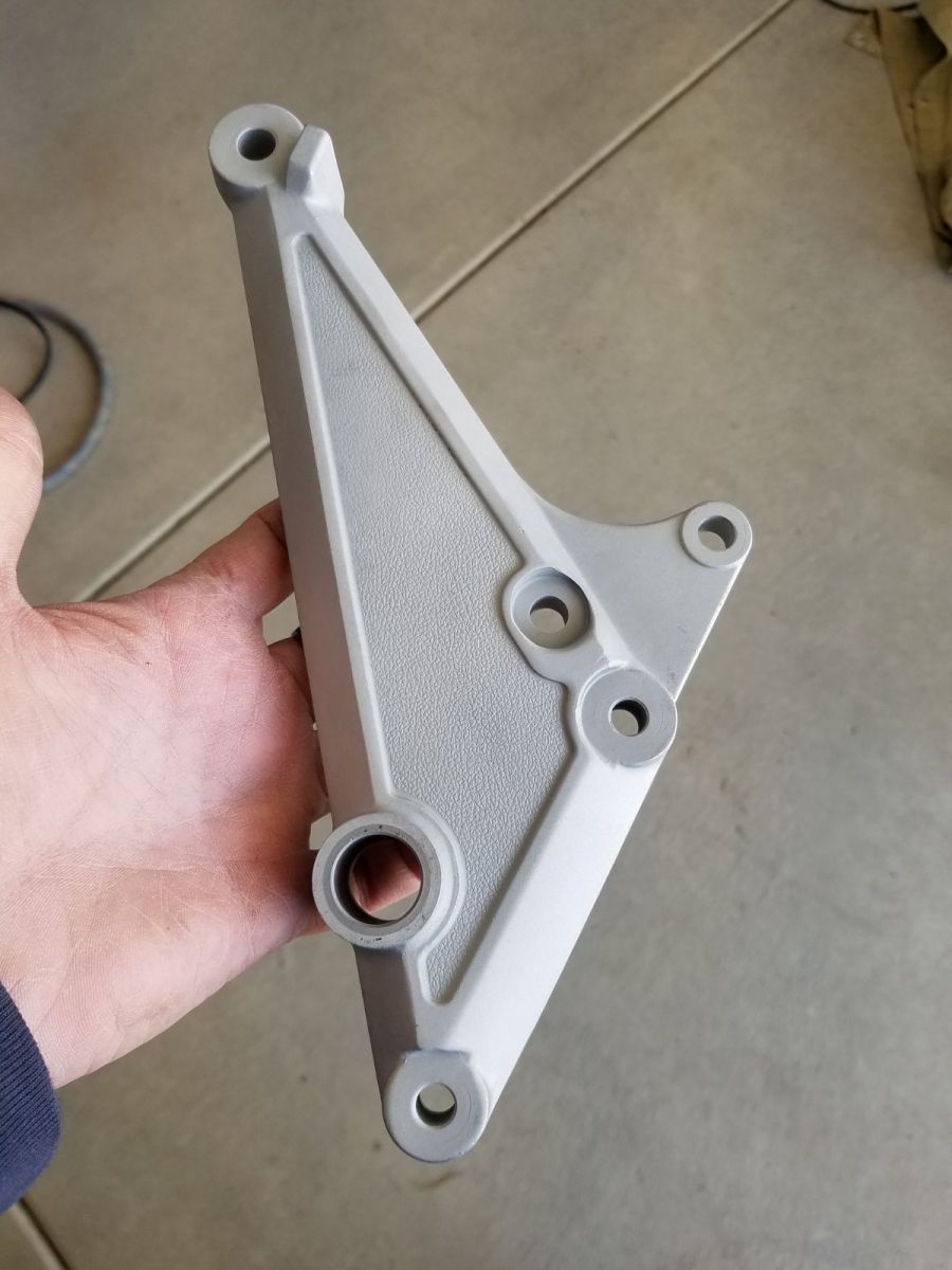

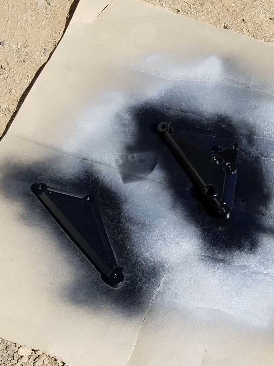

Now I need to pull it all apart to paint the mounting bracket and brake pivot shaft. The two larger bushings will get installed over the small bushings after paint.

After multiple attempts to paint the rear footpeg brackets two tone (like stock), I threw in the towel and blacked them out. Single color is so much easier.

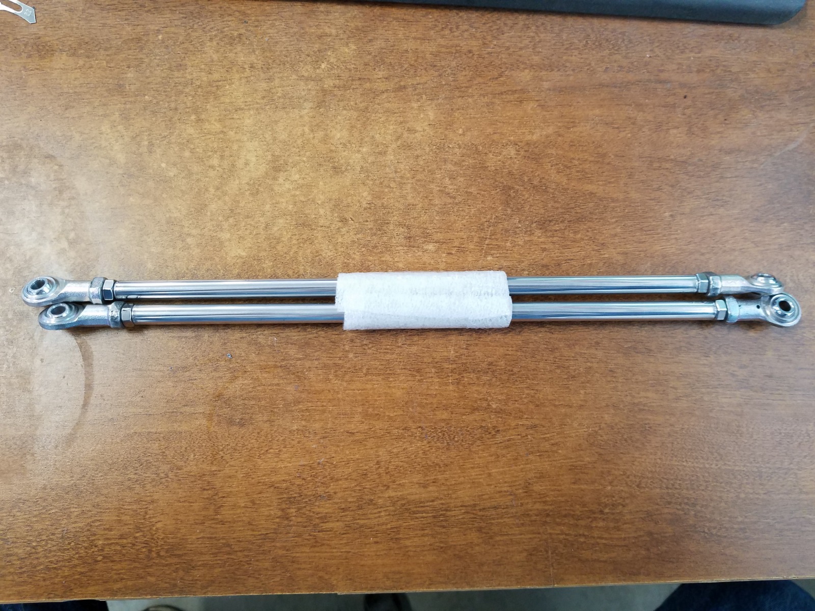

My shifter linkage showed up today. I found a set to be less money than building one by purchasing all the parts and assembling it. And the tubes are polished.
