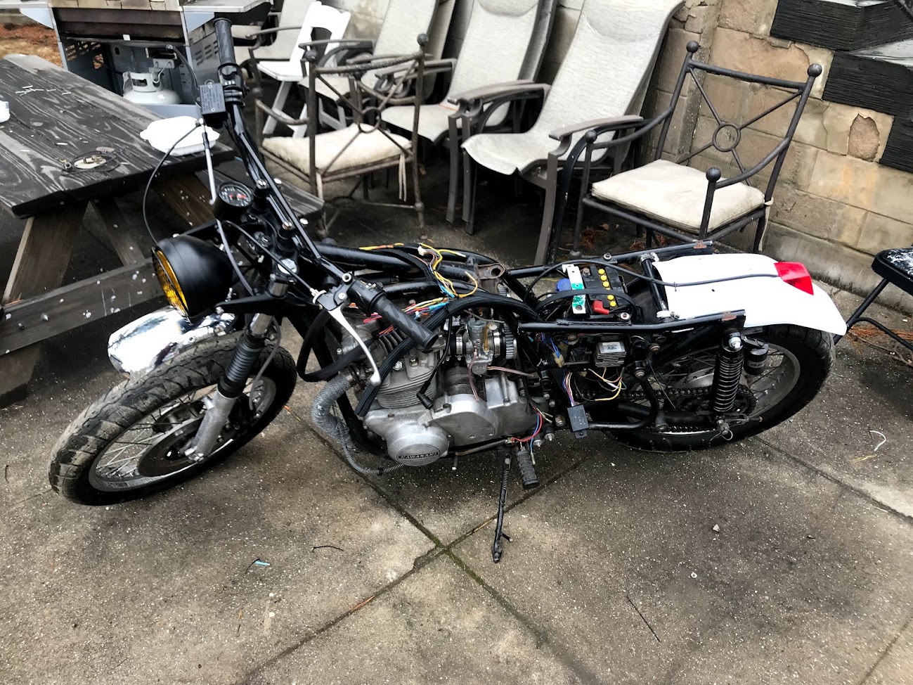

Here's where the bike's it sits at right now, I've been dealing with a no spark issue for the past few weeks. Got a weak yellow spark a few days ago and got it started but it's lost the spark again. I cleaned the points and put a new coil on that are both getting 12V, my next steps are new plugs and boots and condenser - any ideas what the problem might be or should I ask over in electrical forum?
Mocked up with tank, and rear fender:
lh3.googleusercontent.com/BQ6vQatSWbVPFX...oMpgNg=w1299-h974-no
And here's where it is at the moment:
lh3.googleusercontent.com/NhPYRByi26gQ6z...E6MlOD=w1299-h974-no

First things first tear down and redo the wiring, the harness wasn't in too bad of shape, took everything out of the headlight and routed it under the tank. Got the bike to crank and fire up on first test!
The started clutch is shot but 'll wait to work on that until I get it running and driving.
Found out the hard way the wiring keeps the tank from fitting into the rear rubber cup but should just be a few degrees off.

Had some good weather today so I was able to put some time into it.
The no spark issue was from a bad plug boot so got that replaced and tidied the wiring up.
Got the tank and side panels back to see how she looks.
Mounting seat and fender are going to be tricky, going to have to fab up some seat mounts and get someone to weld those on along with the rear hoop.
Thinking about looking for an old chrome rear fender to try and get some more clearance with tire and match the front what do you guys think?

Cool project. My vote is for a chrome rear fender, the plastic one looks out of place. Also if you want to ditch those massive sidecovers I believe the 1980 kz750G covers will fit right on there and are much smaller and sleek.
