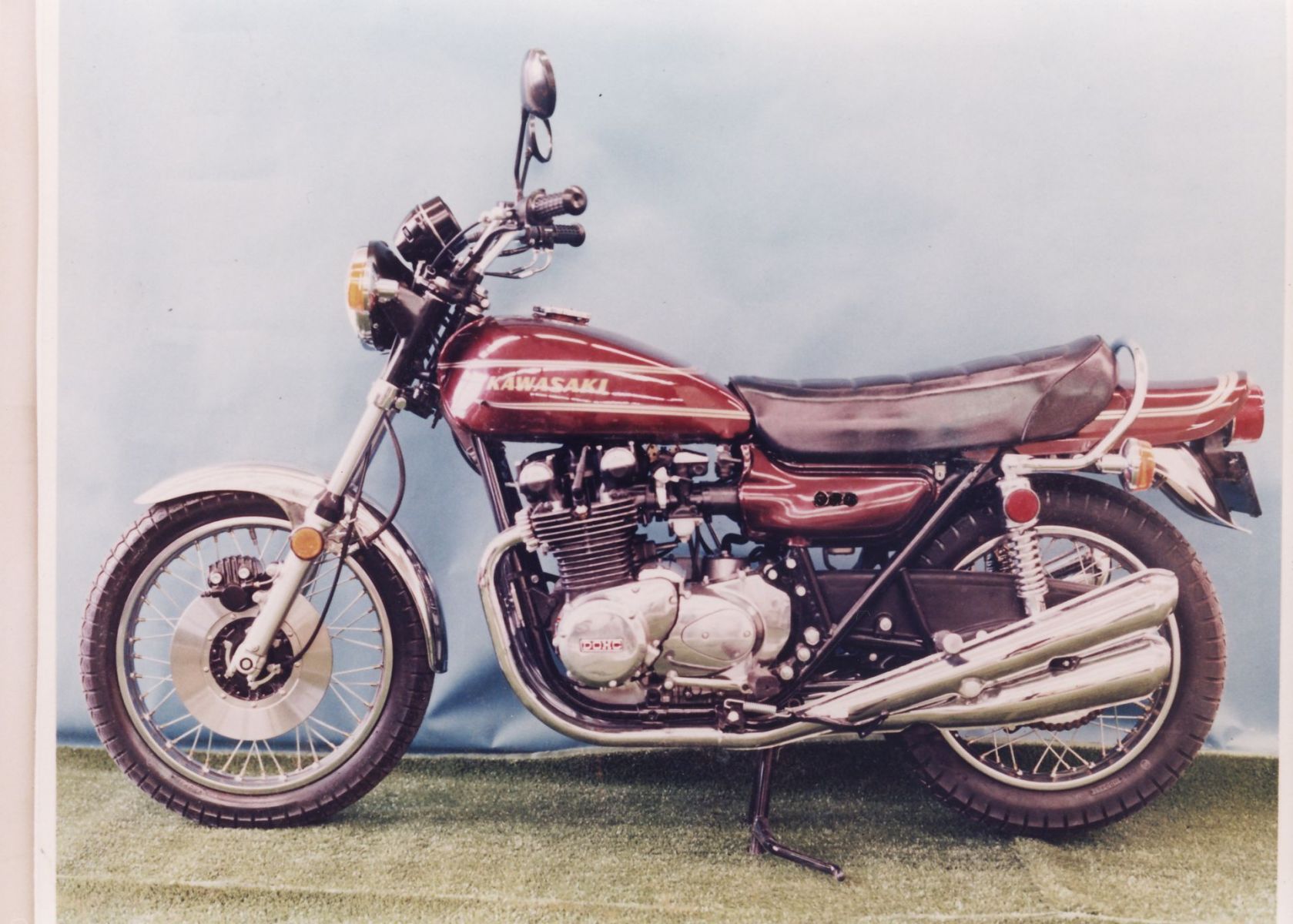

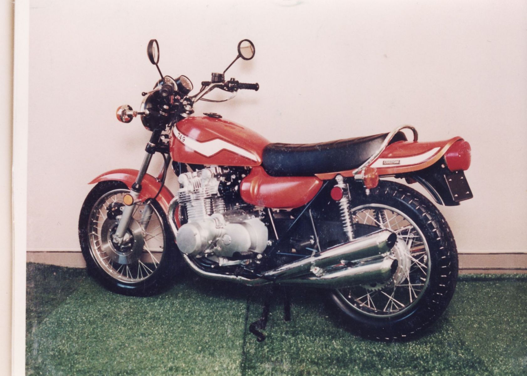

I like the 73 color paint scheme ( root beer / orange ) on your bike.
Keep going gvsu141
BTW some early 72 prototype colors
Michael
Keep going gvsu141
Michael
