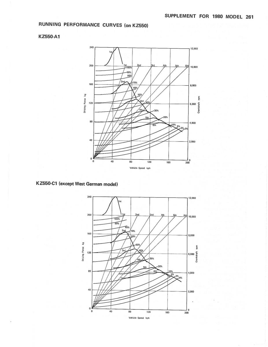

For such a low miles bike (still under 1000 miles), I think the gearing may have been changed?!?
Should I be turning 7000 grand at 70 mph in 6th? Hmmm...

If i interpret the speed / idle diagram right you should be go 100 mph @ 7000 rpm
