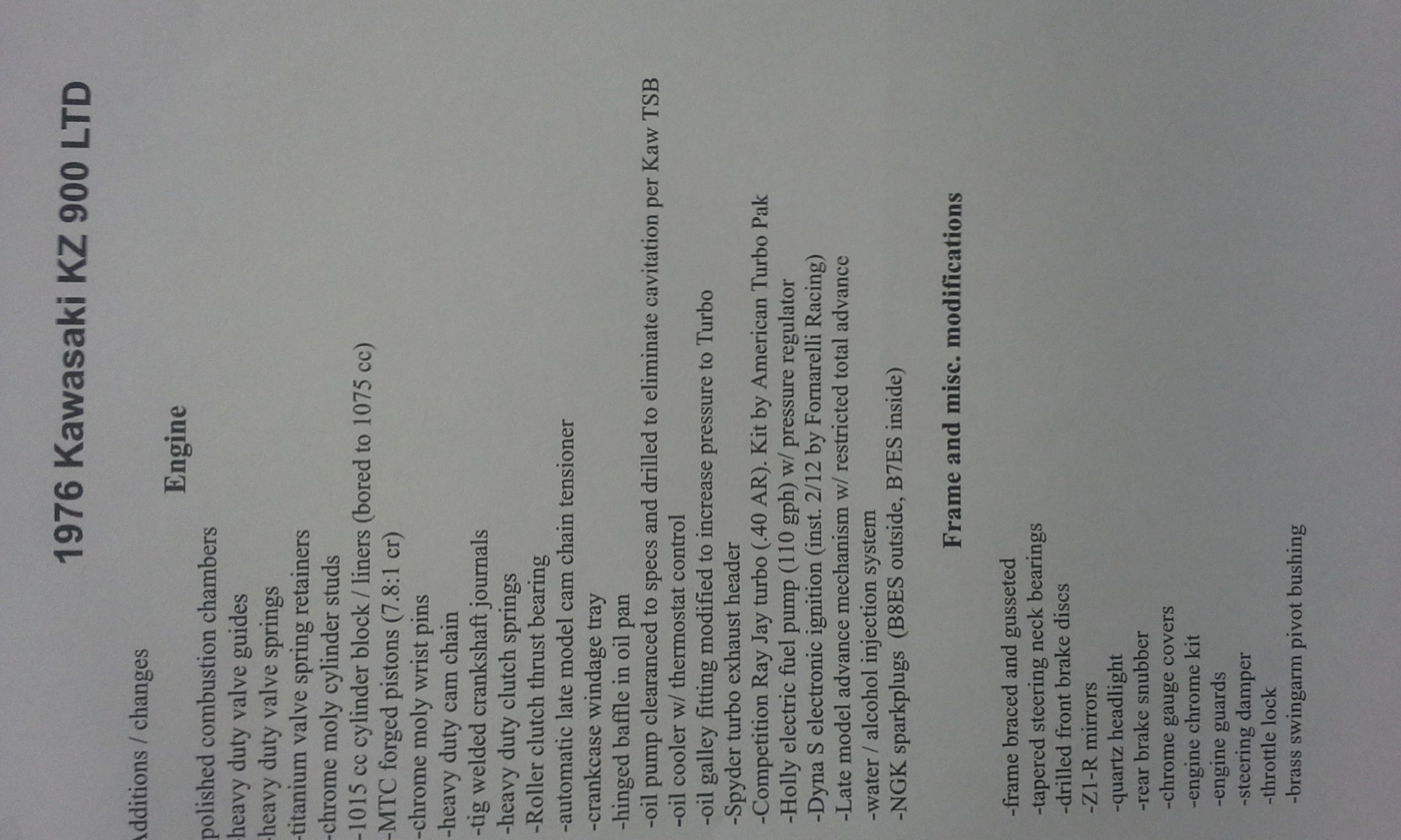

I finally finished up several other projects and now I can concentrate on this gem. I bought if from the original owner, he bought it new from "The Bike Shop" in Hammond Indiana. In 77 he built the first turbo motor 1015cc and ATP. Second motor is 1075 , 7.1/2 to 1 MTC turbo pistons welded crank head work etc.

Bike came with all the paperwork from new, motor receipts, complete ATP package

I have no idea how to scan this to my computer so I took a photo
