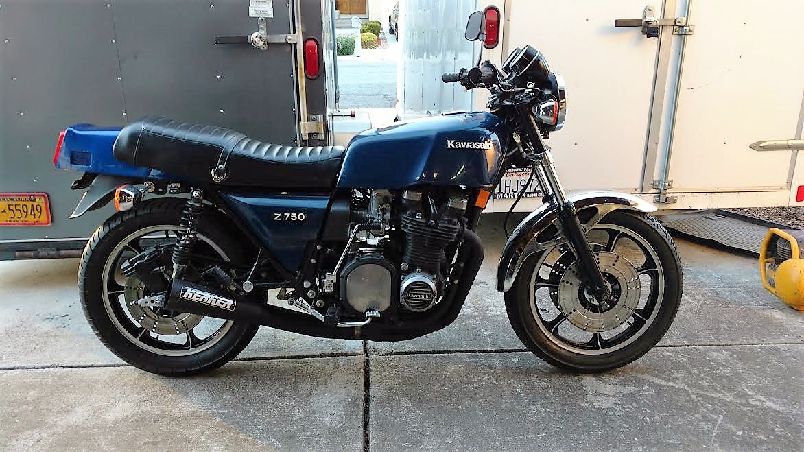

- mjg15
- Posts: 698
- Thanks: 18
Re: rare Z750/MKII resurrection
31 Aug 2016 22:14 - 31 Aug 2016 22:19
Progress has been slow, but I'm still working on it when I have some time. I've made some subtle changes. I've added superbike bars and short cables, a pair of Konis, and an 18" Z1R front wheel. I've also removed the oil cooler a,d resprayed the tail a different blue. The paint wasn't original, and was non=metallic, so I'm trying to get closer to stock. I did the tail as a quick test to see if I like the color (same as I used to match my '07 GSXR race bike). Still need to rebuild the brake system and add a 530 chain.
