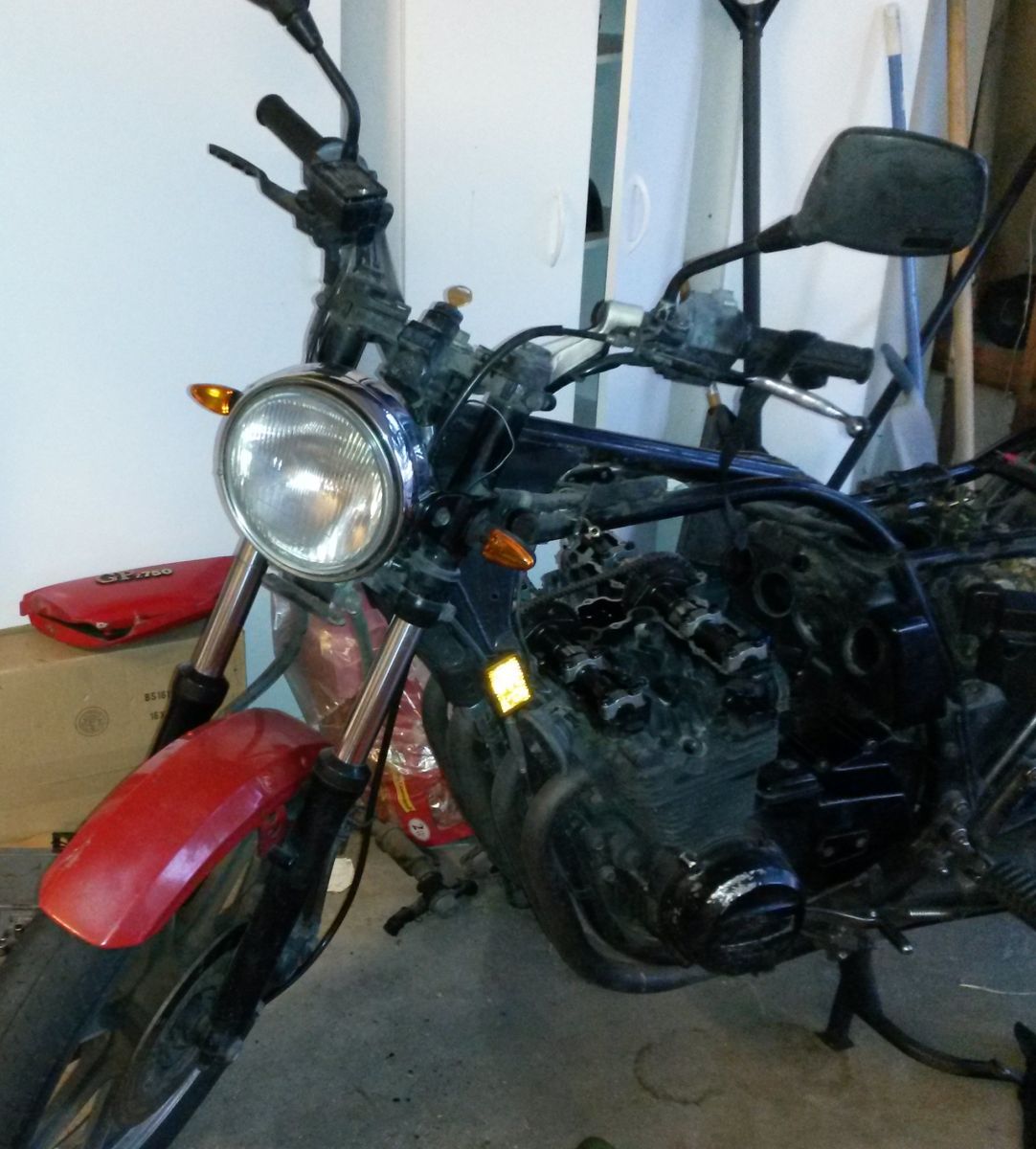

A bit of progress, Token progress as it might be. I stated earlier that I didn't like the square headlight. So while surfing eBay I found a killer deal on a nearly complete Spectre headlight assembly, I got it today so I ran out to the garage and mounted it up ASAP. I think it looks pretty good. I'll go through the wires after I get my instrument cluster in and make sure everything is back where it's supposed to be. I do think I m going to flip around and invert the headlight mounts on the forks so it sits just a bit lower. The aiming brackets don't match so I'll have to find a remedy for that as well.
