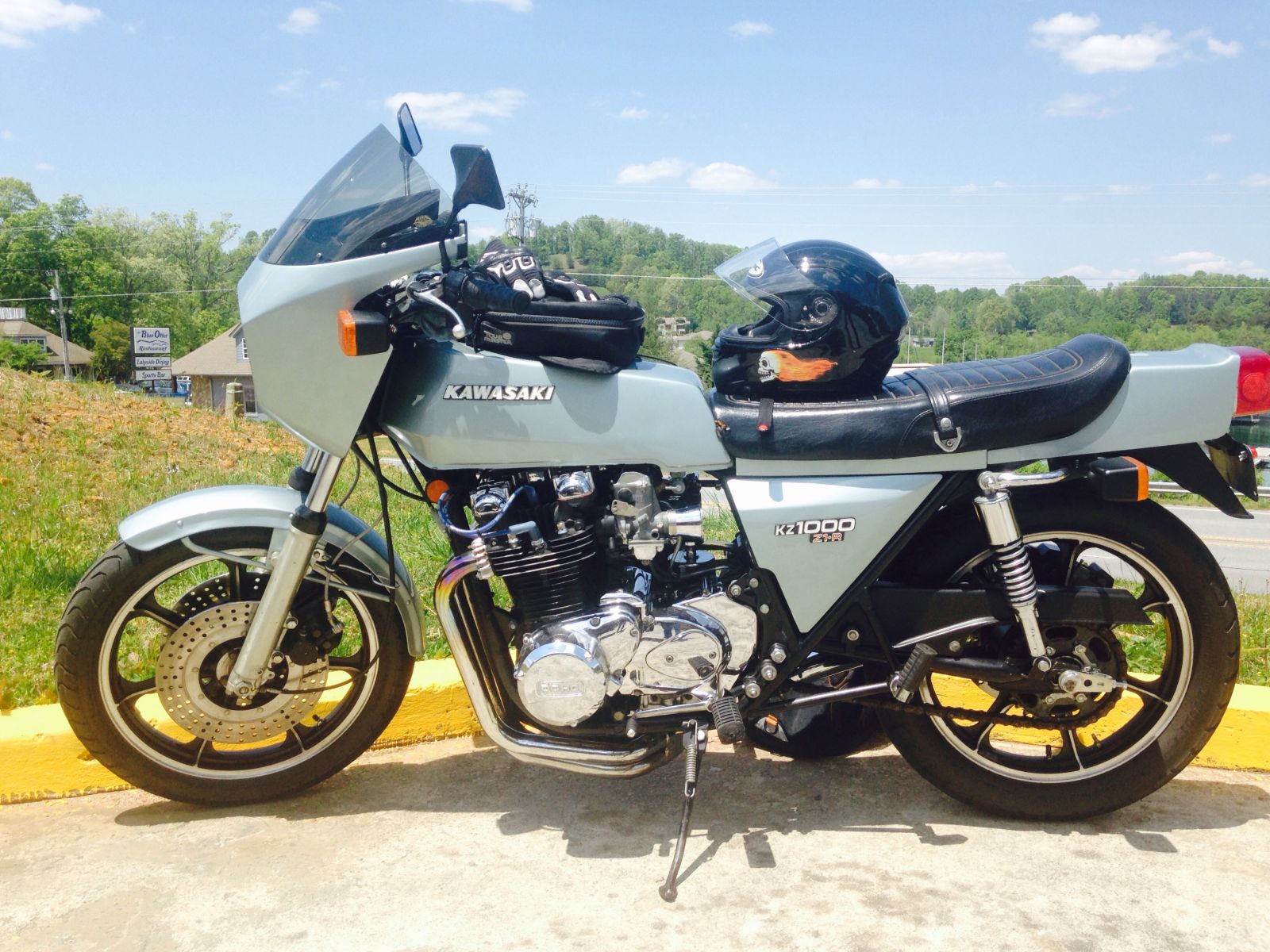

Very nice 78 z1r....
I have just gotten one for my self. Wish it had come with the larger tank tho. I had to refuel every 80 miles.
