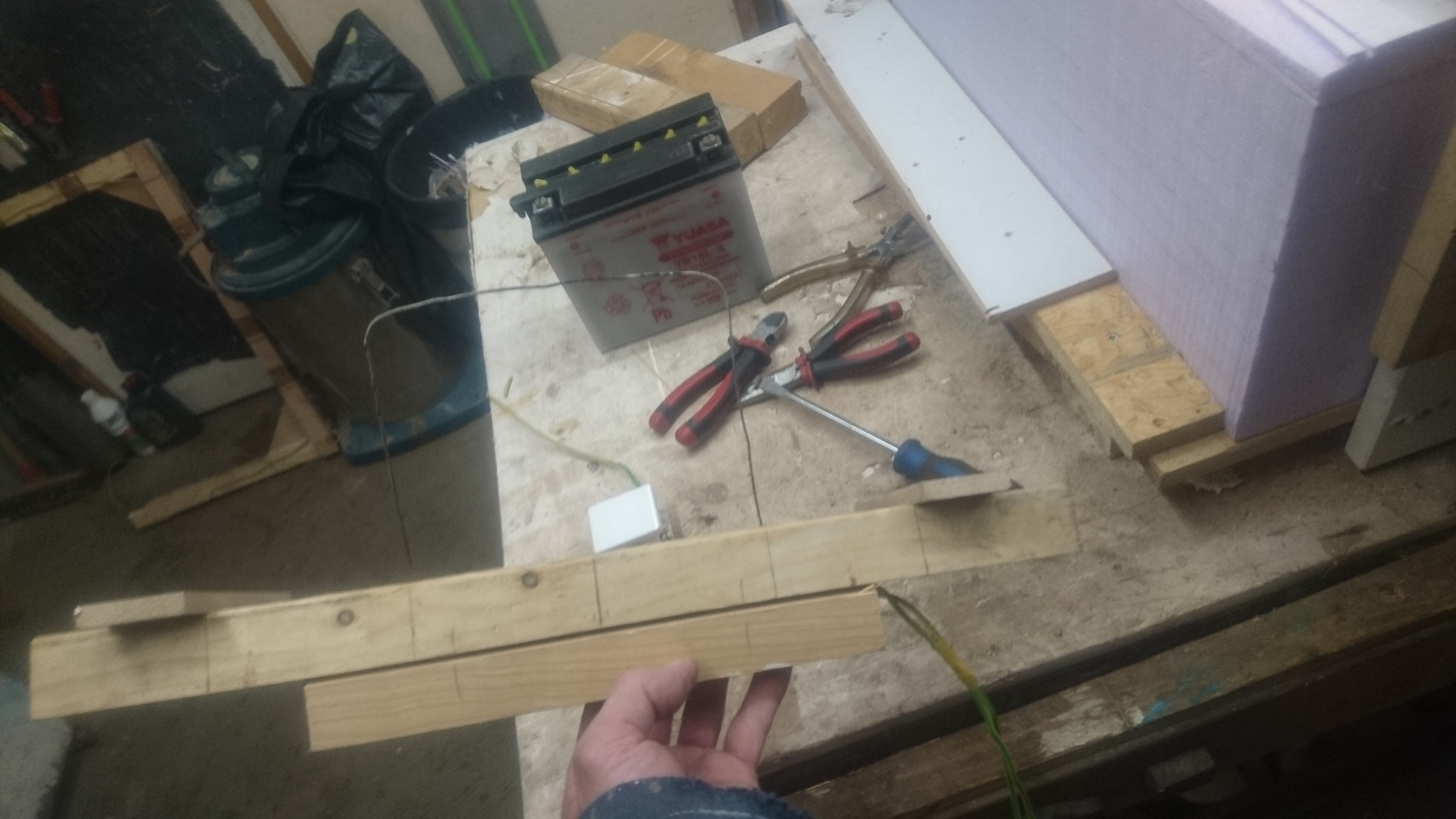

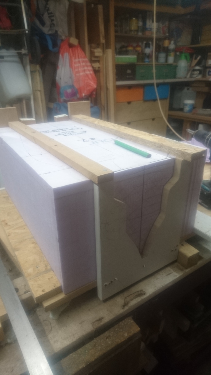

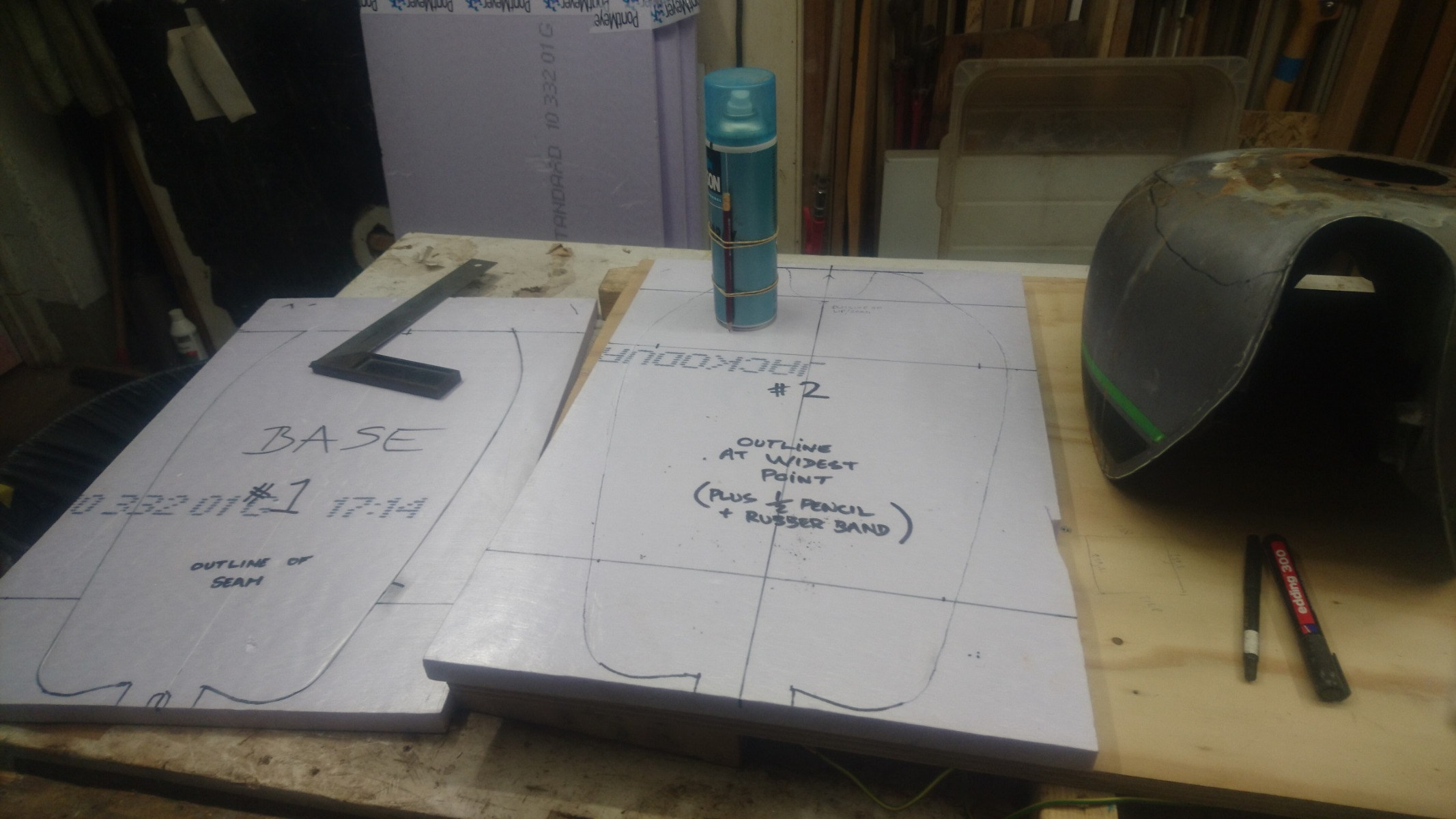

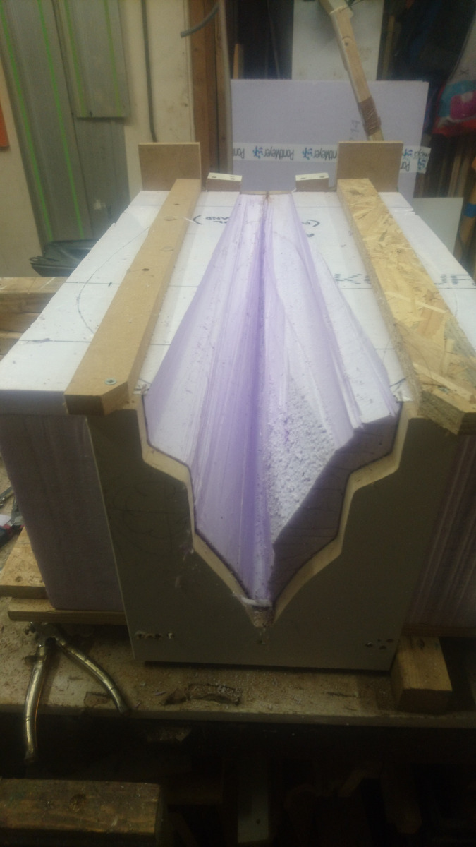

Here are a few pictures of whats been going on so far. I built a hotwire cutter on the worktable and sized the plates of foam;
I marked out the tank shape on the top plate and on the bottom plate;
Glued up all the plates into a block of the right height (more or less) and squared it off;

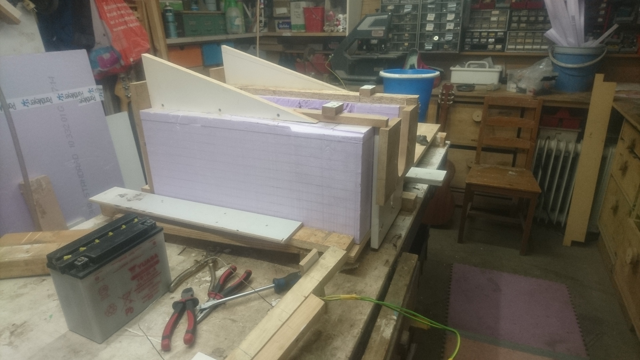

Cutting the tunnel was a bit of a challenge. Its not a straight line from back to front.It sits at three different angles.I took the line at the middle of the tunnel as the base line and cut some templates for the front and back'
This allowed me to cut a channel following the basic shape of the original. I made a different hotwire cutter for this part;

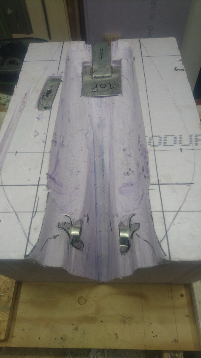

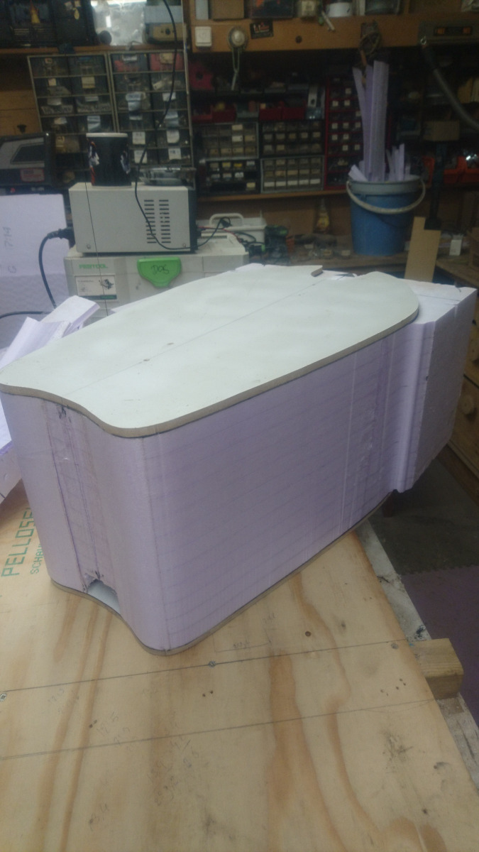

The channel/tunnel widens out towards the back and I wasn't able to do this bit with either of my hotwires. They are both tensioned between two points. I needed a free standing wire. It needed to be thin enough to allow the resistance to create heat but thick enough to hold a shape. This was trickey. I managed it, though the wire still moved around a bit too much and gave a very wobbley cut;
An addition to the template allowed a shallow to deep cut;

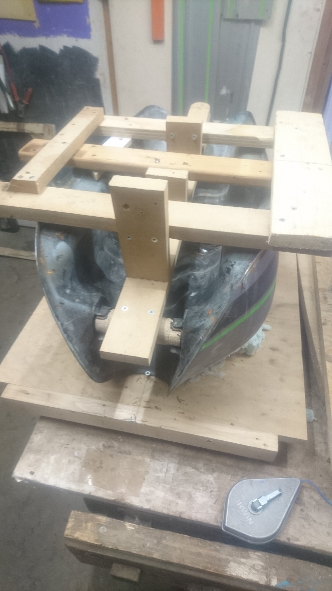

Next was the hardware (Front ears,tailpiece and fuel tap mount). Positioning this properly is very important. Everything has to be in the right place in relation to each other.If its all a little bit forward or a little bit back,it shouldnt be a problem,so long as each bit is the proper distance and position from the other two bits as on the original. I hope this makes sense;
I made a frame on the original tank,connecting all three points together;
As the tank is such a rounded shape,I've taken all the measurements from the bottom of the seam/flange/lip on the bottom of the tank. This is the only straight line on the tank and I've used it as a constant. As a zero point. I wont be able to mold the seam on the final model so I will probably shave 6 or 7mm off the bottom of the foam when all the shaping is finished.Its a lot easier than subtracting the mms for every measurement. Less chance of messing it up.

Thanks Mikaw,Though I have no idea if or how this is going to work out. I can make all the molds and templates I want for the hot-wire but when I've got as far as I can with that,then its down freehand work to get the shape right. I'm reasonably confidant that I can do a reasonable job but..... we will see!
So the basic tunnel is done for now.I will probably have to fiddle around with it to get it to fit right.I need to sit it on the frame and see what the clearance is like.But for now it will do. This was the most awkward part to measure and cut. The reason I did it first. Also,easier to do with a square block of foam. If I cut the profile first,it would have been a bugger to set up for cutting the tunnel.

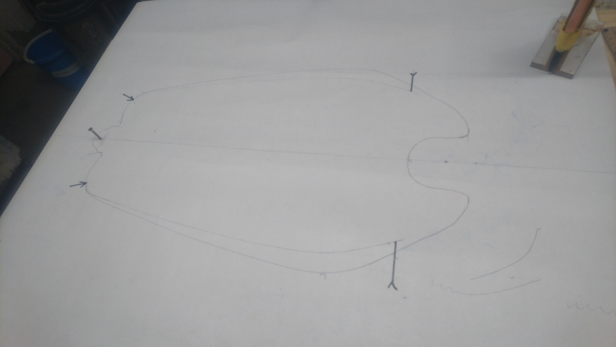

The next is the circumference.The outside lines.Going up from the bottom seam,the tank bulges out then comes in again on the top of the tank. So I'll mark two lines.The first will be the seam itself,all the way around as far as I can,(as it lifts up at the front and a bit at the back).The other line to mark is the tank at the widest part. The bulge.To do this I made a pen holder at 90 degrees to the table top;
So the inner line is the seam.This is just for reference for now but you can see how much the tank bulges out. I will cut two MDF templates following the outside line which I will glue to the top and bottom of the foam block (making sure to keep all the center lines lined up) Then I'll go at it with the hot-wire. Which should give me the outside shape of the tank at its widest.Later I will re-mark the seam line and this will give me a line to carve/scrape/sand into.

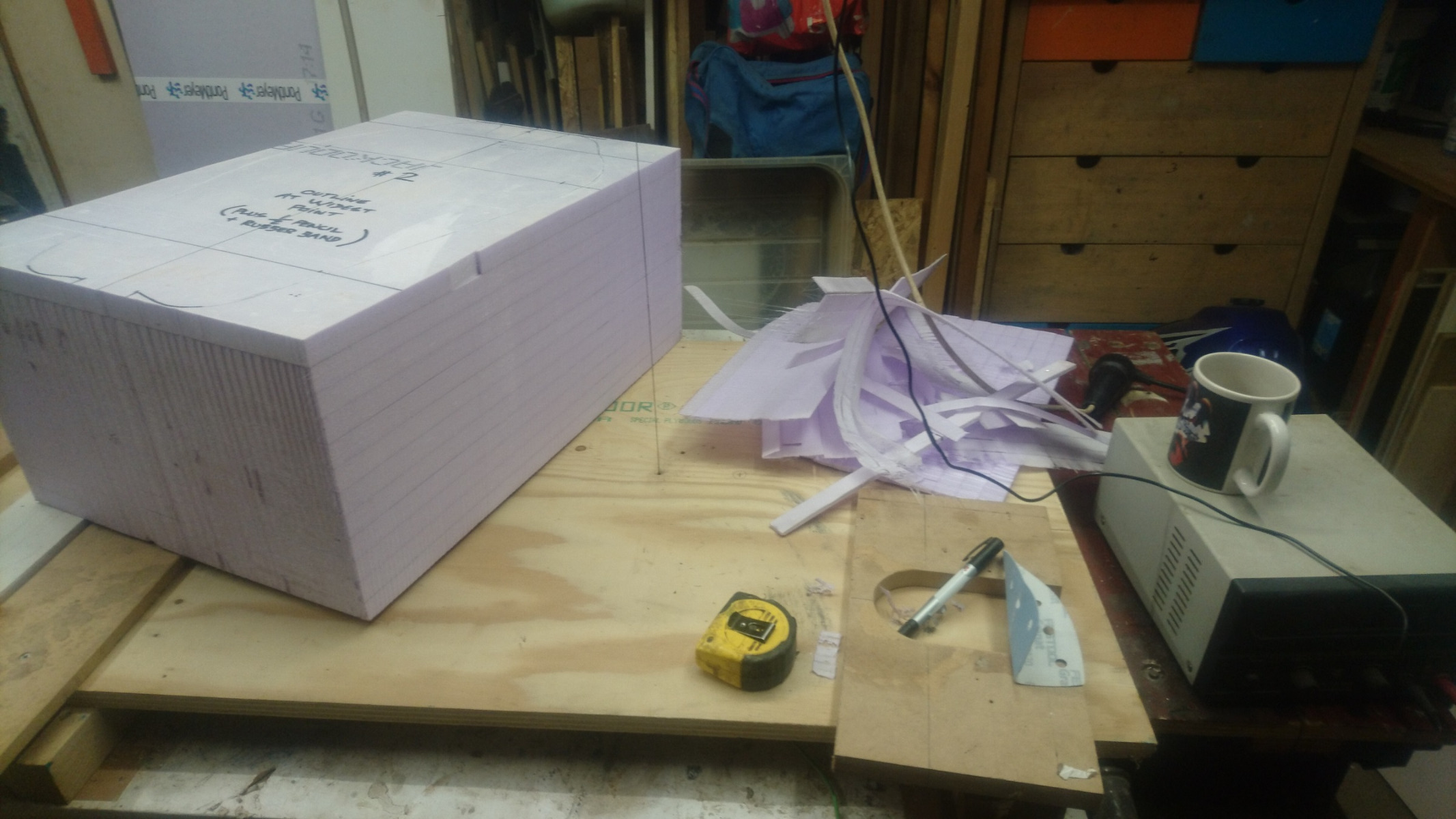

New templates for the outside (circumference) line glued to the top and bottom of the foam block;

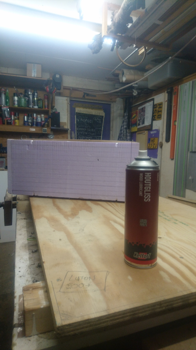

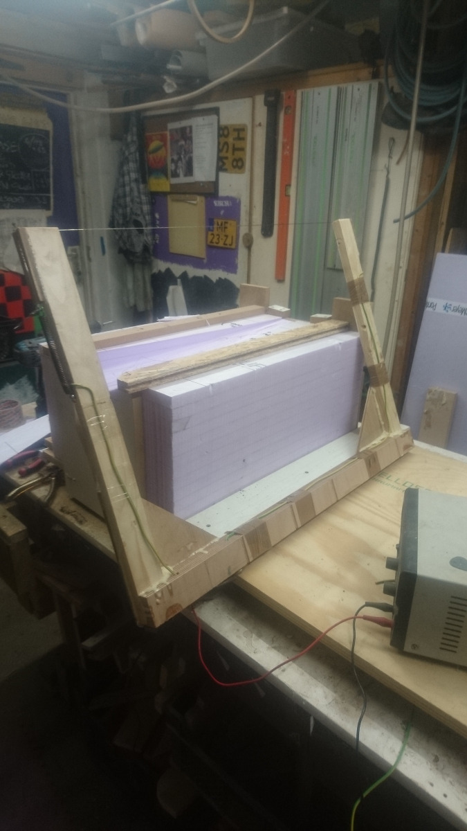

A handy spray for giving a bit of slip to the worktop and allow the foam block to glide by the hot-wire a bit easier;
It goes very slowly as the power pack doesn't put enough heat through the wire;

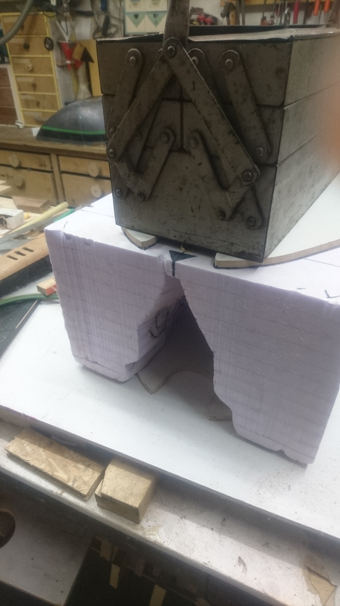

But taking some time, it comes out well;
Side by side the foam looks a lot bigger than the original tank but in reality the front to back dimension of the foam is the same as the tank-minus-the seam at either end and the width is the same as the original-plus-half the thickness of the pen that I used to scribe the line.(maybe 3mm max). Happy with the result so far.
