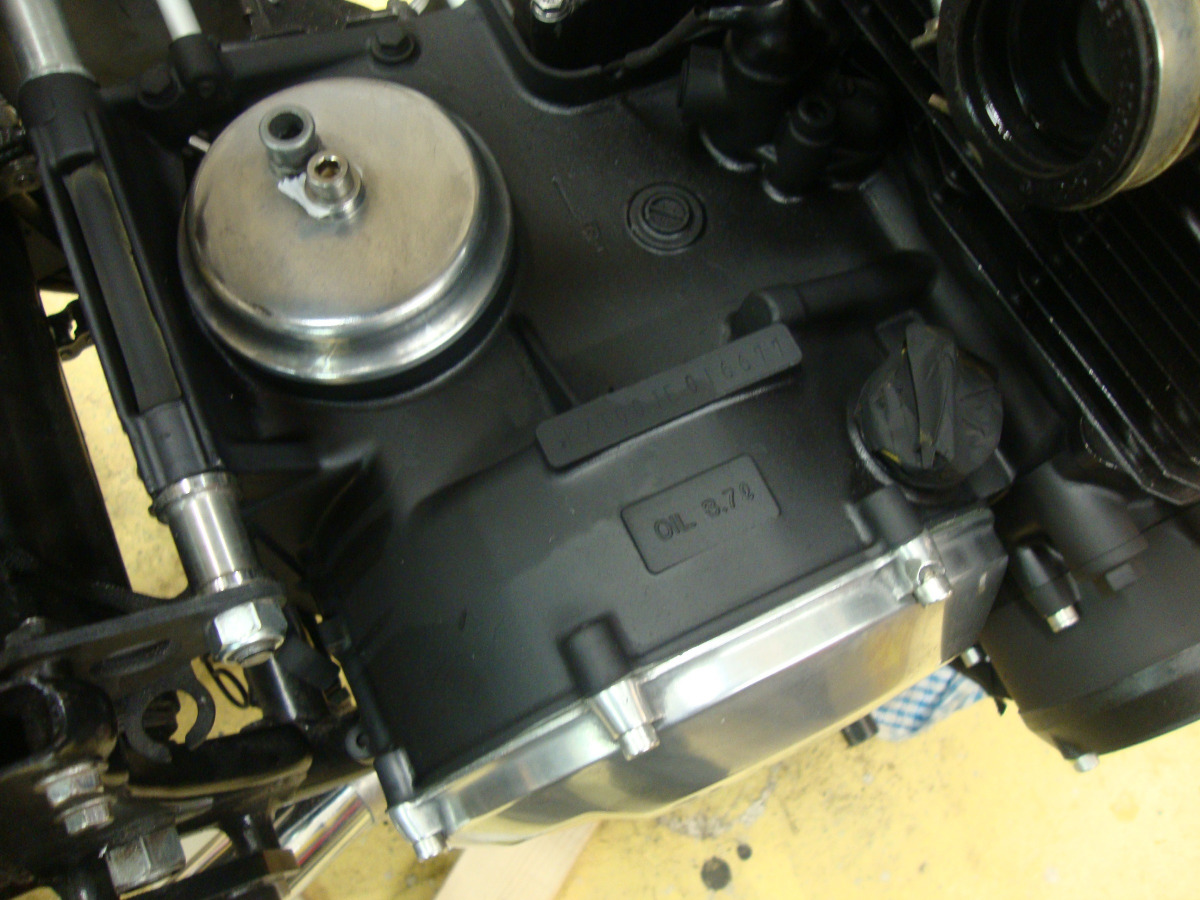

For now Im concentrating on scrubbing it up for the show.I got a new brake line for the left caliper and fitted that today. Then I had a go at the engine paint.
This is how it looked after the carb overflowed.
and this is after a spray with some heat paint. Of course it wasnt a match to the original PJ1 that I used.(That would be too easy)Its a lot more grey but it is what it is and hopefully itll do for the show.
