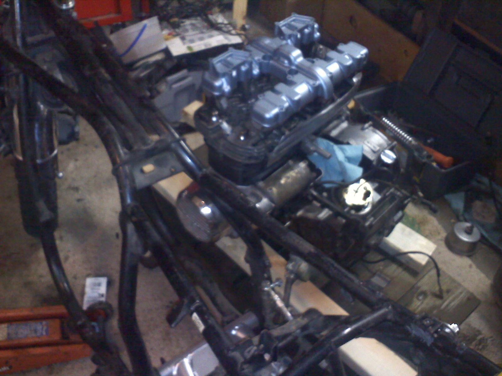

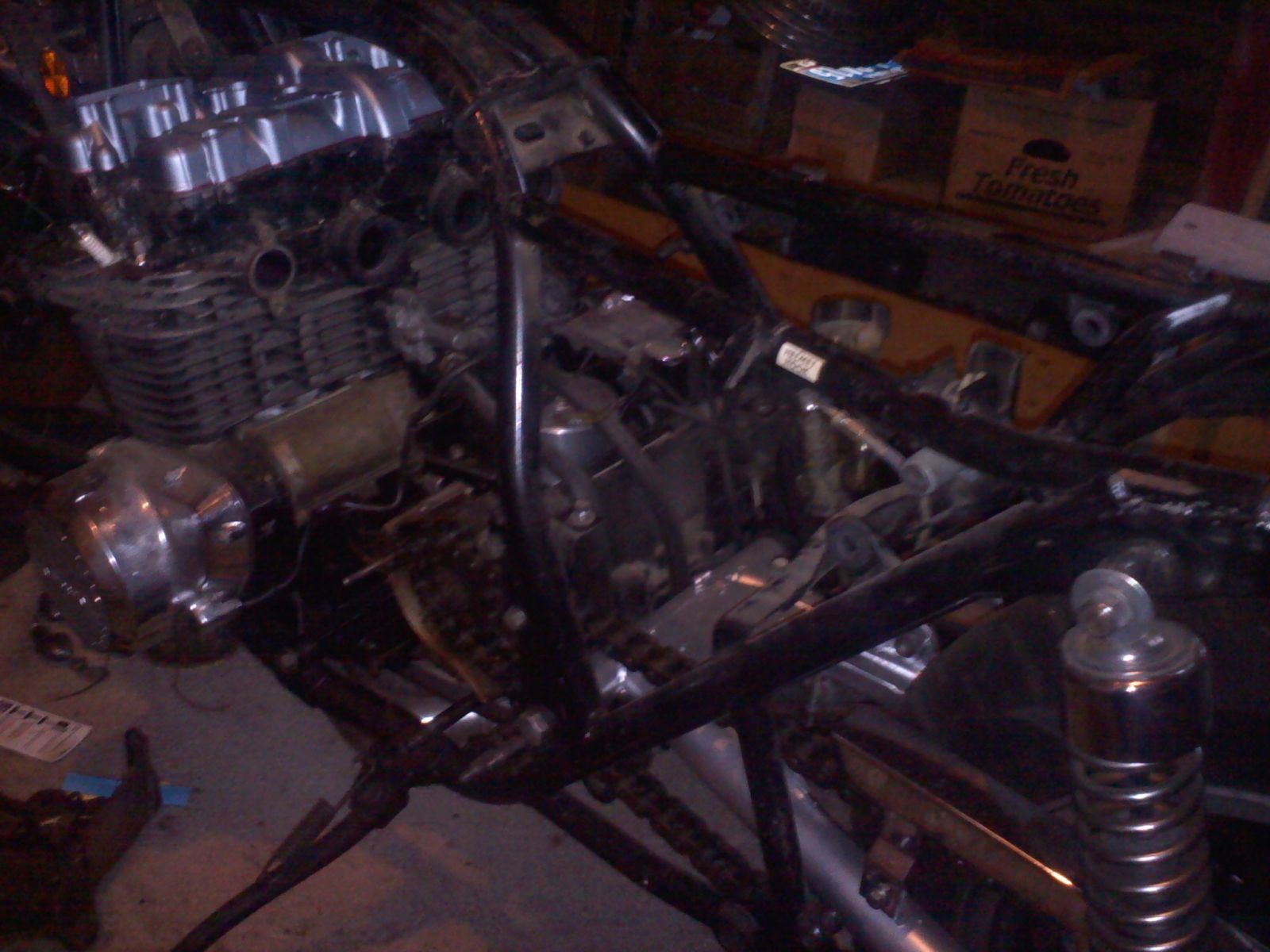

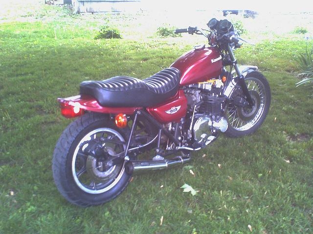

Its been a long time since I posted fora project. Im starting a new one today.
I have a G model and want to save it and not cut it up,so I got with KZ10006 and working on getting a 80 B model frame. If I remember correctly,they share the same components? Some one correct me if Im wrong,please.
Anyway Ill post pics tomorrow of my progress.
Well this is where I started anyway.
1st pic was stage 1
2nd stage 2
???? on stage3. Got a good idea of what I want. Ramtough63 is to do my paint(we have killer idea),and hopefully I can get a swing arm from Les. Wish me luck!!

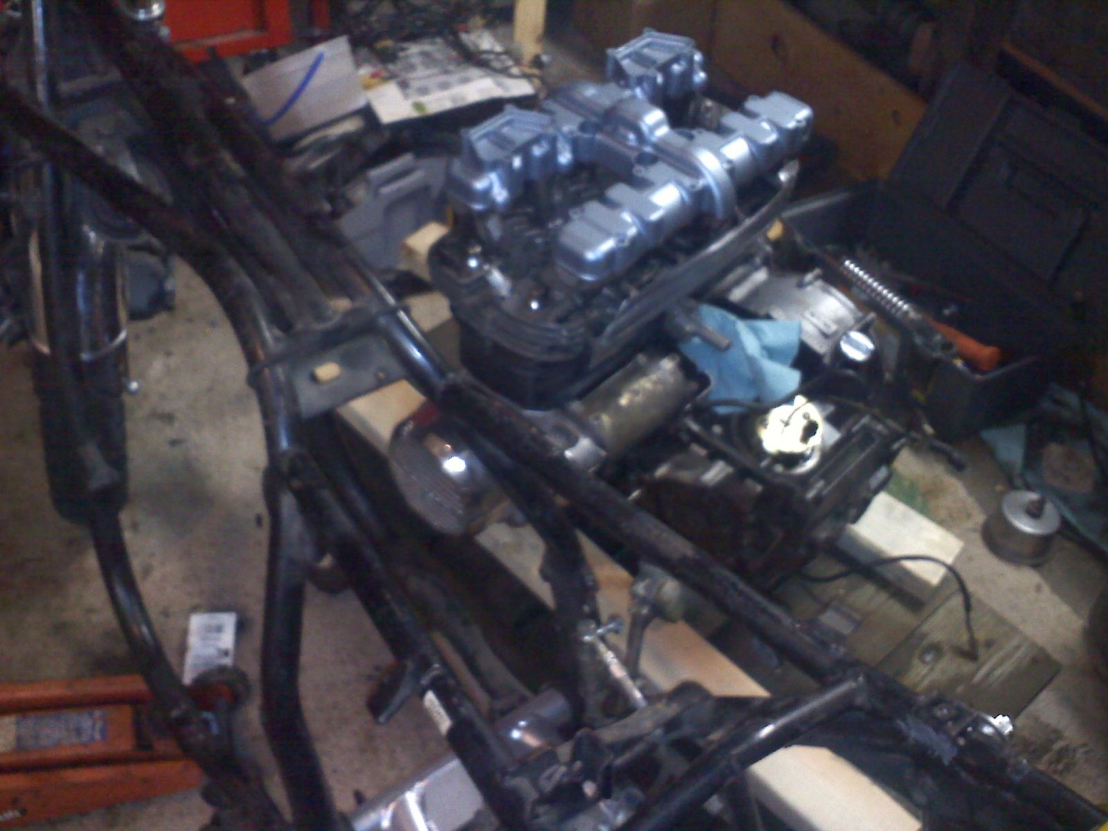

@ Patton,thanks for link.The only thing i found different was the batt box. As far as part # anyway. Did find out that the G shares the same cases as the Z1D. I thought that was very interesting. If any one else wants to chime in, please do so.
@ Les, thanks and do appreciate it. I dont think Ill run the mono,the batt box sets right in the way of the shock mounts on both frames. Yours looks to be mounted a little higher up. I could be wrong,just lookin at pics of it.
Ill give you a buzz this weekend and well discuss it.
BTW heres the progress so far,not much with workin and family.
