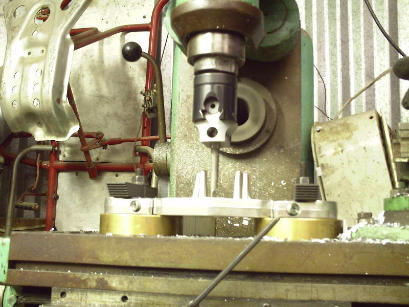

- Posts: 7446
- Thanks: 798
Re: Joe's '78 kz1000 build
17 Jan 2011 07:24
here is the upper triple bolted down getting the steering stem boss that was underneath cut off.
i ended up cutting 5.5 mm off which is what it took to match the top of the kz stem.
then i had to bore the steering stem hole out to match the kz stem,which was bigger than the zx hole.
