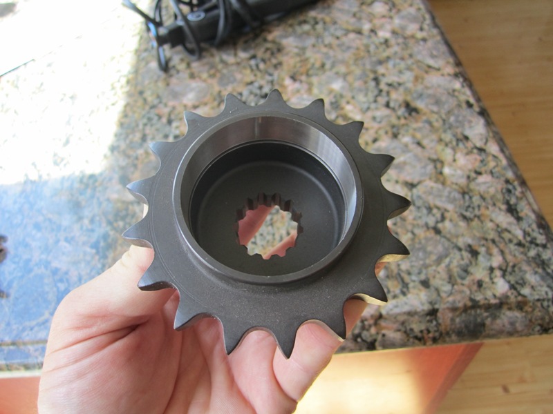

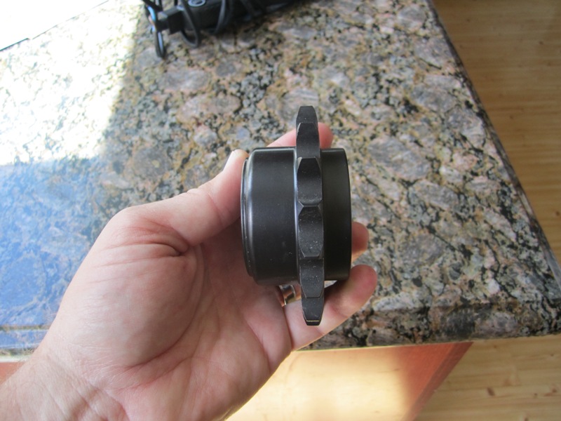

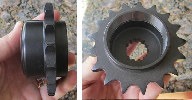

Thats good to know guys. I got my sprocket earlier this week, but I haven't had any time to take and post pics of it until now. Isn't it just beautiful

Very nice. How thick is the spline wall?

Likely already mentioned somewhere among the past 50 pages, but could use a reminder as to whether outboard support is planned for the counter shaft sprocket.

Harvey, I'll have to get back to you on that. The sprocket is at home, and I'm not. I would hope that it is the same thickness as a stock sprocket, or it might throw my offset measurement off.
Patton, you mean this thing right here?
Yeah, I've got it covered, black anodized and everything

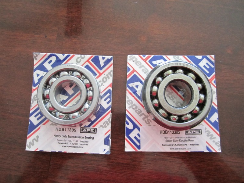

I made two phone calls yesterday, one to A.P.E., and one to Z1E. The call to A.P.E. was to order tranny bearings. I was very suprised to have them show up this morning :woohoo:
