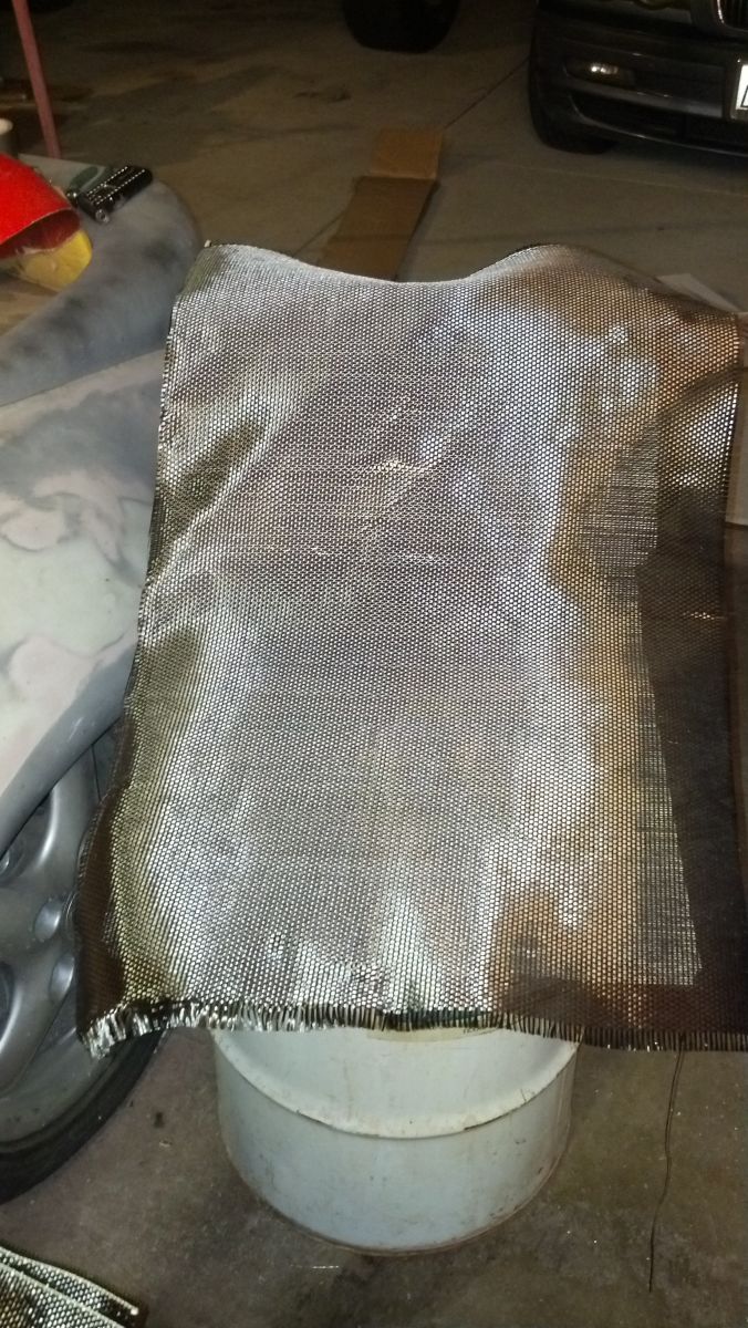

porchev914 wrote: I know its been painful to watch (Leon), but I did get a little something made last night. One of the things I needed to do before paint was some little tabs for an undertail shield panel. The only thing is, I don't have the panel made yet. So, thats what I did last nightI started by using spray adhesive to glue card stock (file folders work awesome, are cheap and plentiful) to the bottom of the subframe, so that I have something flat that follows the contour of the tubes. Then I covered the folders with packaging tape.
Then I laid the the first layer of carbon cloth over the "mould"
I mixed up some resin, coated the first layer of cloth,, then added 3 more layers for a total of 4. It doesn't need to be super strong, just keep the crud out from under the seat and tail. After the last layer it looked like this:
And there you have it, thats how you make a quick and dirty carbon fiber subframe panel.
I love the "mould". It's extra funny cause it worked... :laugh:

I didn't have the luxury of making a proper mold for a one off part, and I knew card stock and packaging tape would work (mostly) for a one off. It's not as clean as any of my other parts, but it doesn't need to be. It's job is to keep road crud out of my pretty aluminum battery box and general under seat area. It'll only suck compared to the sidecovers, tail and tank
