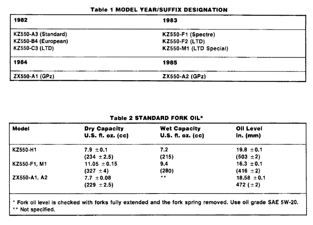

Hey
Got a kz550 spectre too. What is the fork Oil capacity for one of these guys? Cant Seem to find it anywhere.
Thanks - Peter

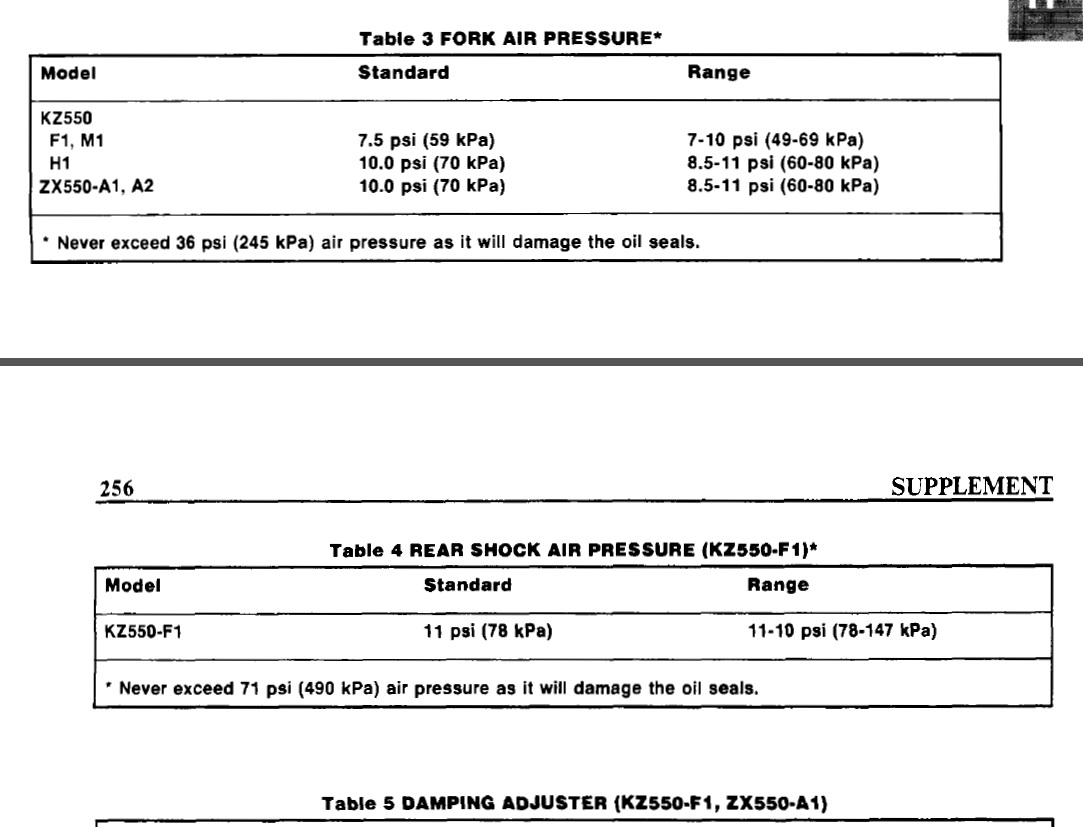

Ptl1987 wrote: Hey
Thanks - Peter
Patton wrote: See following links courtesy of KZr Member loudhvx ---
General
home.comcast.net/~loudgpz/GPZweb/index.html#home
Service manuals
home.comcast.net/~loudgpz/GPZweb/Mnls/Mnls.html
Here's an example of information that includes the 1983 kz550-f1 spectre, which is found in:
home.comcast.net/~loudgpz/GPZweb/Mnls/Kz...9to85_ThirdParty.pdf .
Good Fortune! :)
