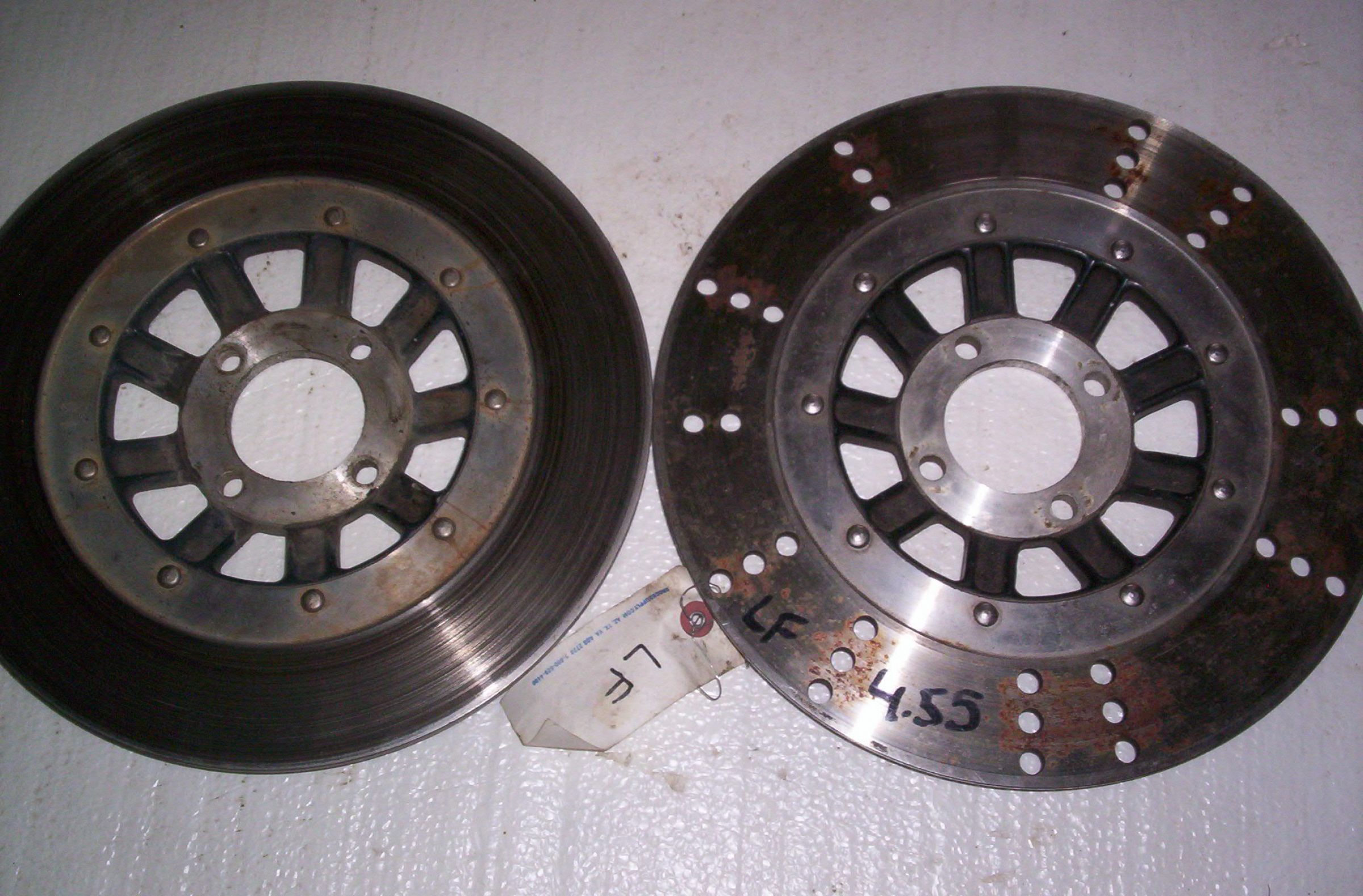

Just took a rough measurement of the rotor bolt patten and it also looks smaller on the kz200. I measured 1 3/4 inches (4.445cm) center to center. While the 750 is pattern looks closer to 6cm....

If an adapter plate was made, would the 750 brake work with the thinner rotor? I recall a video on youtube where a guy put just a kz650 brake caliper on with an adapter and it seemed to work. Actually here it is.
Anyone know if it would it work on a the thinner rotor. I don't need to pull any stoppies, I just want to stop

I put on thinner rotors. They're almost 1/2 the weight with the holes drilled in them. The calipers had to expand a little more but work great.

Awesome! I'm glad to see it worked out for you. Looks like that's what i'll be doing with my 200. Maybe I'll take a chance on a kz305 rotor because it's drilled too.

Right, if it wasn't my 200 I would be hesitant to change anything about the front brake unless I knew what I was doing. For a bike that maxes out around 70 mph and is only going to cruise to the local coffee shop bike night on sunny days, I'm hoping it will be safe enough. I thought about using a drilled rotor from a 305 to dissipate some heat, but I'm starting to think the 200 pattern is unique, I don't think it will fit. Oh well,
