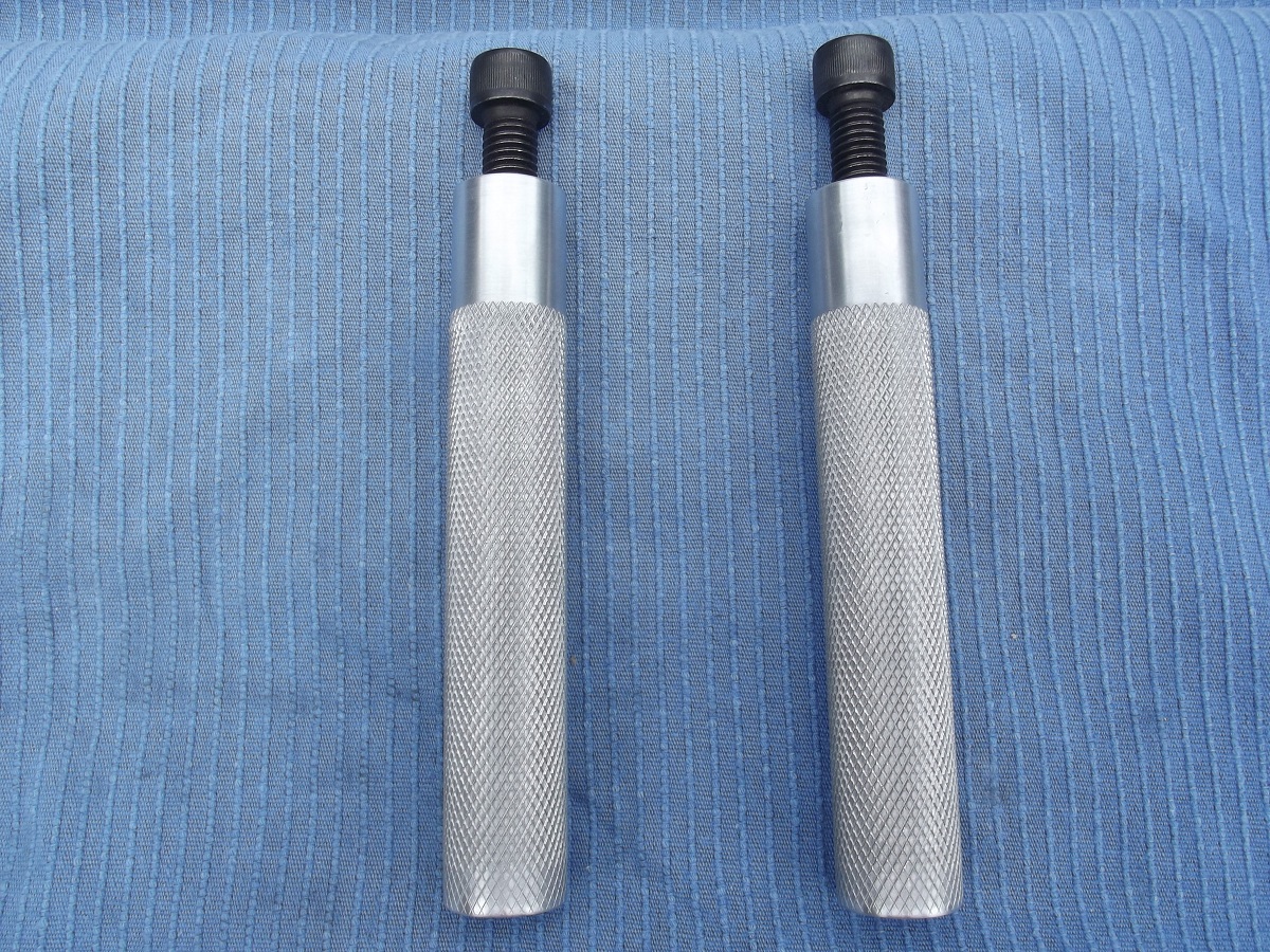

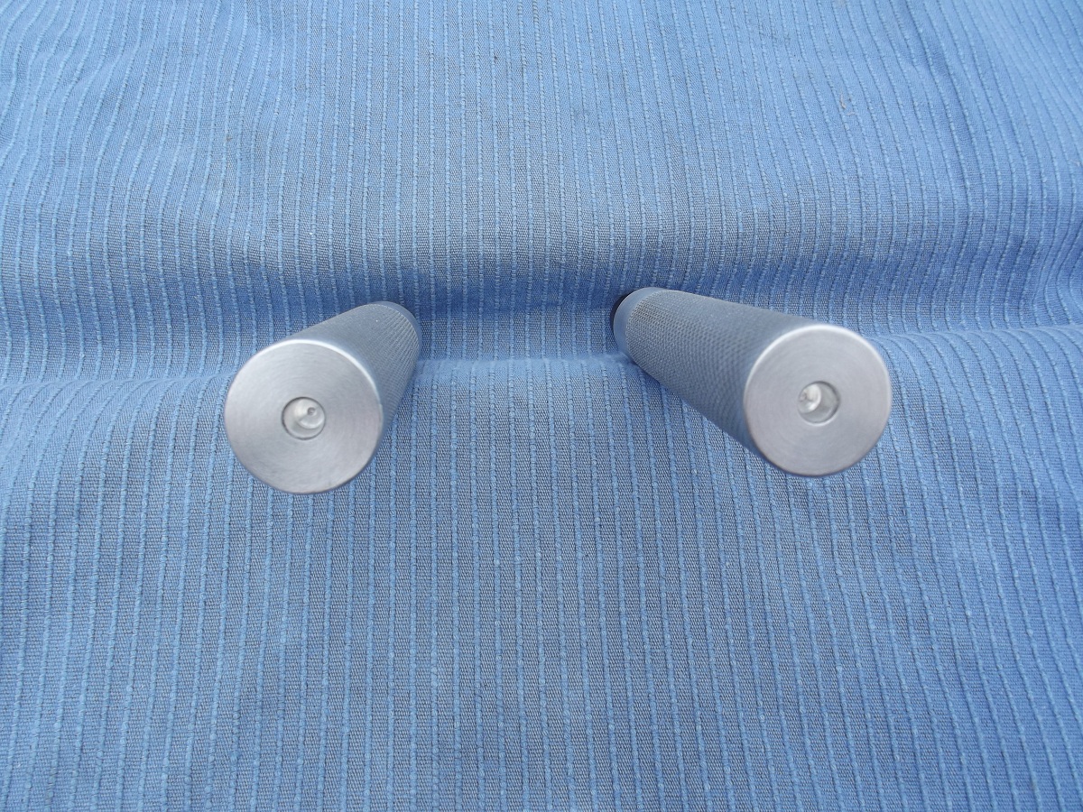

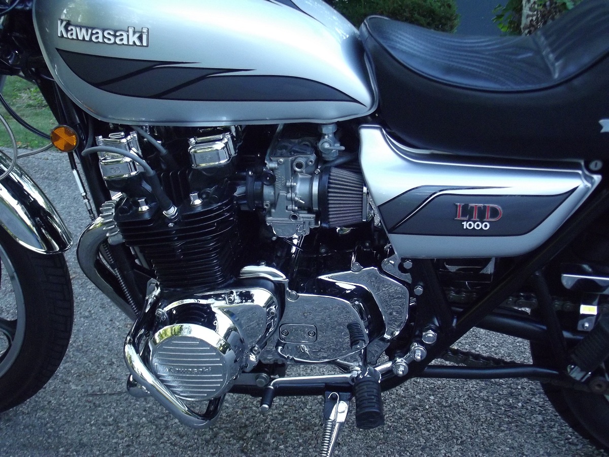

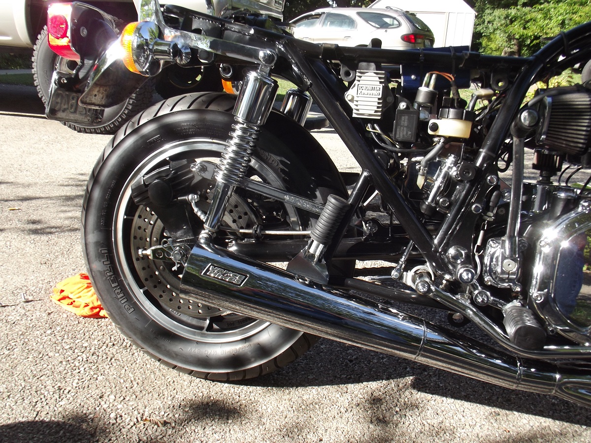

I don't know what a 90 Police frame looks like ,so I don't know if these pic's will give you any ideas, this is an 80 LTD 1000, ...Pete
The following user(s) said Thank You: Markovich

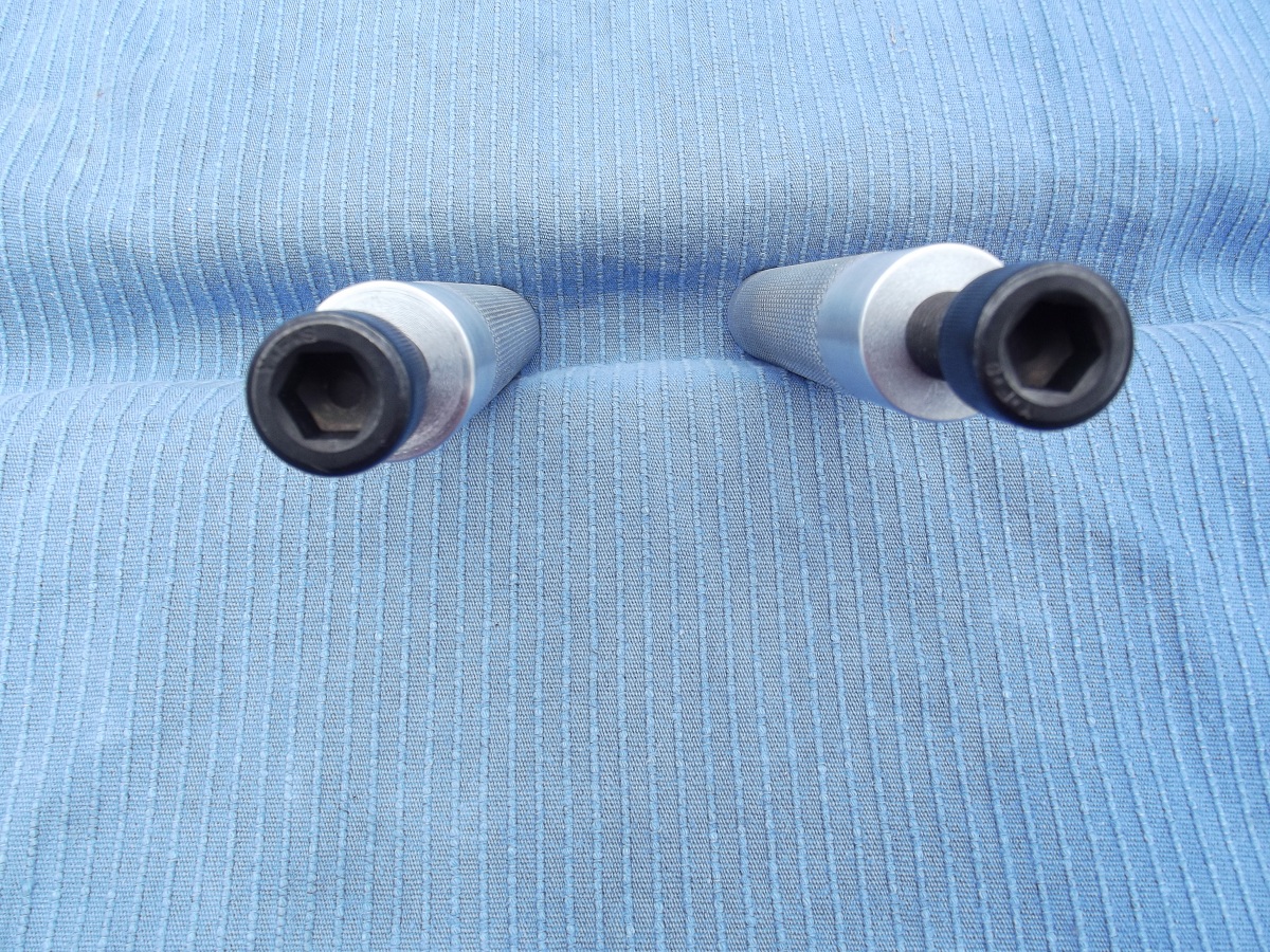

13 Jul 2014 11:23

Thanks, I grabbed the one on ebay. Not the cheapest I'm sure but one time purchase. Talked myself right into it.

Those are the one I got. I'm pretty sure that I can get them to work and look good. This forum and you all are great for us! Thanks again, Keith
