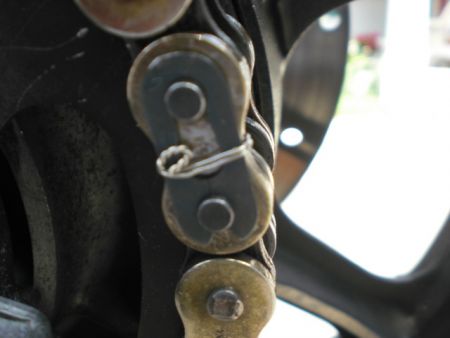

- Posts: 7442
Re: Too Long of Chain!
23 Feb 2012 13:52 - 23 Feb 2012 13:53
yessir slide the axle all the way forward and put one end of the chain on the rear sprocket so it will hold it on.
then fold the chain over right where it meets the end and then make sure everything is good and grind the ends off and use a punch to separate the link,and a chisel may be needed to get the plate off.
then put your masterlink on.
you may need to use a c-clamp or vise grips to squeeze the link back together and put the circlip back on.
a wrap of safety wire helps to makes sure the clip can't come off.
hth,
hth,

- badrhino
- Posts: 554
- Thanks: 6
23 Feb 2012 13:58
I never thought about putting safety wire around the link with the clip. :woohoo: Does that stay secure and not cause any problems?
