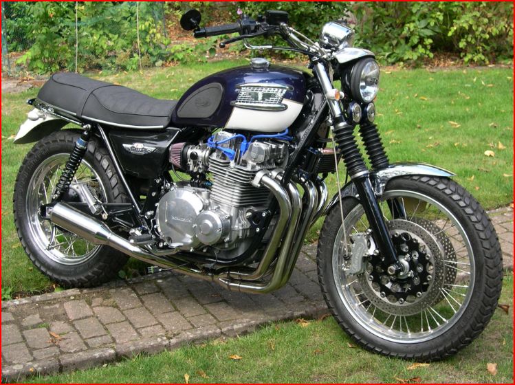

Just finished mine. GPZ1100 engine in a GPZ750 frame. The front engine mounts had to be modified. I kept the engine as low as possible so the valve cover would come off for valve adjustments. Also the engine is not quite centered about 1/8" set to the right, not noticible unless one was to measure it, it created no problems though. That was unavoidable due to the size and demensions of the engine. Just remember one change effects other components.

Thats awesome baldy. Gorgeous bike for sure.
