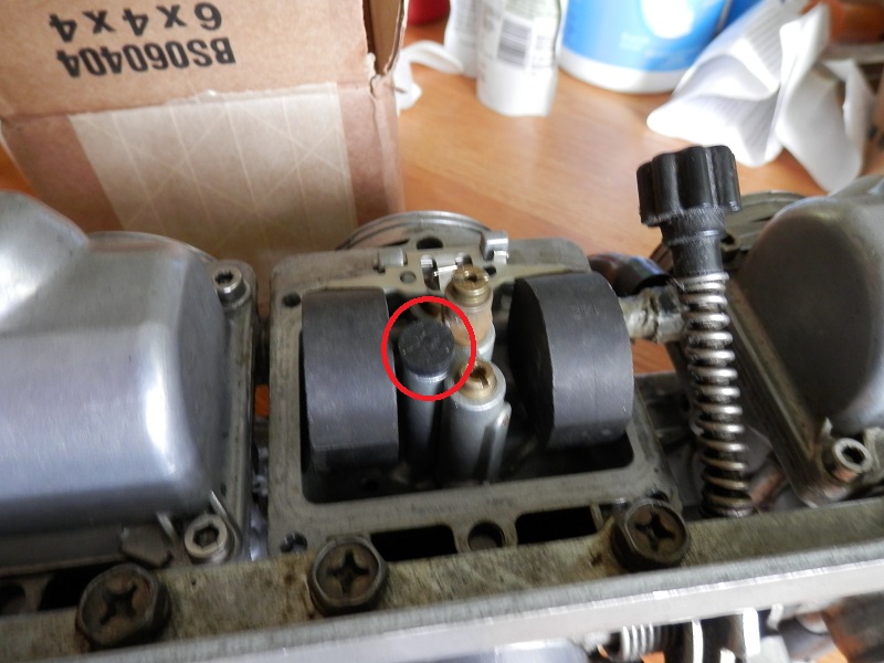

I got my delivery yesterday which was a couple of days earlier than expected and to my surprise none of the O rings worked - either to loose or to fat - but the caps did. So I pressed them in and rode around last night and some more today and they seem to be working just fine so I am sorry to say that they are not available for donation.
This is what I ordered
www.z1enterprises.com/ItemDetails.aspx?i...84%29&item=KL18-4689
$8.48 for a pack of 4
Unfortunately it looks like Z1 Enterprises are out of stock though ou might be able to get them from a Suzuki dealer or some other supplier
Below is a photo I took yesterday evening. I'll give them a few weeks and if they continue to work out I'll probably post the information as it might be useful to others.

Ultimately those suzuki GS pilot caps/plugs were not a success. They worked fine for a week and then this morning the bike started coughed sputtered and died and when I opened the carbs I found 3 out of the 4 caps had fallen out. And the spark plugs were wet with gas. - to much gas
Oh well. It was worth a try
Dug out the fat o rings put them on the old polyester caps and filed them down with Emory board until they fit.. hope it works

New coil came. Getting good spark, starts right up. Good power throughout, just won't idle smoothly. Can't tell of its a fuel or ignition issue.
Fuel wise, I noticed the carbs were missing the pilot plugs. Put those in. So maybe the small hole by the main jet that feeds the pilot system isn't completely clear?
The plugs I got were from a different bike, but I shaved them to fit.
