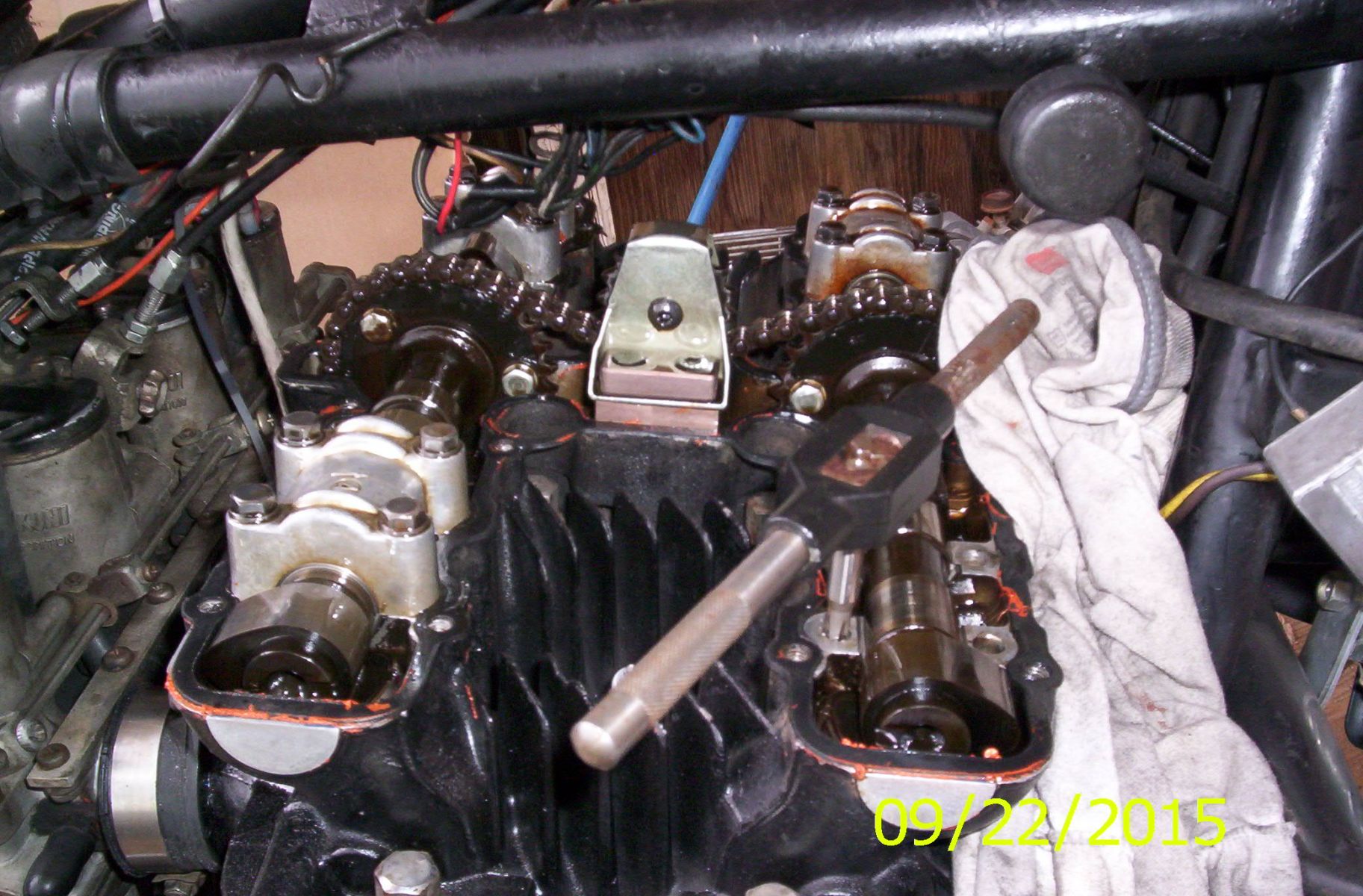

Some thing I learned is when Heli coiling a blind hole is get two kit's and take one of
the taps and grind about 3/8 inch off it and make a bottoming tap.
Use the unmodded tap to start the threads and when it bottoms out
use the modded tap to finish tapping the hole straight if not you'll have tapered
threads deeper in the hole.

Good point. I did that to one of my 6M taps when I chased the threads in a shallow hole.

In case you don't want to buy two taps and grind one,...they make taps for shallow holes that you can buy.
