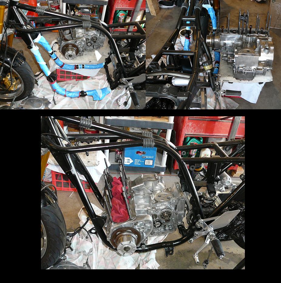

Here's how I did it by my self.
kzrider.com/forum/2-engine/489872-how-i-removed-my-engine
I'm planning on putting it back in tomorrow , in reverse with some improvements, so this is part 1
I wish I could trust taking out the exhaust studs, but I'm too far along in the game and I'm not looking for more trouble.
JD
JD
