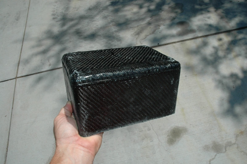

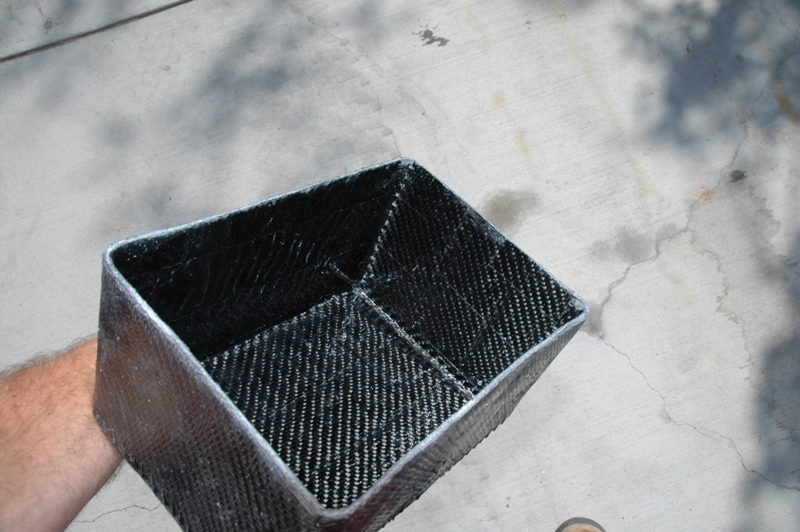

Here you are Mark, my failed attempt at a carbon fiber battery box :sick: I gotta warn you though, its rough looking. No smooth molds or vacuum bags, just down and dirty wet layup over a block of styrofoam

thanks for the pics. they tell me what i thought i would see. i didnt think it would look too smooth, which it does not.
good enough for a bat box though.

Nope, not smooth at all. The best way to get it smooth without sanding is to wait until the last coat of resin tacks up, then add another coat to fill in the fabric weave. The problem is the resin is heavy. Another solution would have been heat shrink tape; wrap the block after the layup and turn a heat gun on it to compress the laminate. That would have smoothed things out.

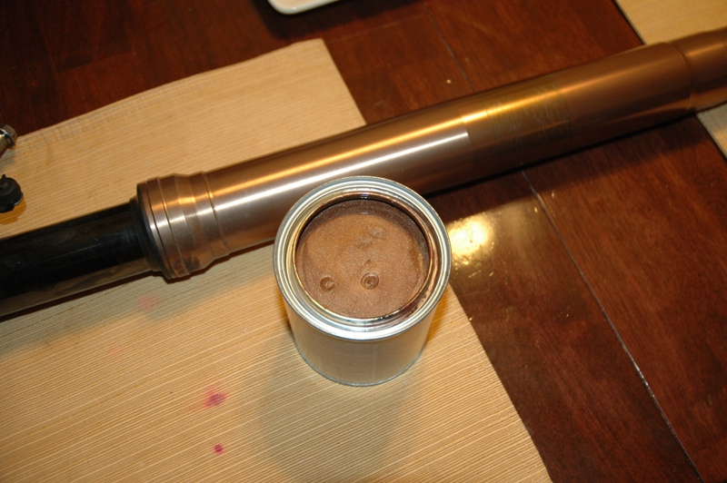

I stopped by the paint supply store with one of my fork legs and told the counter guy "I want some paint to match this color". After 10 minutes of solid arguing with the guy (he refused to help me, and kept telling me he couldn't match the color. Despite my assurance that it only needed to be close) a woman that worked there walked up with some color panels for me to browse. I was able to find a suitable match, and I really hope it will look good on the bike with the silver engine and everything else predominately black.
I also picked up some etching primer while I was there. Now I have an incentive to finish the fab work, since once its done, a complete painted frame is only a couple days away from that
