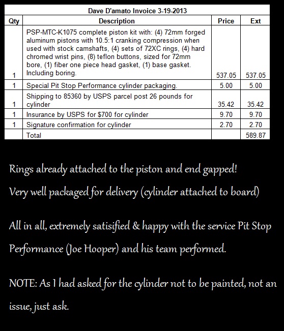

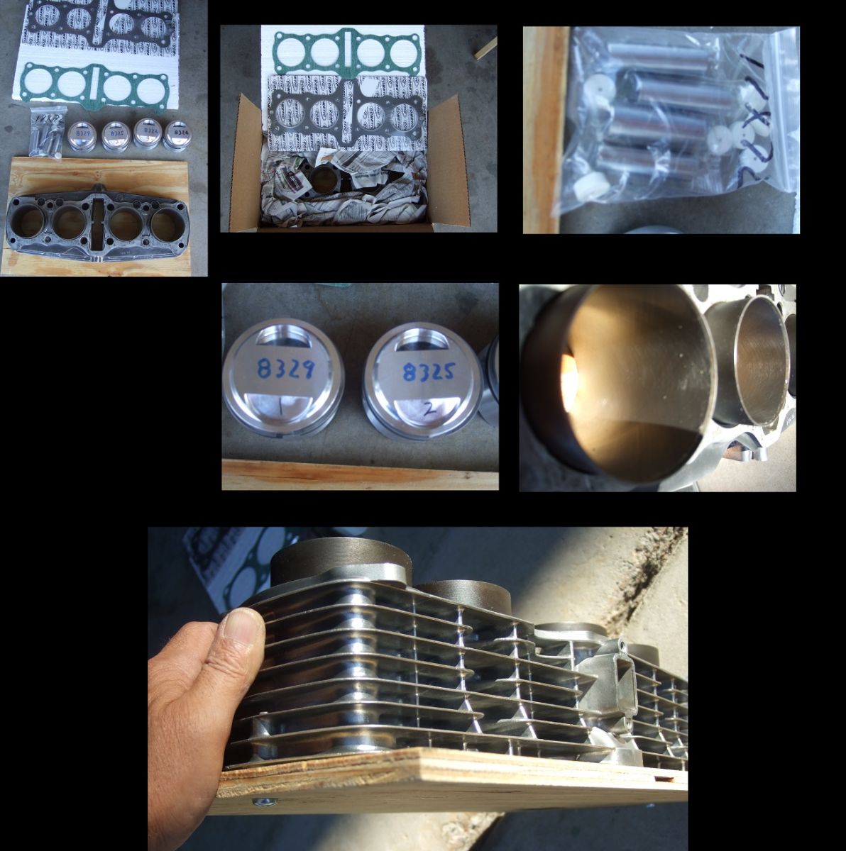

Pit Stop Performance: $580 Complete 1075cc MTC piston/ring kit, gaskets, wrist pins & teflon buttons... And this includes boring of the cylinder!!!! You just can't beat the price all....
I was very impressed with their packaging, cylinder bolted to plywood for protection... Overall, very pleased... Thanks Joe Hooper!

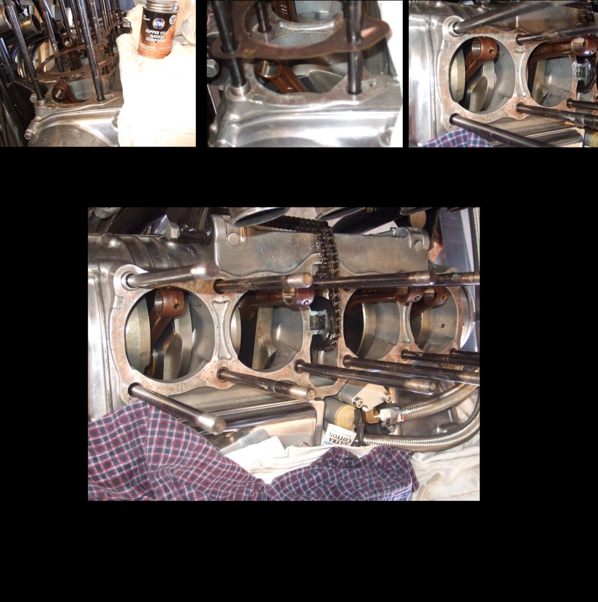

For those of you interested, the old base gasket came off cleanly due to during the installation, copper gasket spray... Magical Shit in a Can, is awesome!

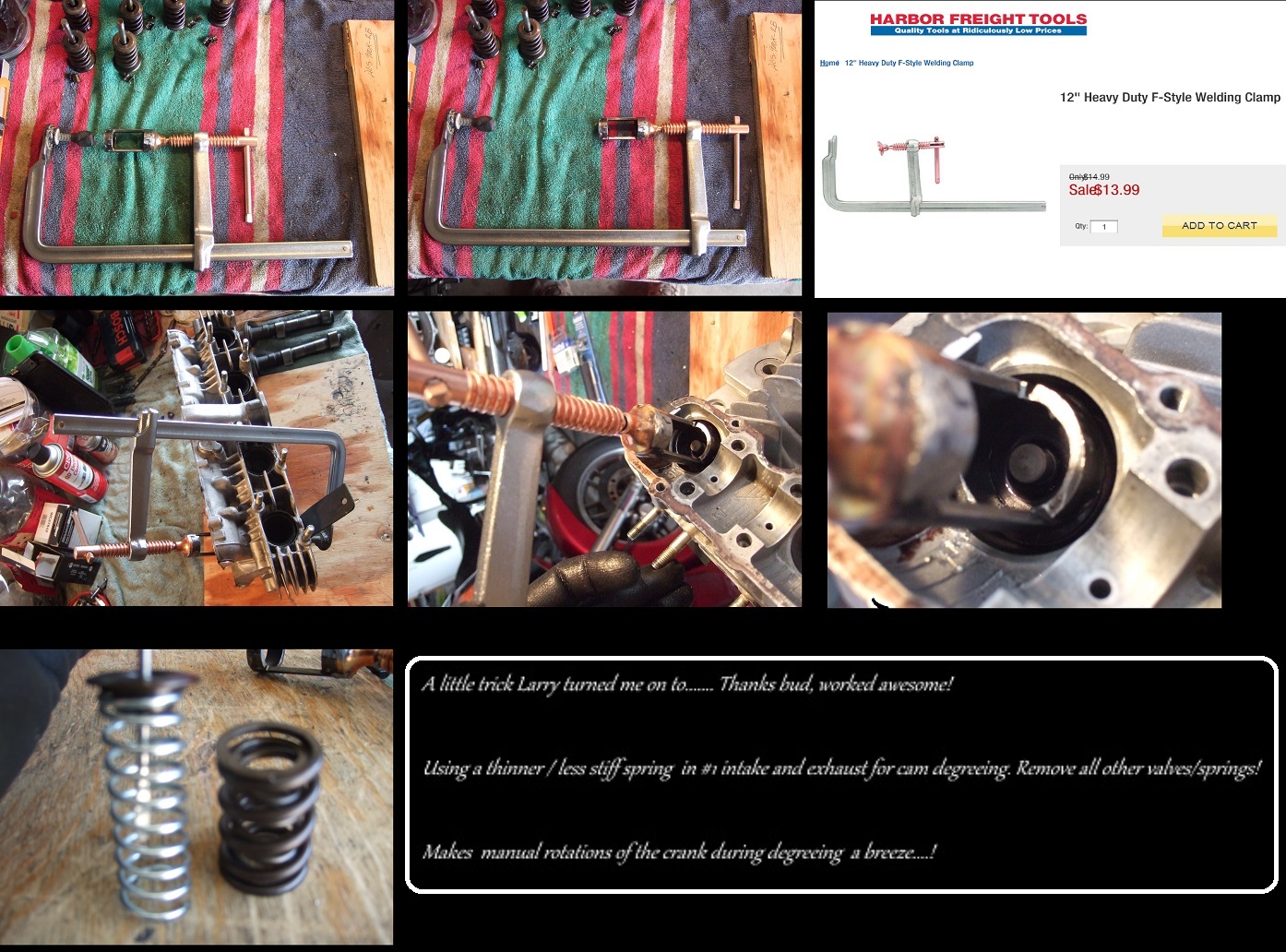

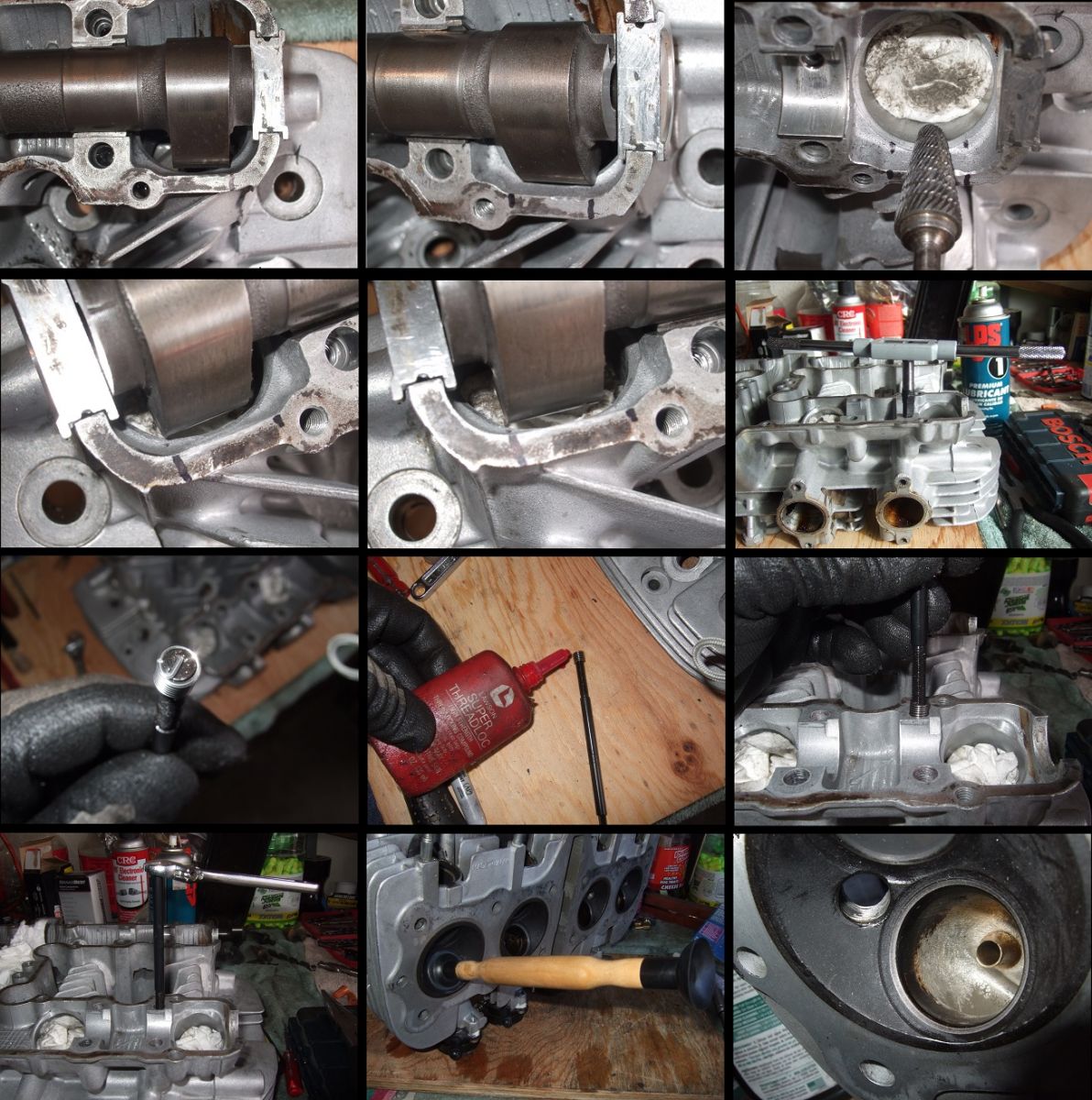

Now for the GPZ 1100 cams (measured cams for .375 lift) & APE 2 bolt 30 tooth sprockets (p# ACS900K-2B), you'll need to open up the journals a tad for 360 degree free rotations.
Home made valve tool.... $~ $15... Thanks you HFT!
NOTE Bottom left image: Less stiff spring in #1 intake / exhaust valves, makes degreeing a breeze! Thanks for the tip Larry!!!...
GPZ 1100 journal touch ups... Since the cam cap bolt threads where shit, inserted new Heli-Coil threads! Lapped the valve seats as well...

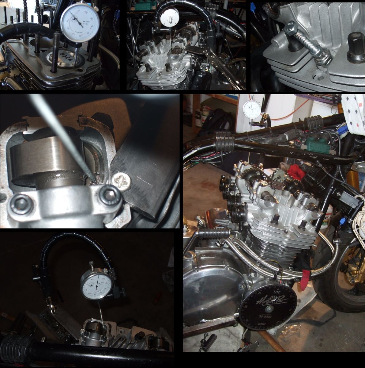

Cam degreeing... Head decking verified, Degreed Intakes @ 106 and exhausts @ 108.... Life (acceleration) will be good!
