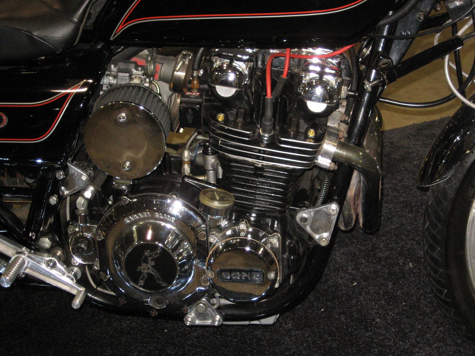

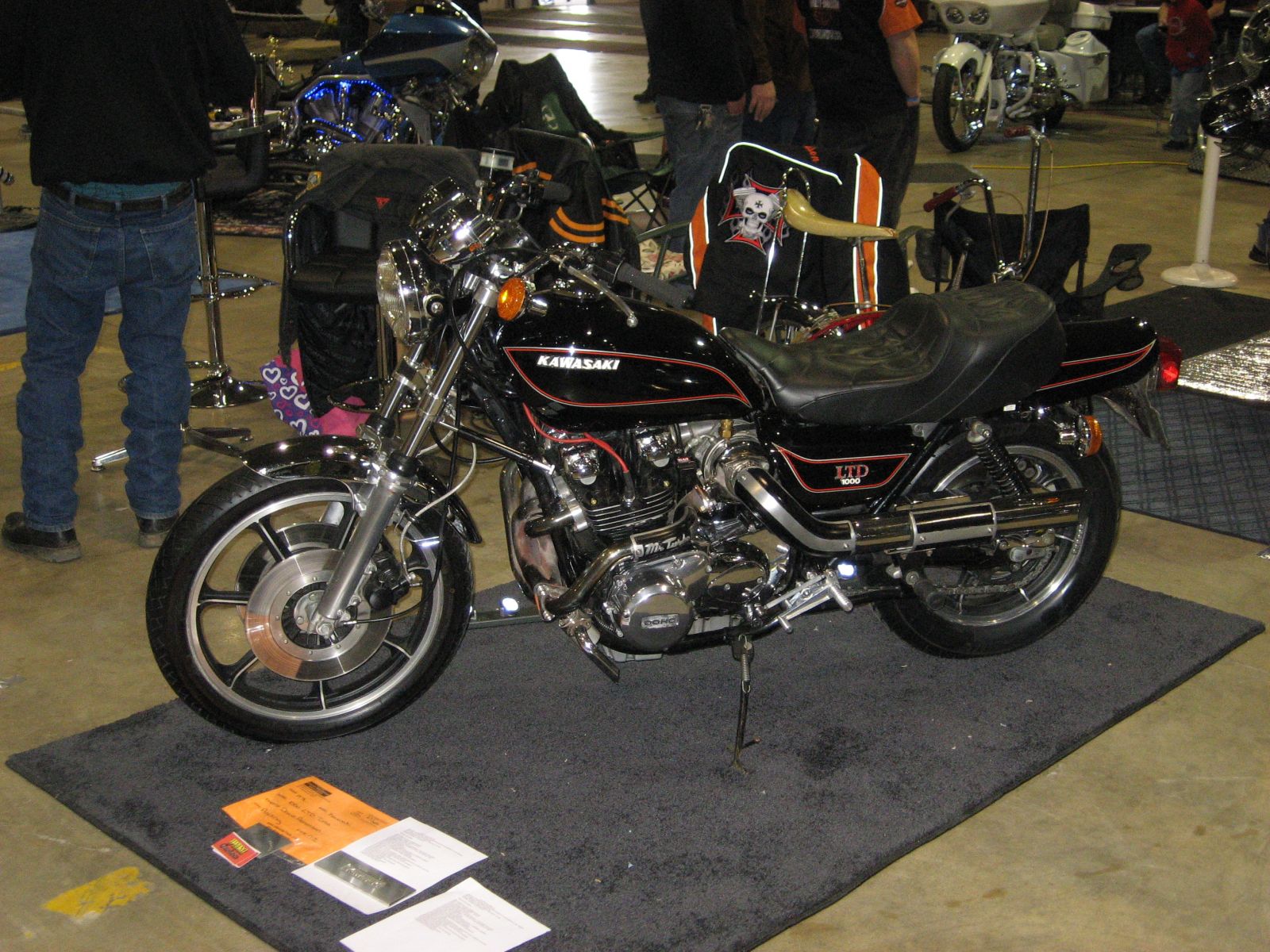

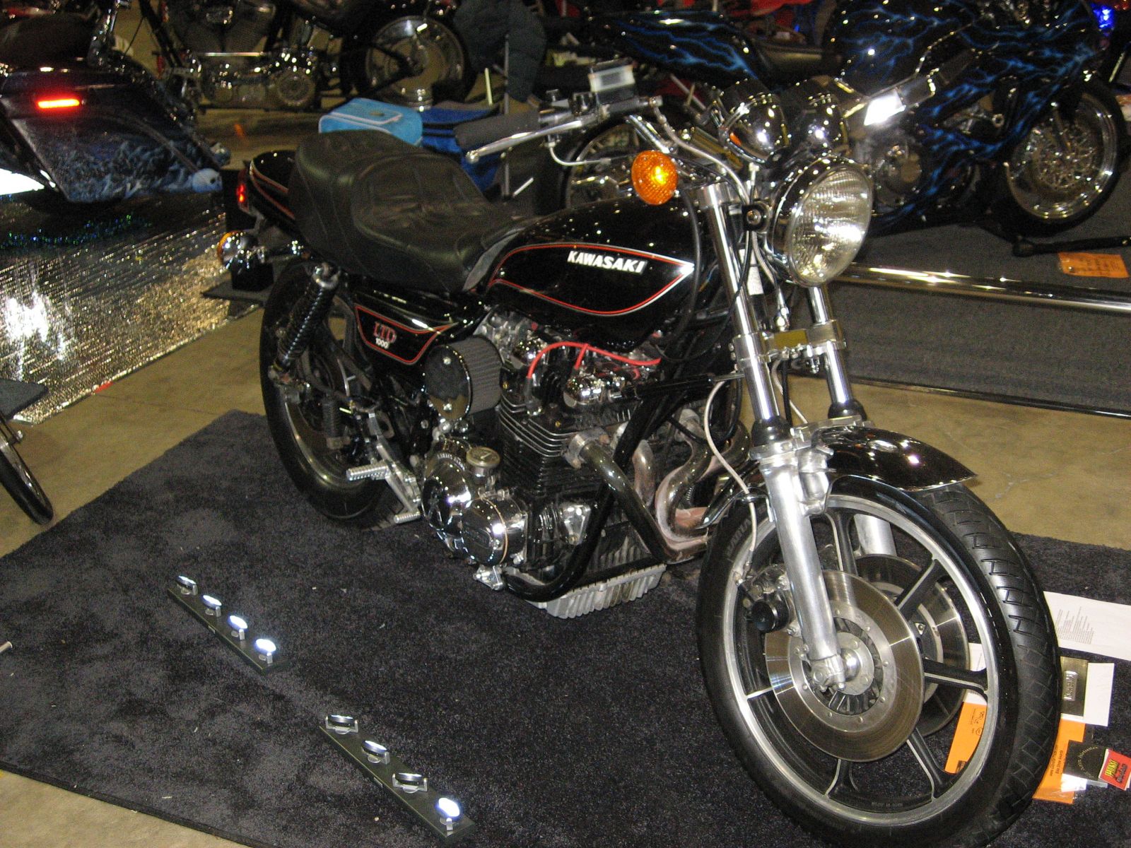

Les Holt made these for me.
He is a member here . A good friend and excellent machinist
Attachment gshow2014002.jpg not found
Lots of folks here on KZR have these
Hope this helps
Dave B) B) B)
