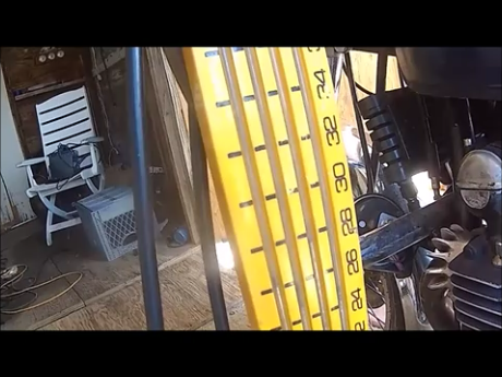

How would one clean the crap out of the mercury? In 90 I was low on it so I got some from a friend. It had been used to clean silver but it has some black crap in it.

Checked the plugs. Much cleaner but #3 was leaner than the others still. Decided to put in the next size larger main jets. Still looking for that peanut butter color.
