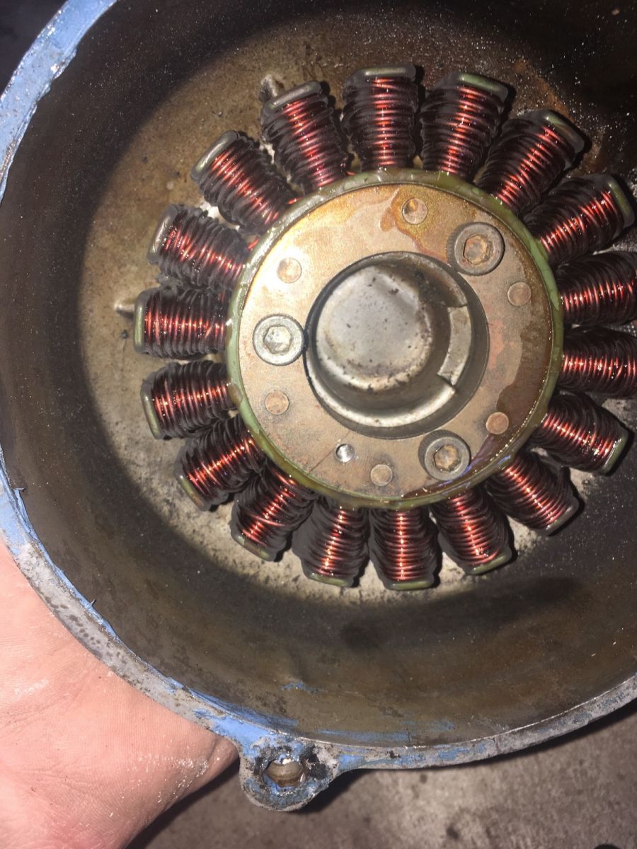

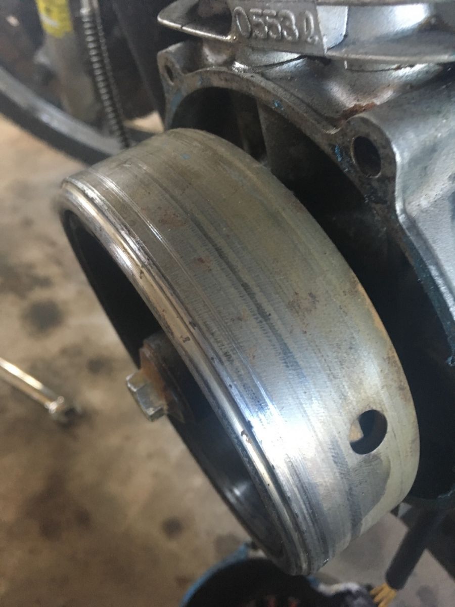

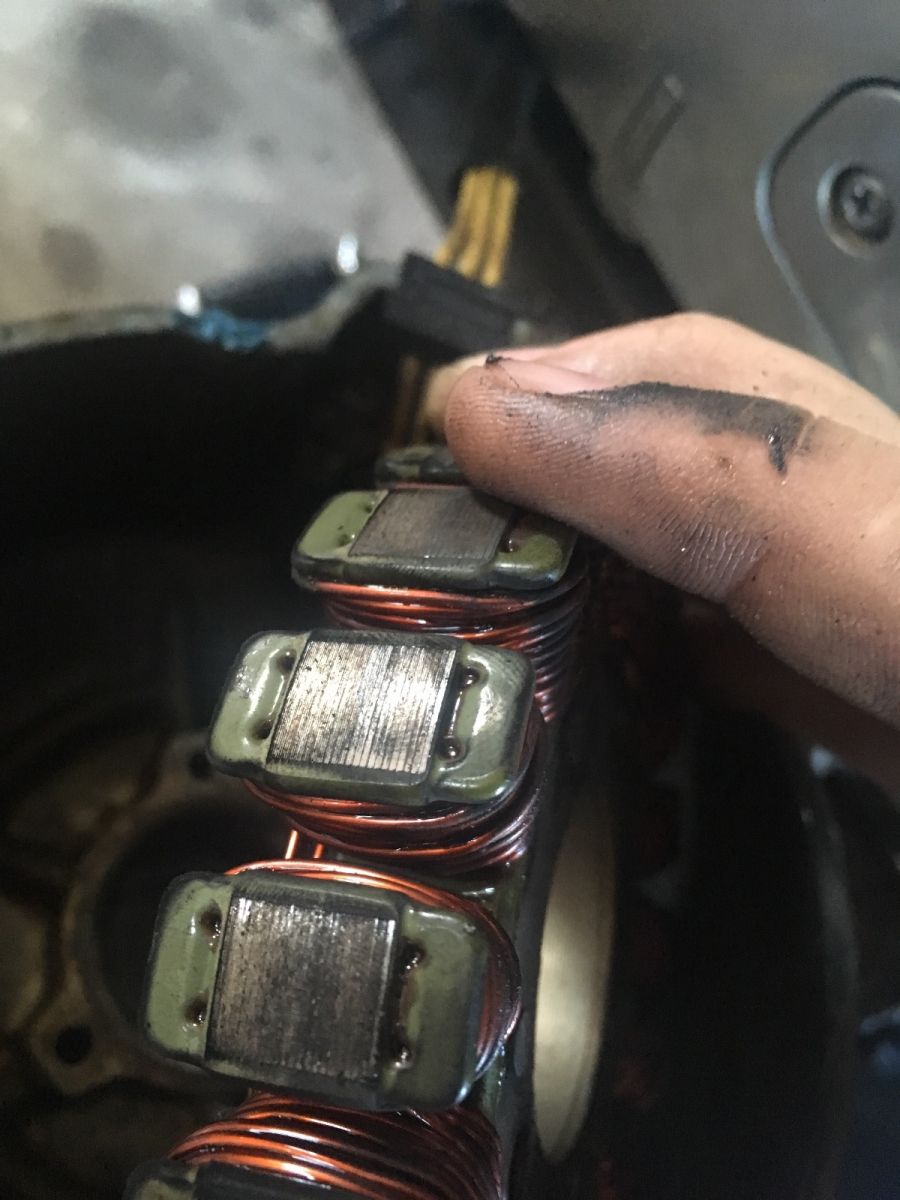

I took these pictures, I unscrewed the stator and screwed it back just to be safe. And there did seem to be some metal dust that gathered in there. Once I put it back together, the noise went away. I’m gonna Ride it around the next couple days and see if it comes back.

Did you make sure the rotor was tight and no loose crap in there? Looks like it was rubbing on something.
