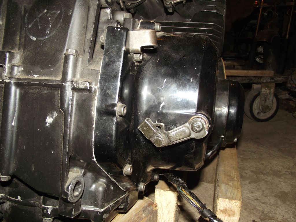

so the story's continued
bought a gpz 750 complete engine for $500
a meeting nose to nose
i1175.photobucket.com/albums/r638/Surt_R...htrider/DSCF0107.jpg
close up
i1175.photobucket.com/albums/r638/Surt_R...htrider/DSCF0108.jpg
i1175.photobucket.com/albums/r638/Surt_R...htrider/DSCF0109.jpg
close up

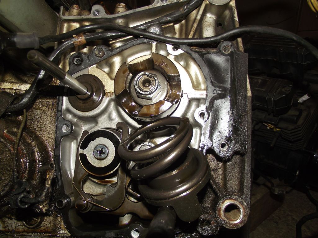

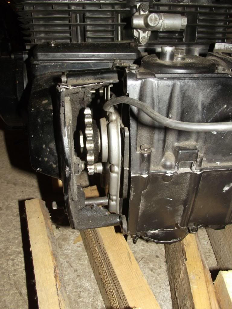

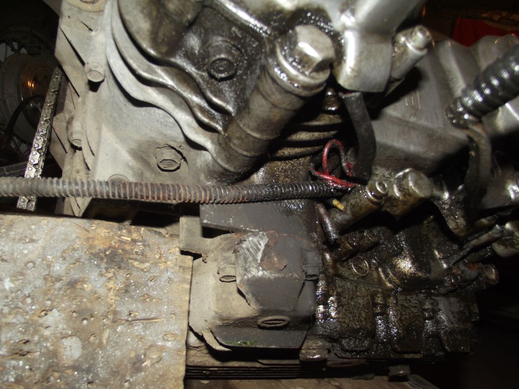

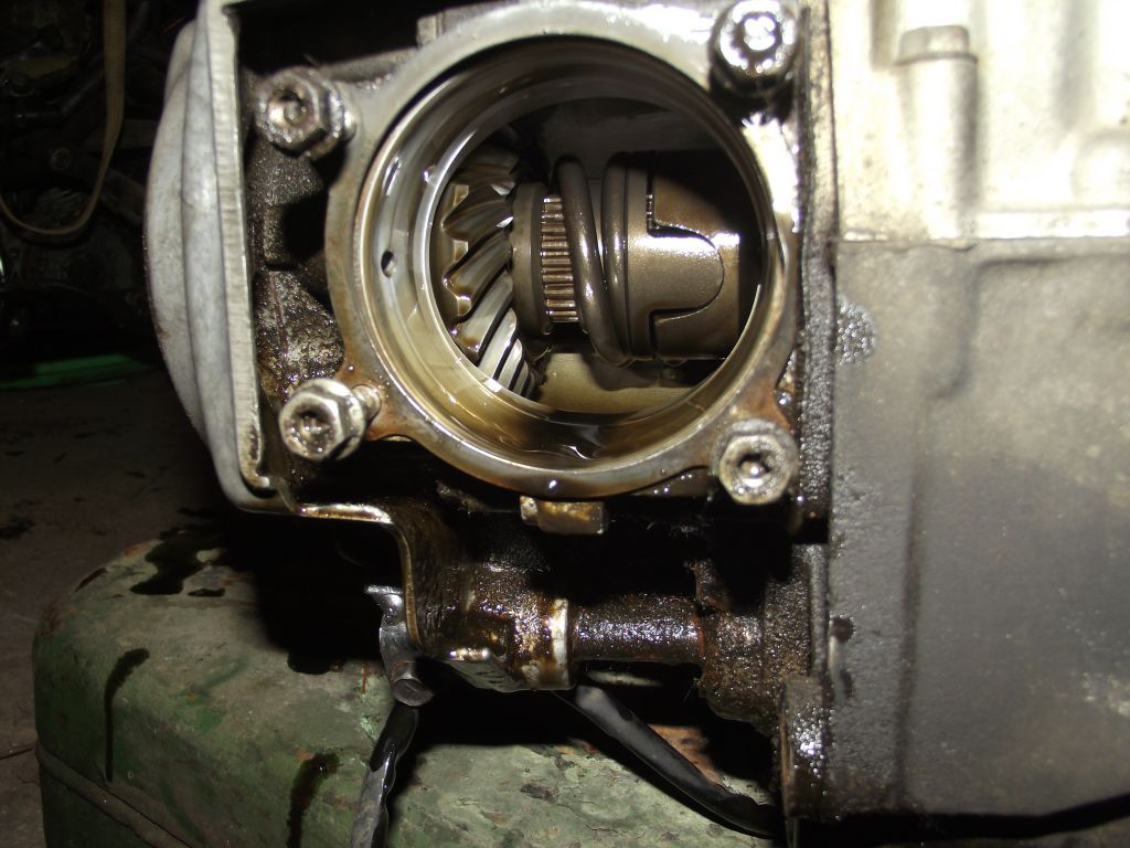

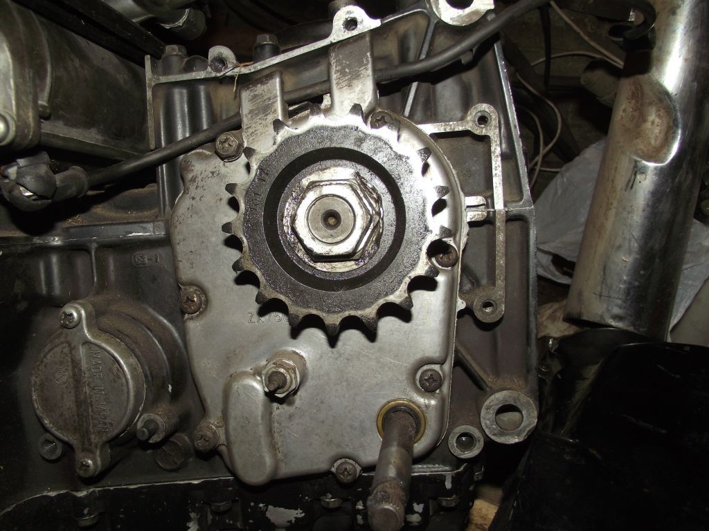

find 10 distinctions
1. clutch actuators r different and on different sides
i1175.photobucket.com/albums/r638/Surt_R...htrider/DSCF0113.jpg
i1175.photobucket.com/albums/r638/Surt_R...htrider/DSCF0114.jpg
2 naturally different left covers,
lets see under them
shafty
i1175.photobucket.com/albums/r638/Surt_R...htrider/DSCF0121.jpg
chainy
i1175.photobucket.com/albums/r638/Surt_R...htrider/DSCF0122.jpg
but both r having the same set of threaded m6 holes! so u dont have to swap casesfor the chain conversion
