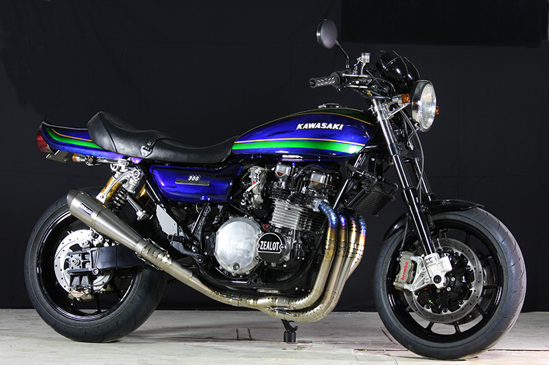

Anyone have any knowledge on this macheen :woohoo:
