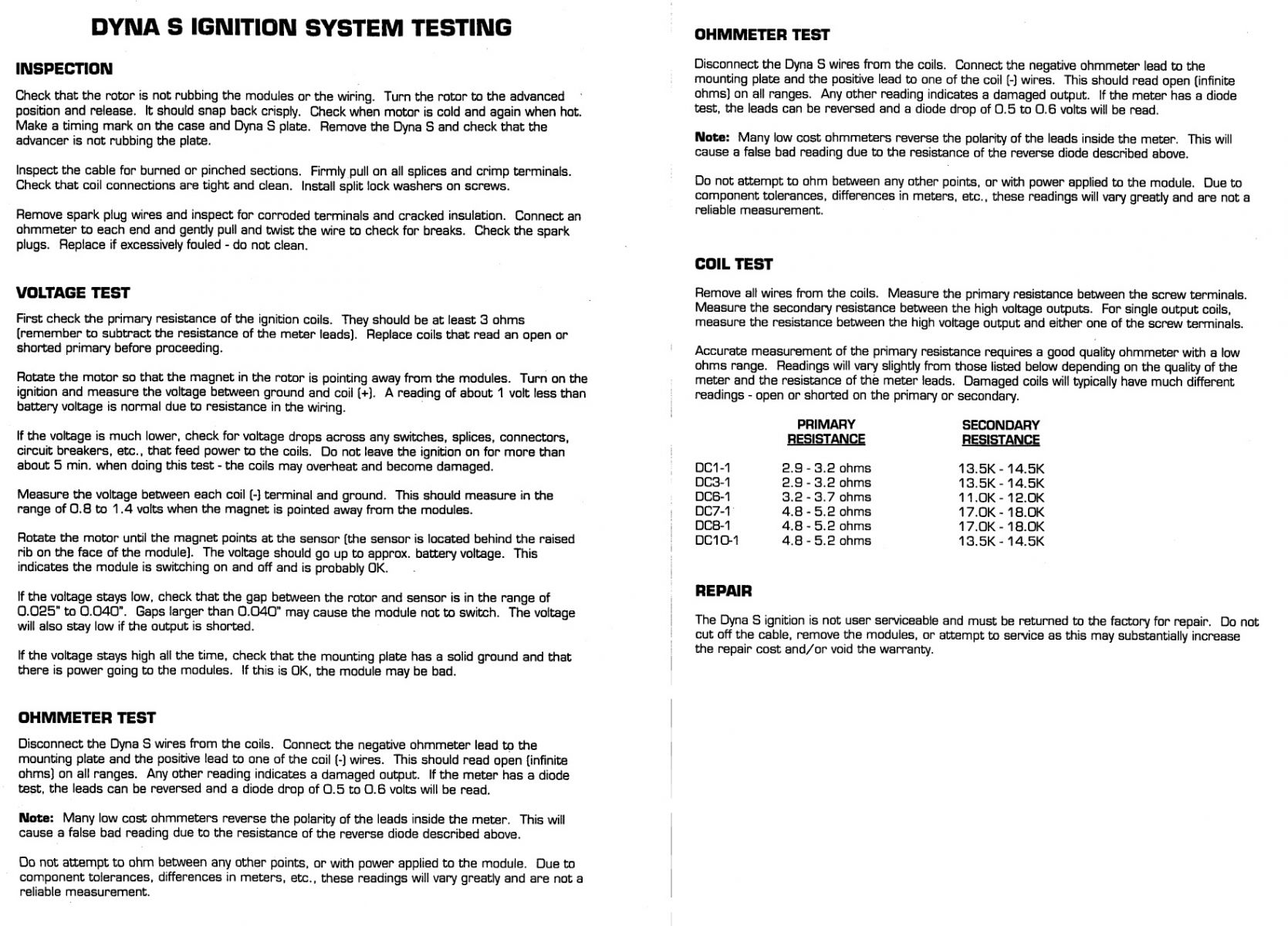

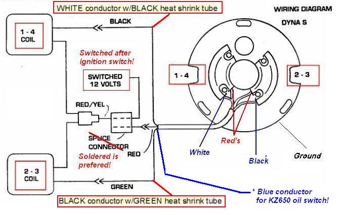

@ 40 miles then dies.... Battery not being charged during running operations....
Check charging circuit/feeds back to battery.
Also verify rectifier/regulator is ideally grounded.....
If to frame, then confirm frame is grounded or relocate the R/R ground wire to battery (-) terminal.
Had this happen on a Suzuki 30 years ago I rebuilt.... Frame paint on ground terminal...DOH! :pinch:
