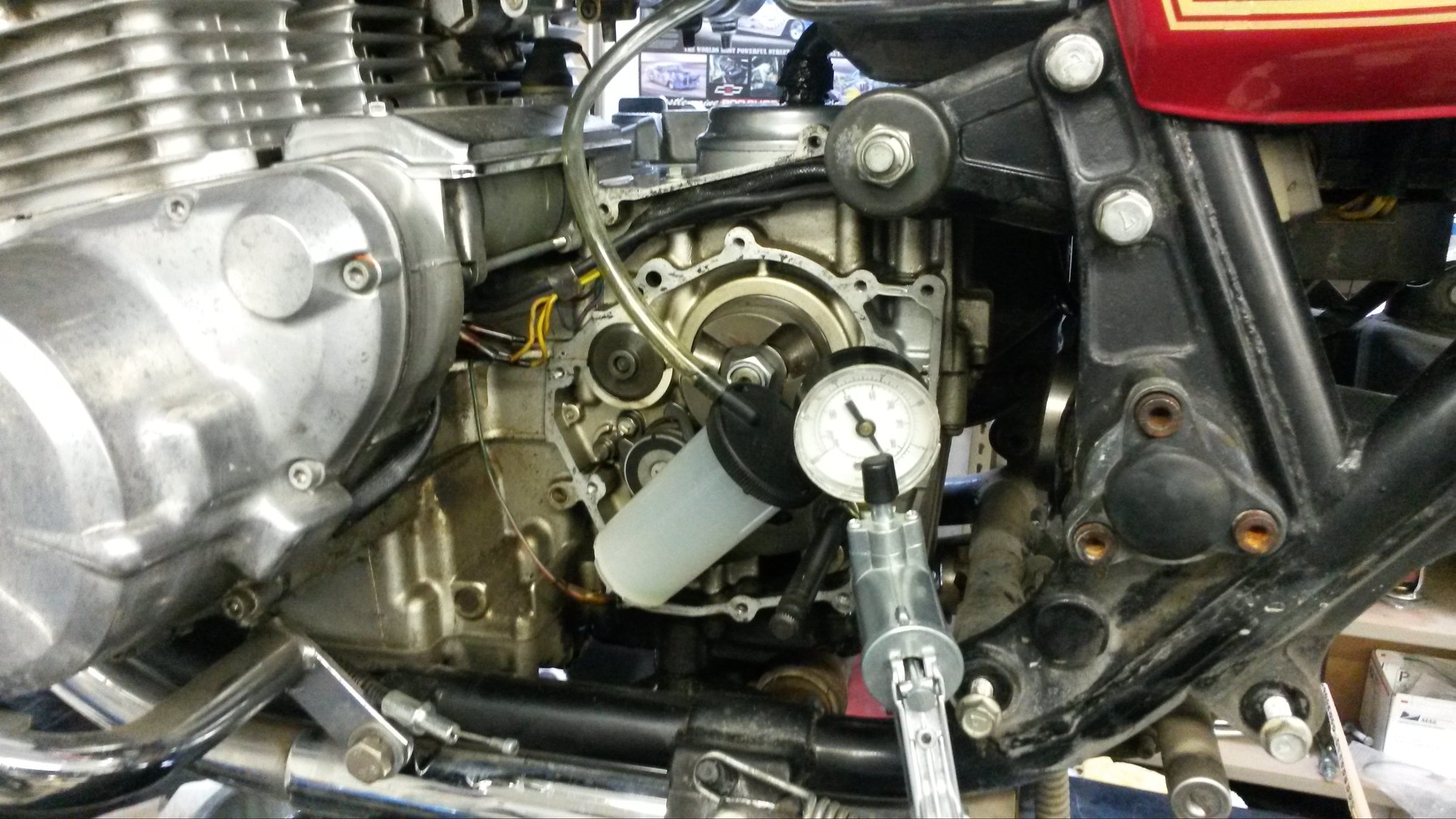

Ok here's what I did I put my vacuum gun on the vacuum port on the valve. I had just a trickle of gas come out the vacuum port but I have the oil drain plug still out and gas flowed from there and even had gas leaking into the airbox I believe its coming from the outside carbs. I took the airbox boots to carbs off and am going to put vacuum on it again and see for sure which carb or carbs are leaking.
with as much gas that is coming out I can't believe it even ran.
And I'm sure I burnt the clutch up cause I'm stupid and kept riding.
