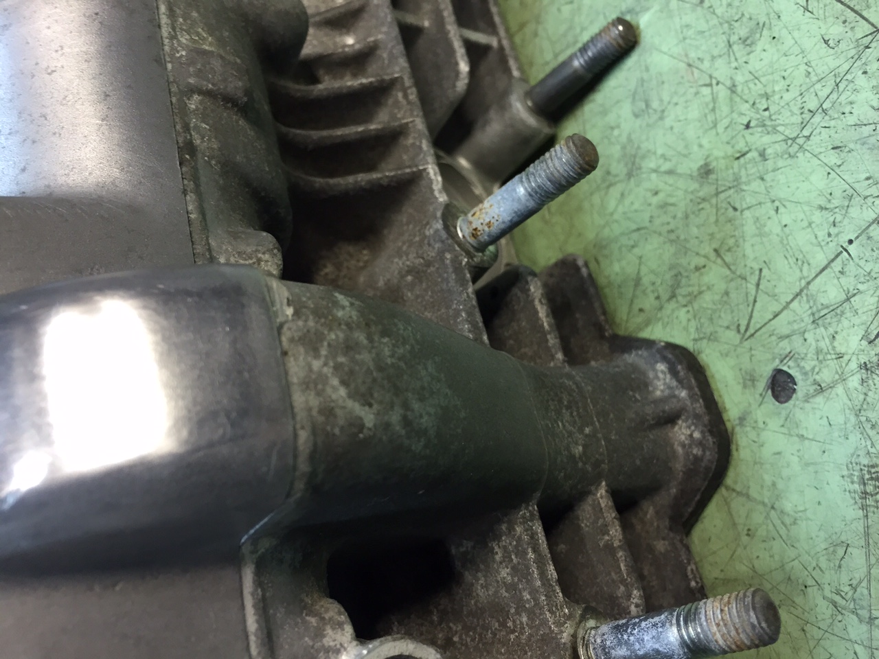

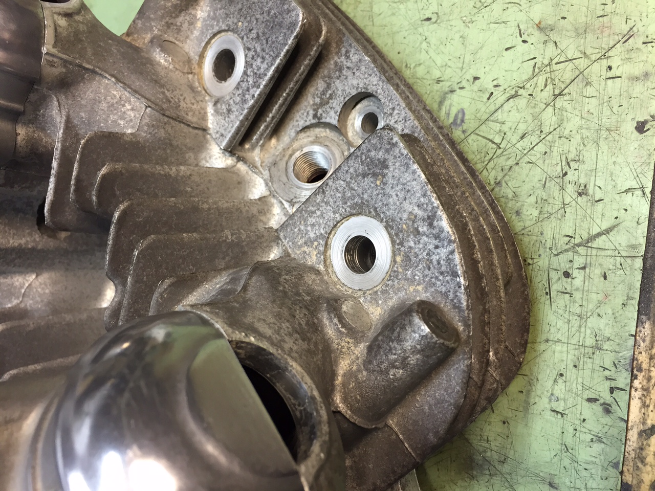

16 Jun 2015 14:49So I have taken the head to three different shops for a quote on blasting this crap off the head.missionkz wrote: OK what can I do to clean this up after having it redone...
They claim they boiled it and blasted the ports et al.... to me it looks like they only blasted off the areas around the ports and nothing else.
I have a small soda blaster but my 3HP compressor can't really deliver a large enough CFM at any real high pressure.
Maybe no more then then 50-60psi at 6-7 cfm, which just doesn't really cut it. OK for carb and small parts but not this.
I'm tempted to paint the cylinder and head a satin black and move on.
I hesitate a bit on painting because the cases are not painted and don't want it to look like a half ass'd Z1 since it isn't a Z1 but a KZ1000.
Opinions
Attachment head1.jpg not found
One guy said it would take his laborer about 2 hours and $50.00 to $75.00, if I gut the head and seal up all the ports (etc.). Another one said it would be a 3 hour job at $60.00/hr and the third guy said "soda blasting will never cut the crud" and I need to have it vapor blasted with his equipment and said it would be at least $300.00 F'n dollars!!!

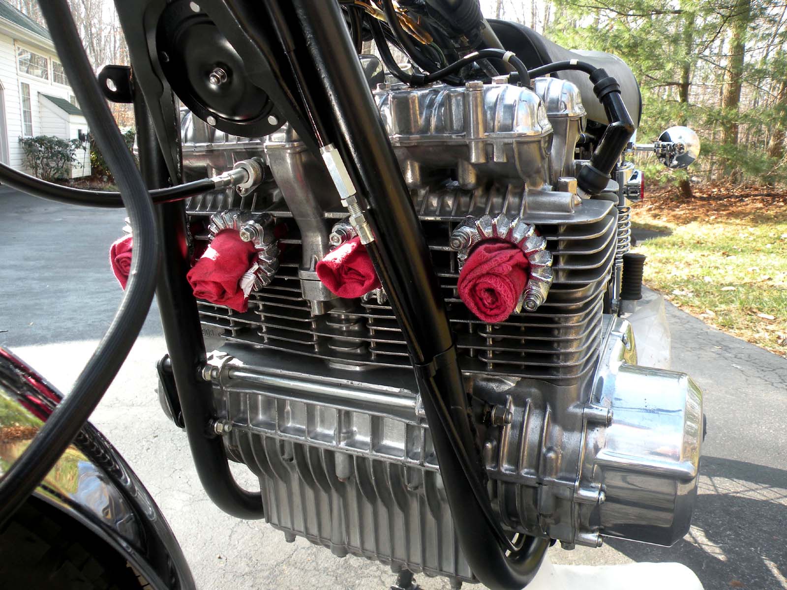

Try a Nyalox wheel brush made by Dico.
dicoproducts.com/nyalox.html
Most hardware/home improvement stores carry them. I normally use the Blue (240/fine), but you may need to start with the Orange (120/medium). The 4' wheel gets in between most fins. They make 4 or 5 different styles that will get into most other areas. As you use them. you'll notice the brush will turn black with build-up and the surface finish will start to dull. Spray the brush with brake cleaner and dry with towel to restore. They actually give a slight sheen closer to vapor blasting. You're going to spend a few hours, but the results will be worth it.
Here's a before / after picture of a Z1B engine I did using Nyalox brushes.

17 Jun 2015 11:48 - 17 Jun 2015 11:51MDZ1rider wrote: Try a Nyalox wheel brush made by Dico.
Wow that is impressive. looks like it polished it a bit as well. Did you remove the engine from the frame? I have a 750 twin engine i don't want to break down that i was going to soda blast then polish. i may just try one of these wheels you speak of. Nice work.

Hey MDZ that looks pretty sharp ...... I've seen these at farm and Fleet and almost picked up one......... My oil pan and case could use a little shining up and have the engine on the bench .......might pick up a 2 and a half inch blue cup and give it a try ..... will a cordless drill spin it fast enough and did you use polishing compound on it or just run it dry ?
Will probably leave the head alone and my block is painted black so like I said mainly the case. Thanks.

I don't want to mislead everyone into thinking the Nyaloc brushes are."instant shine" You're going to spend some time with a drill. The open areas clean up quickly. Getting in all the nooks and crannies is what eats up the time. I've done it a few times and developed my technique. I'd estimate 2 hours. on head, which are the worst IMO. Your first try may be a little slower until you get the feel.
I used a variety of techniques on that engine. The engine was completely disassembled. Parts like the covers and camshaft cover ends where polished on a buffing wheel. I started with paint stripper on the cases, cylinder and head, then used the Nyaloc brushes for the finish you see.. The nice part is there no media to worry about like there is with any type of blasting. You can also get very aggressive with the speed/pressure without harming the metal.
The engine really needs to be out of the frame. You'll need room for your drill and access from all angles to get everywhere..
I've used a cordless drill, but the higher rpms of an A/C cord drill works better. The cordless just takes more time..
