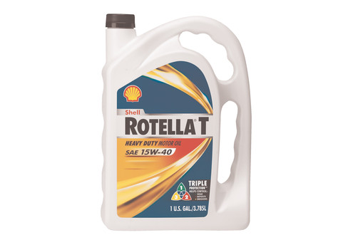

    Want cheap but good synthetic blend?
Buy a gallon of dino Rotella at Wallyland and dump in a quart of synthetic oil. Most "synthetic blends" are less than 30% synthetic.

    i am looking at a big jug of rotella right now to swap in there tomorrow... and it will not be in there for more than 2000 or so miles
my old ..way old motor still runs fine....it's no race mill or wheel lifter....but no dnf's ever either
should i switch to better oil..rotella T now..oh btw wally and 15 bucks was all
serious now...am i using good enough/good oil

    Yes, rotella is good enough.  I have never seen a negative post about it.

    The only negative is it's a 15w oil and does not work in winter. Then Rotella has the 5w40 T6 synthetic that is a 5w and is no good. They make the 10w30 T5 which is fine but not right for a KZ, make 10w40 T5 which is perfecto, but you can't buy it anywhere. Well might as well just go on and buy motorcycle spec oil as diesel oil is not going to fiit.
