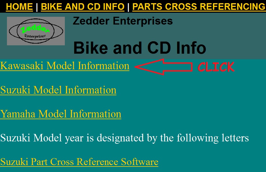

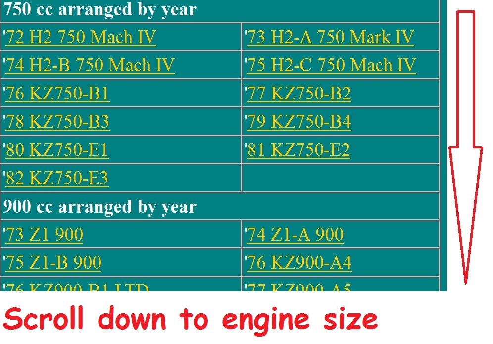

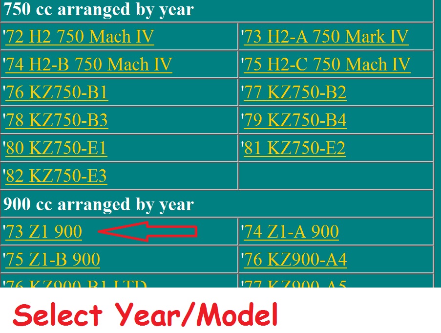

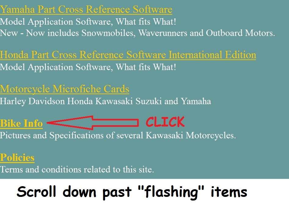

Might giver zedder.com a try.

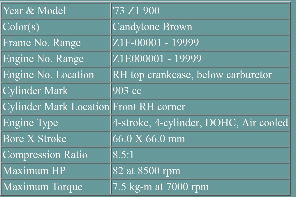

call chris at Z1 enterprises. ext 117 he has a Kaw book on engine numbers. Mark II numbers are in your range. It looks like you have a 1980 A4 MkII.
